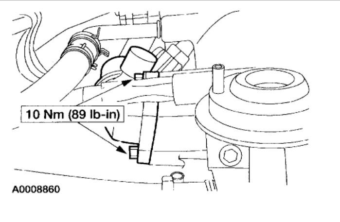

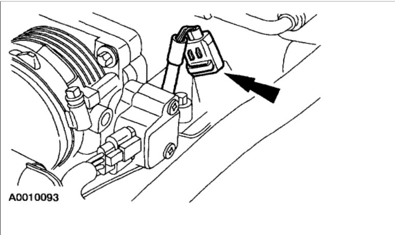

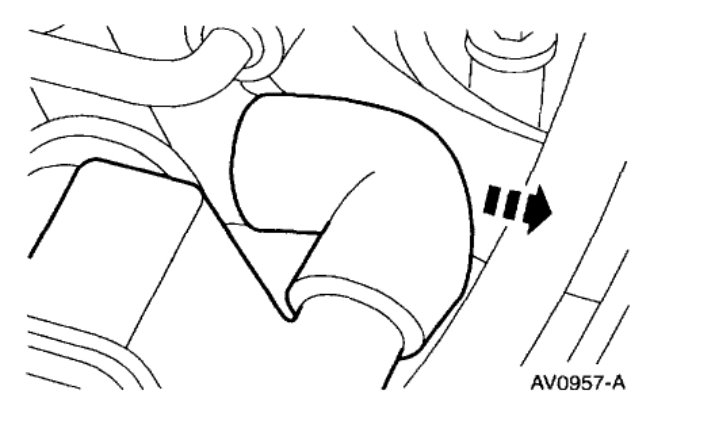

Have a weird issue that has been going on for over a year. My car makes a sound like a tuba randomly. I never know when it is going to happen it just does. Sometimes I can get it to stop by revving the engine and sometimes I have to shut the car off to make it stop. It happens when it is cold out, warm out, in park , in drive, first thing in the morning or in the afternoon. Sometimes it does not happen for weeks then starts up again. I have tried cleaning the IAC and it still happens. Help!
Oct 23, 2017 at 11:33 AM
  • 55,594 POSTS
You are on the right track, but you cant clean the IAC you must replace it. The honking is caused by broken parts inside the IAC.
Here is a guide to help you get it fixed.
https://www.2carpros.com/articles/how-to-replace-an-idle-speed-control-motor-iac
Here is your car (below)
