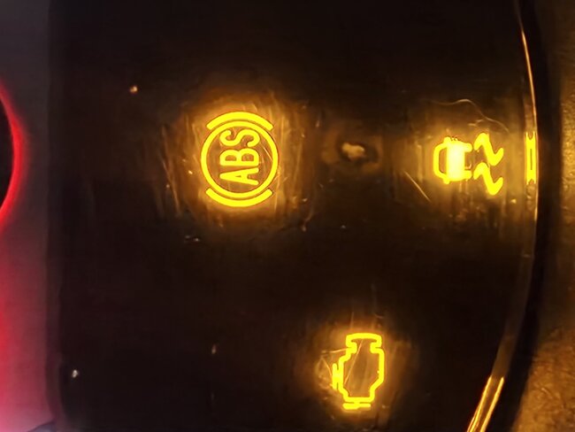

How to reset the TSL and ABS light?
2013 CHRYSLER 200
172,648 MILES • 3.6L • 6 CYL • 2WD • AUTOMATIC
KILOZETA

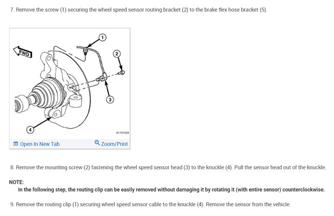

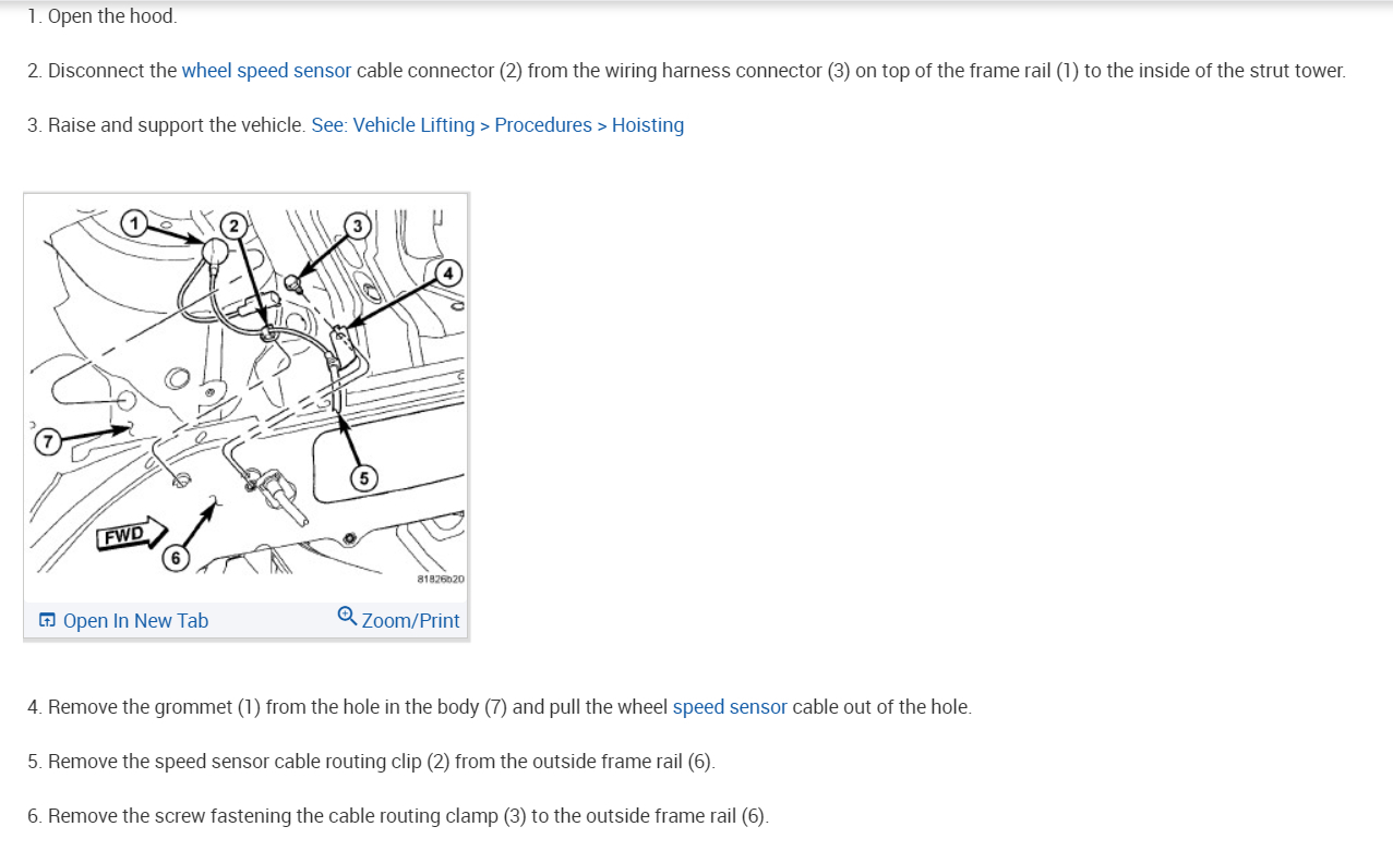

Got stuck on ice and triggered both lights but can't figure out how to reset the computer without needing to get an OBD2 scanner. The engine light is perpetually on due to gas cap issues.
Nov 20, 2022 at 12:41 PM
KILOZETA
Nov 20, 2022 at 12:43 PM
  • 55,456 POSTS

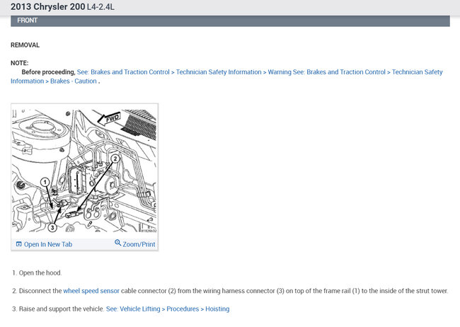

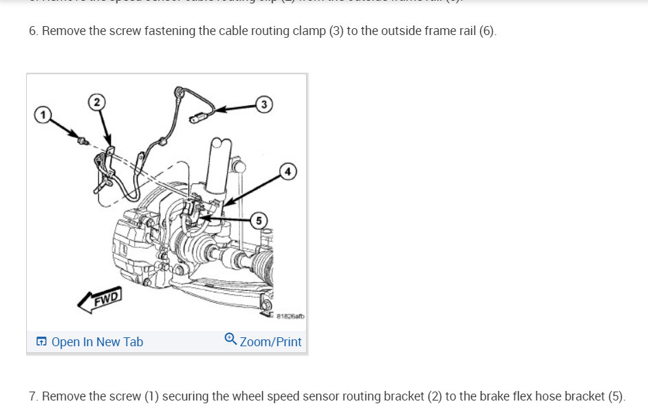

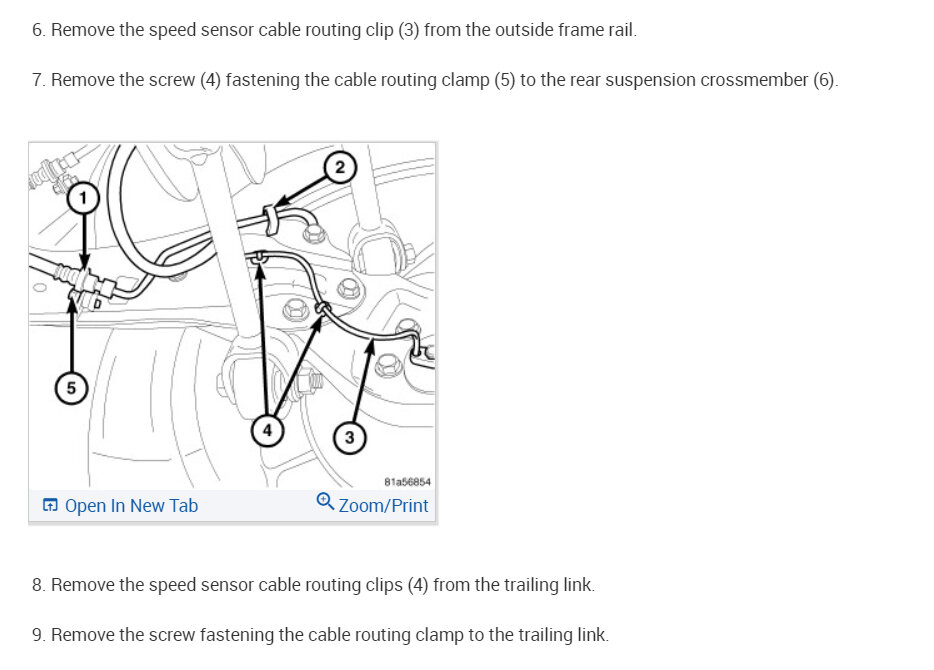

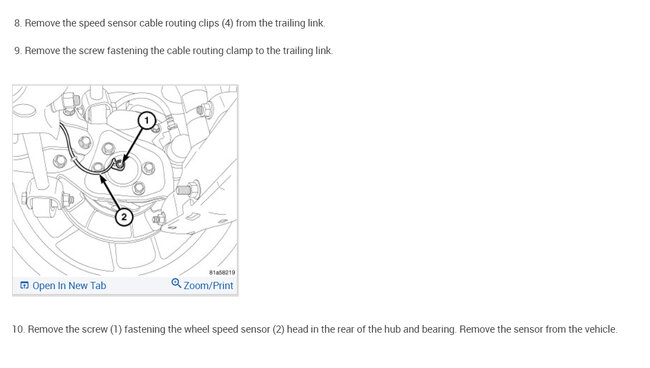

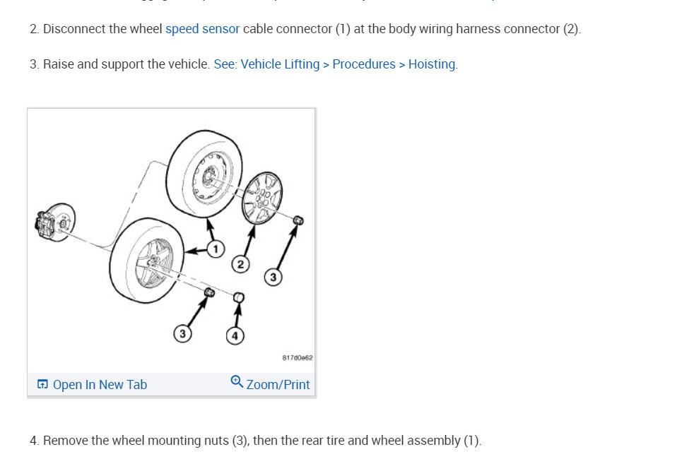

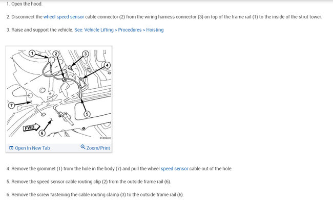

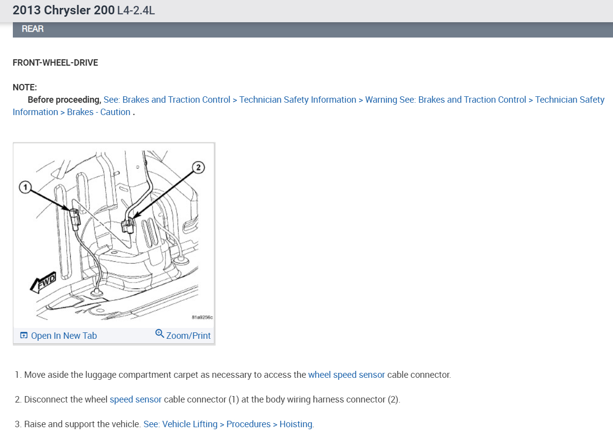

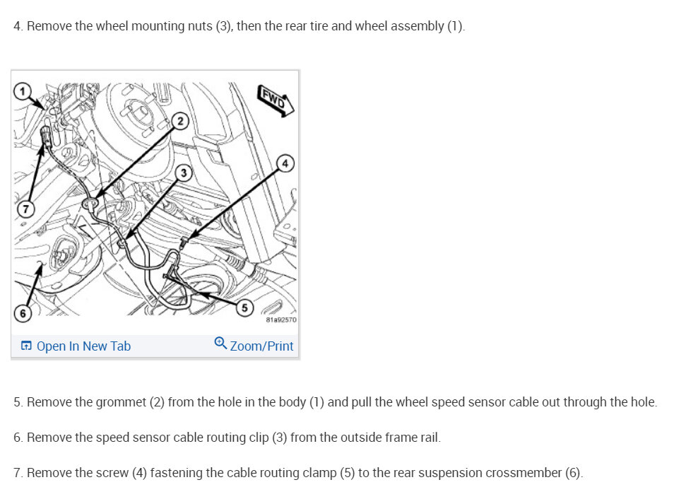

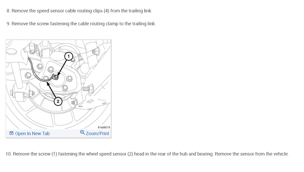

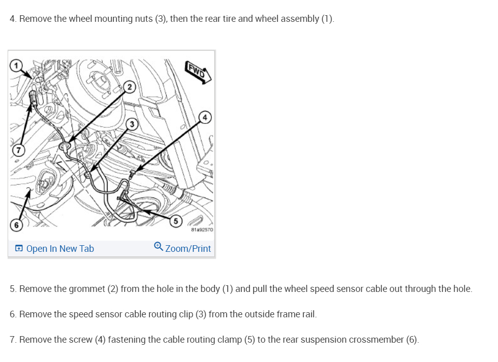

This happens when one of the wheel speed sensors goes out but to be sure we need to scan the ABS system which will tell us which one out of the four is not working. Here is a guide that will help walk you through the procedure and I have included how to change the sensor out in the images below:
https://www.2carpros.com/articles/anti-lock-system-testing-and-repair-abs
Check out the images (below). Please let us know what you find. We are interested to see what it is.
