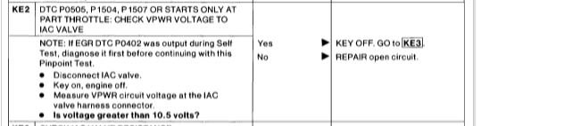

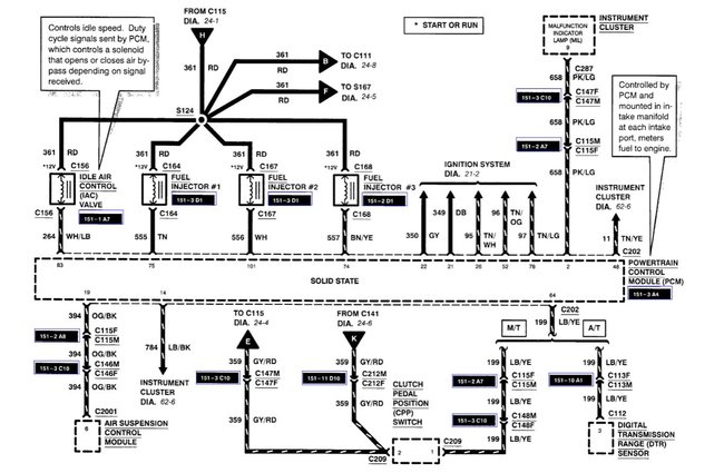

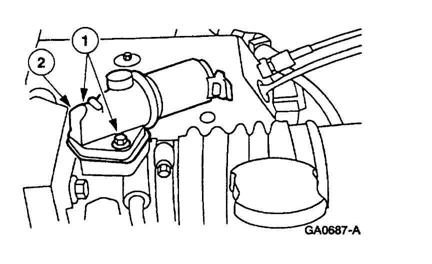

The code P1504 is for the Idle Air Control Valve and could be directly related to your issue. I have seen where these valves can get gummed up and stuck. Try cleaning it out some carburetor cleaner, the follow the pinpoint tests that I have attached. I also attached a picture of the valve. it is located right where the intake rubber boot connects to the throttle body.

I did clean the valve with a cleaner and also applied vacuum and the poppet valve moved. The voltage was greater than 10.5 volts. actually 12 volts. I also checked the resistance at the pin 10.5 ohms.
The code has now cleared but the fuel pressure is still maxed at 65psi. The fuel trims are negative which indicates a rich condition. Again, can the high pressure cause the engine to stall?

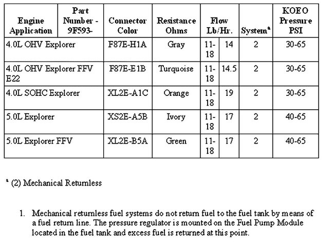

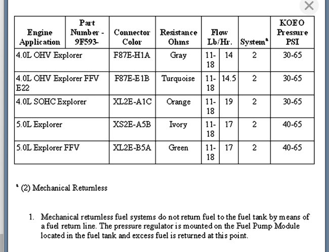

Fuel pressure with key on engine off is 30-65PSI. So, your fuel pressure is within spec. Another possibility is that the torque converter clutch is stuck engaged. Is there enough transmission fluid? Any transmission codes?

Clarification - the 65 PSI fuel pressure was measured while the engine was at idle. Shouldn't the pressure drop at idle and increase as the throttle is wide open? the vacuum damper/regulator at the back of the engine has no impact on the fuel pressure whether i have its vacuum hose connected or disconnected. No change in fuel pressure. When i applied an external vacuum to the regulator with 16 inches of vacuum no change in fuel pressure. It still remained at 65 PSI. Could the regulator be stuck open?
Again, with the key on ignition off the fuel pressure was 60 PSI (yes, based on what you provided it is within range) however, when the engine is running as idled it was 65 PSI and when it revved to 3,500 RPMs it was still 65 PSI.

However, if you have 60-65 PSI then that is barely within spec but that is at the top end. So just because it is within spec, doesn't mean it is not the issue.
You have a return less system which means it just doesn't send the fuel to the rail and then return it. The pump has a return circuit, so it really never leaves the tank except for what is needed.
Due to this sitting so long, I suspect your regulator that is mounted on the tank is clogged as well. You can try and run a high concentration of seafoam through it and see if that pressure comes down but that will cause some issues.

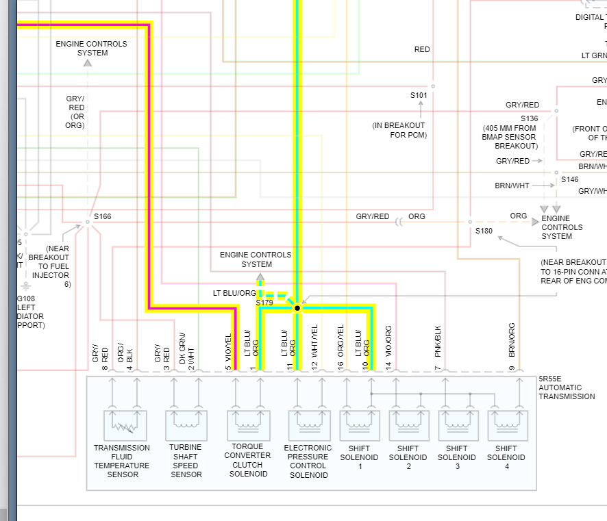

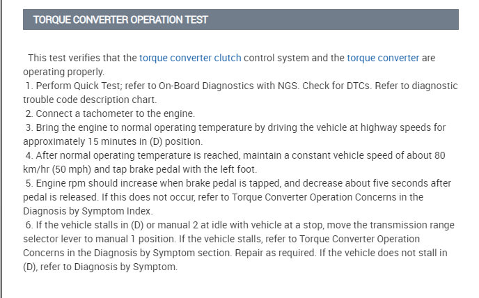

Sorry for the delay. I started the car in neutral and then placed in Drive... The tires (all four) turn and accelerate from 20 to 45 MPH.
If it is caused by a locked torque converter, can I deactivate it via the torque solenoid (i read about it as a possible cause)
If I drop the transmission pan. If the solenoid was stuck if it were removed and left out will that unstick the torque converter. or is the only choice to drop the transmission and replace the torque converter. I just want to use this car to push snow on my driveway. No use on any public road. I am not looking to get great gas mileage or direct drive from the engine to rear.
Thank you again for all your help.
Nov 29, 2021 at 9:06 AM

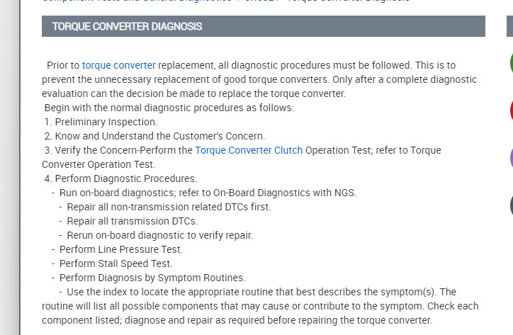

Okay. That does point to a torque converter issue if it is not stalling when there is no load on the tires.
However, that just means we need to go a little further to confirm it.
I attached the testing that you will need to follow to confirm it.
To answer your questions, you are not able to disable the torque converter without it not only affecting the other solenoids and the overall operation of the transmission.
Please see the attached for this detail. I understand you are trying to just get this running but unfortunately the torque converter operation is not something that I see a way to do without.
