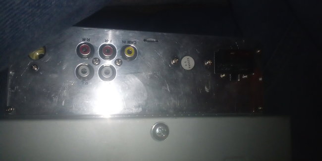

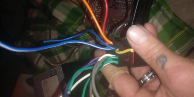

Receiver #XVM286BTI. finally got a wire harness for my car... I've attached pics of my original stereo and the aftermarket radio in Trying to install....
I got it hooked up but the only way in getting sound is through the audio jack's on the back and it's horrible not correct, lol... Umm could you please help me? Thank you for your time.

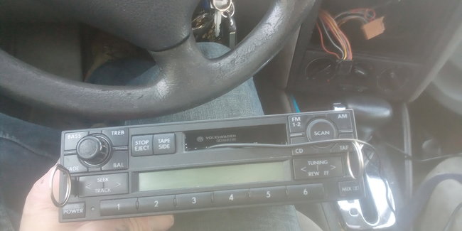

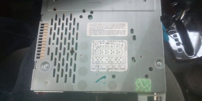

Here is the original stereo and wiring:

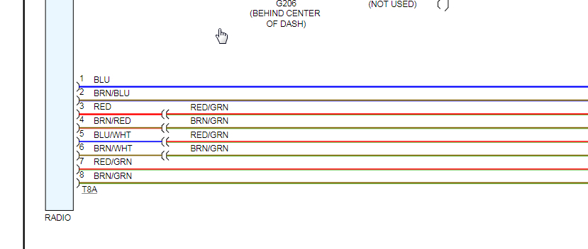

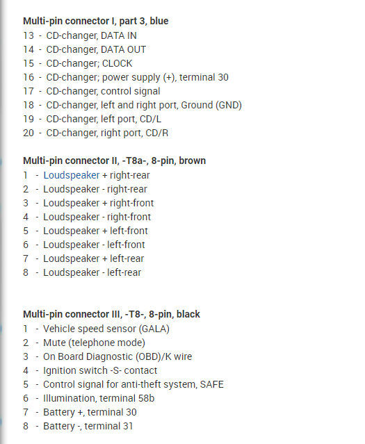

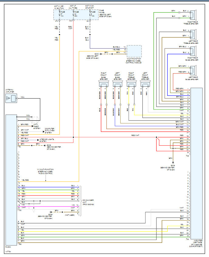

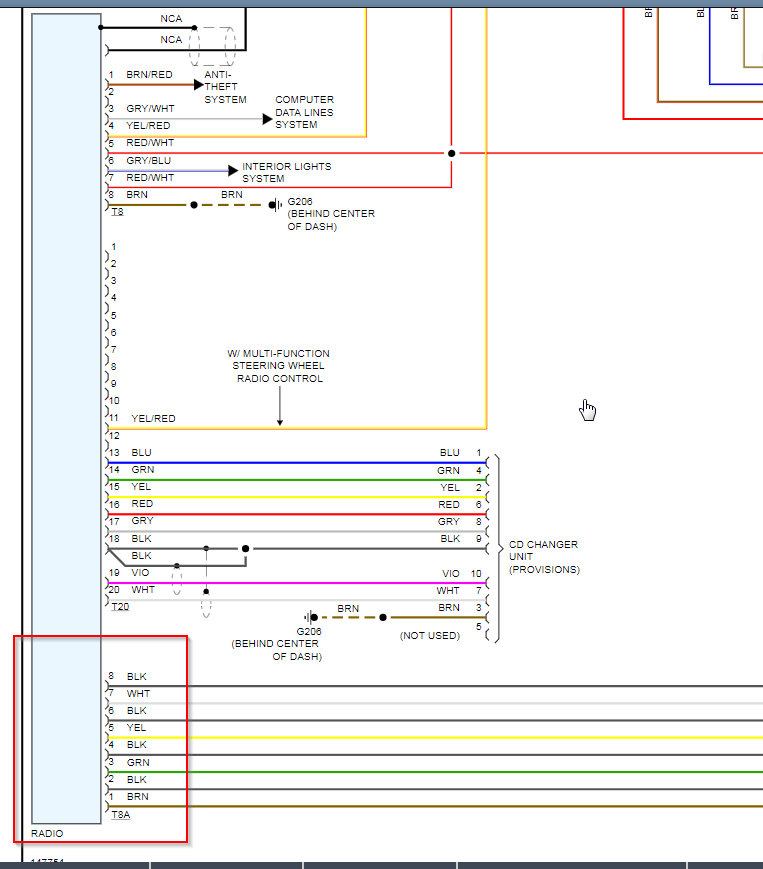

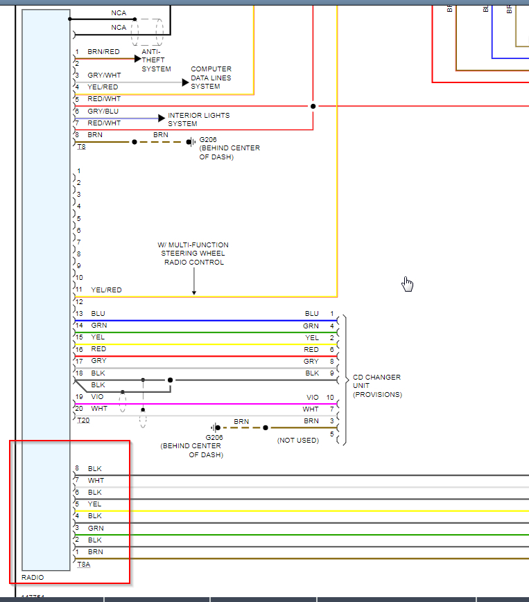

I totally understand the frustration. I provided the wiring for your vehicle below. However, the issue we are having is knowing the wiring for their unit so that we can match these up as I suspect they have a wire to the amp in a different location. So the wiring circled is what we need to match up as this goes to the amp.
The reason you are not able to post the documents is the format. They limit what we can post due to compatibility on the internet. Easiest thing to do is just take a picture of it with your phone and post it.

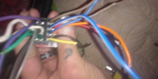

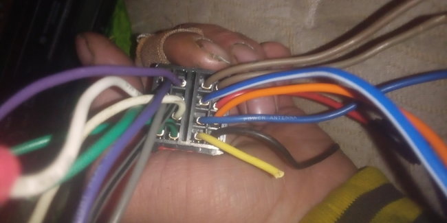

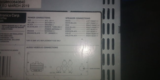

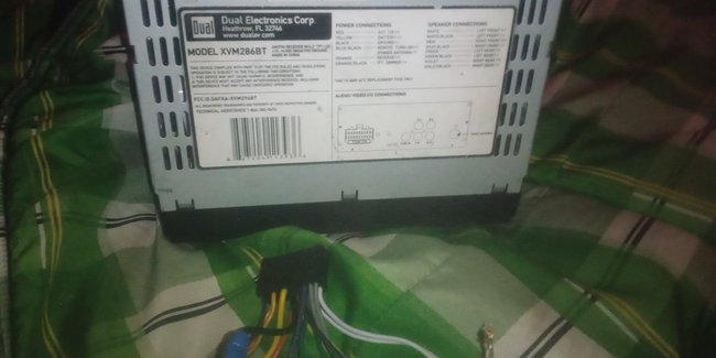

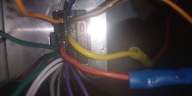

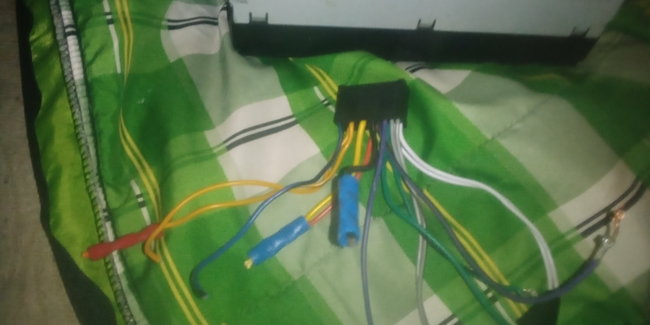

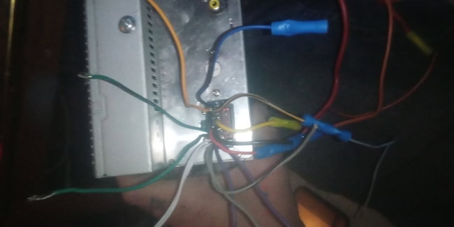

Thank you for your time sir.. I've attached a few pics I think this might help it's the plug plugged into my new unit that I'm supposed to wire into my plug adapter for my car. That's the back of my new unit with the plug in it already seen them the picture of the unit with the wiring on it.
Nov 23, 2020 at 9:10 PM
Okay. That last picture is what I needed. One more question about your vehicle. Does it have an amp from the factory or no amp? That will tell me what system you have and then we can figure out what wire goes to which wire.
FYI - You are going to have to cut your connectors off the vehicle harness and connect those wires to the wires on the new radio.
Nov 24, 2020 at 6:13 PM

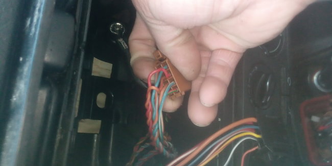

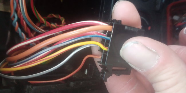

As far as I know no there is no AMP It's the non Monsoon system. It did have a CD player in the driver's rear but someone took it out.
Nov 24, 2020 at 9:48 PM
MOUSE357
  • 58 POSTS
This is the original stereo and wiring for it. The black plug is the main wires,
the brown plug is the speakers..
Nov 24, 2020 at 9:52 PM

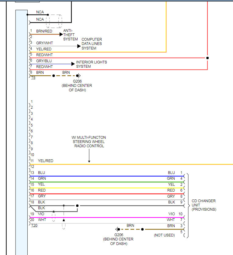

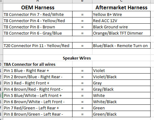

Okay. That is great. It makes this easier. So here are the wires that we need to connect. I thought I might draw a diagram but I think it will be more clear if I just spell it out and then provide the wiring diagrams so you can see it.
Take a look at the first attachment. OEM wires are on the left. Aftermarket wires are on the right.
Again, don't worry about trying to use connectors. Just strip each wire and solder and shrink wrap them to each other. The last attachments show the connector colors but here they are as well for the OEM connectors so you can find each of these wires.
T8 is a black connector
T8a is a Brown connector
T20 is a Green connector
The only other one is the antenna wire that is a shielded wire that should just plug into the new radio. It should have a connector that looks like a duck bill.
Hopefully this all makes sense.
