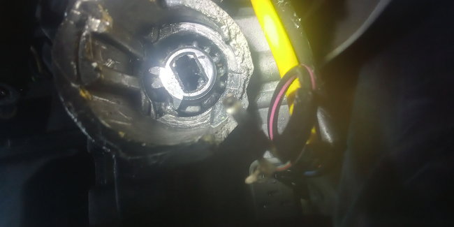

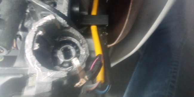

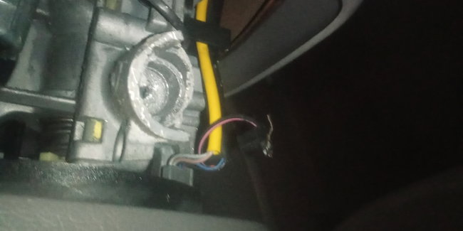

Unfortunately, I had someone destroy my steering column on my car listed above GS. I'm having the problem of getting it back together. I don't know where this wire goes. I've attached photos below. It's the (black/pink wire). If someone could help me with this please. Thank you for your time.

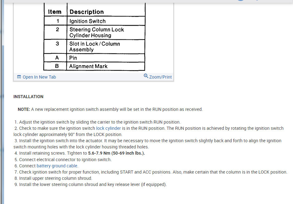

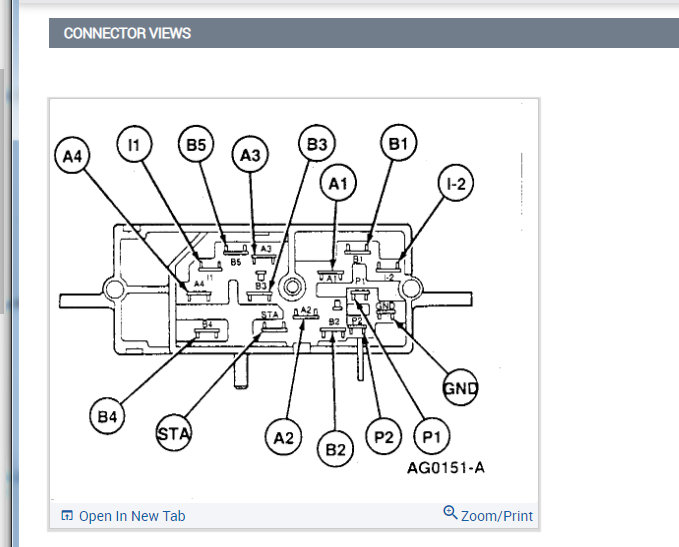

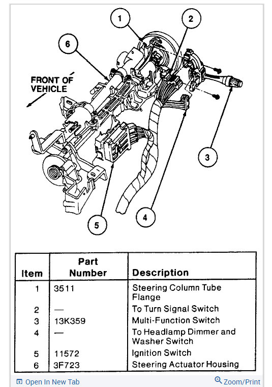

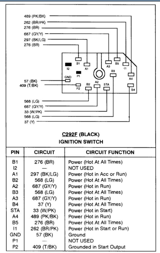

Looks like that goes in the A4 cavity of the switch connector. Take a look at this info attached below for more detail.

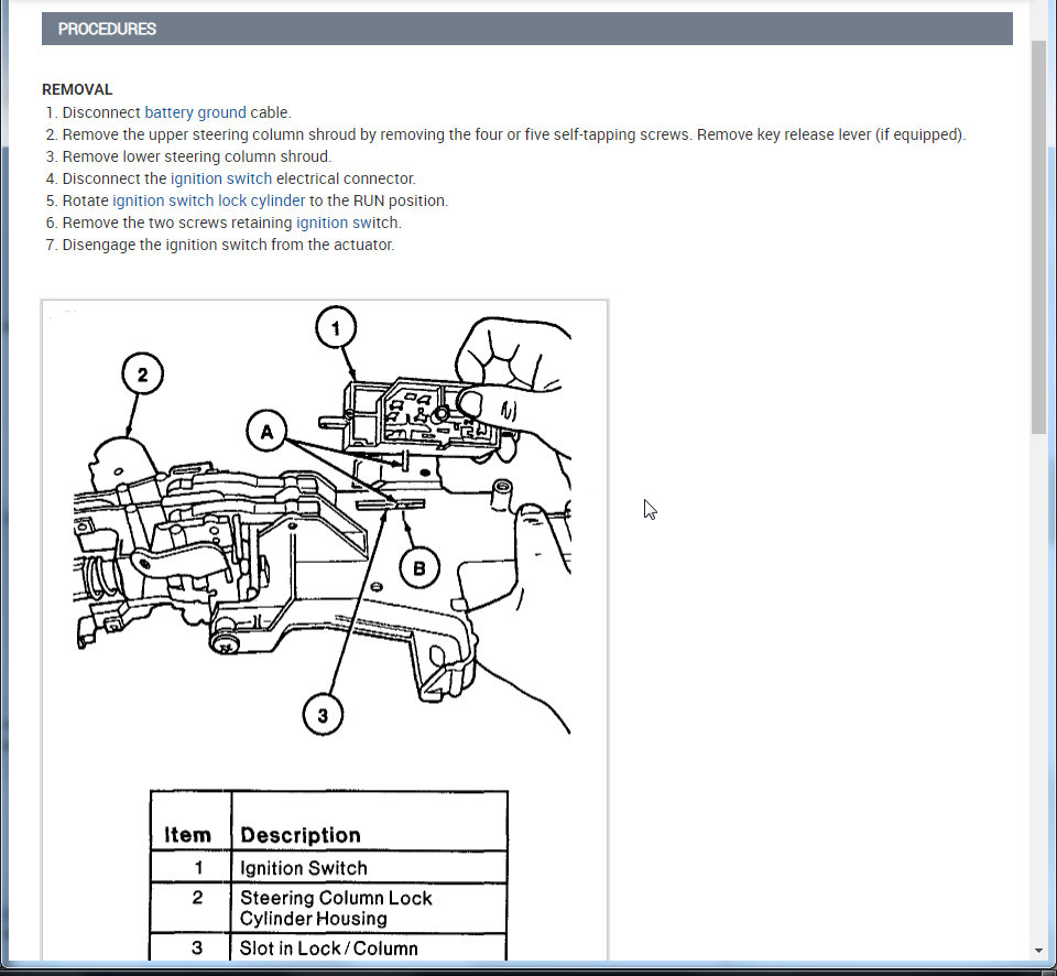

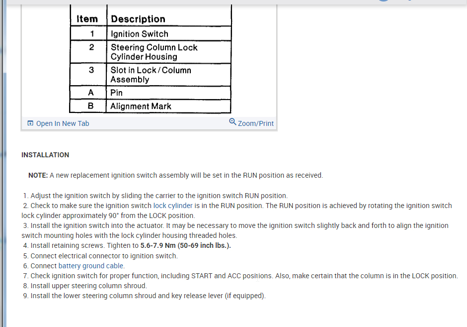

I included the process to replace the switch and the wiring info for your review.
Take a look at this and let us know how you make out. Thanks
