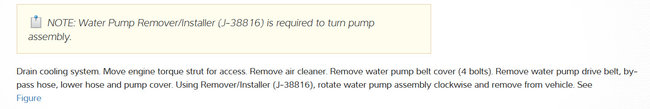

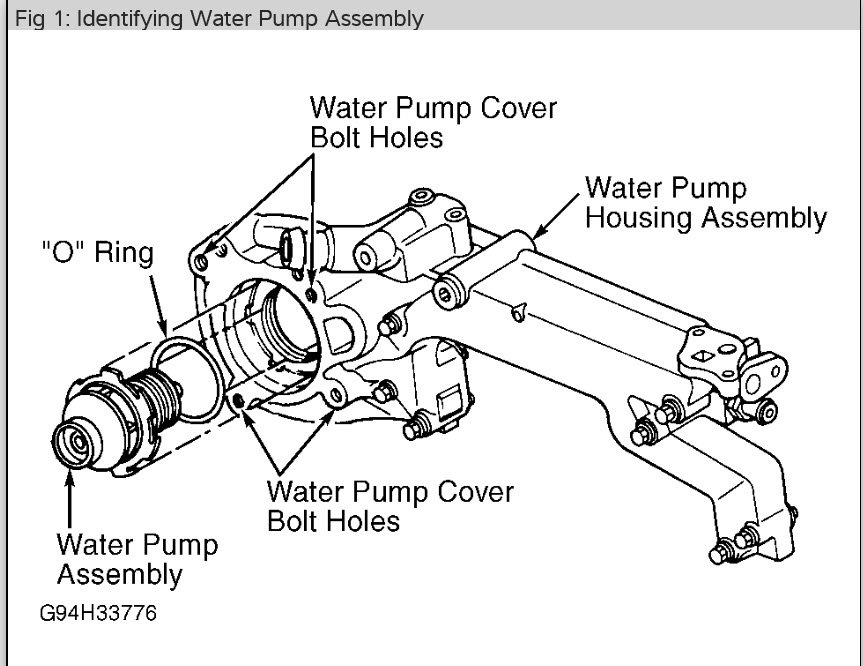

Trying to find the easiest way fastest most efficient way to take it off. I need a video or some person that just know how to describe taking it off. but a video would be best if possible. I cannot find any videos of my car and it would really help.

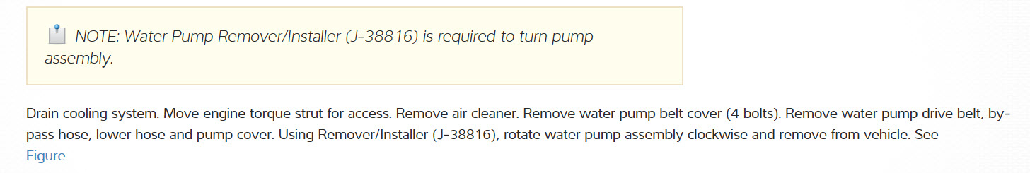

see pictures for removal installation would be reverse of removal . However there is a special tool that is required to remove the pump assembly. Try auto parts see if they have one to rent.
