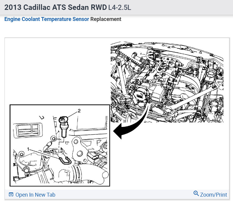

Where is it located please?

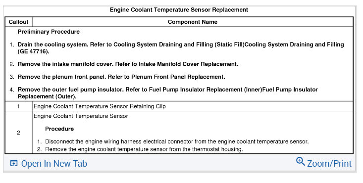

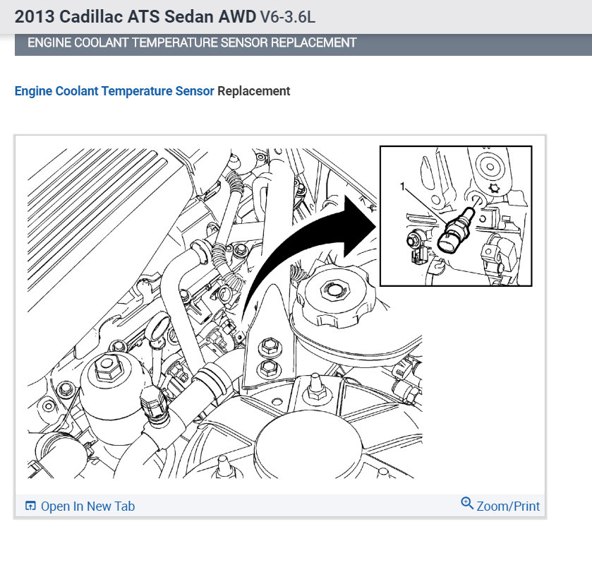

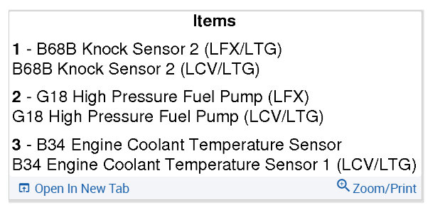

Hello, I am Danny.

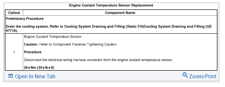

Here is the location. I have attached a picture and location as well as a tutorial to get you familiar to the repair. Check out the instructions in the diagrams below for your car. Hope this helps and feel free to ask any questions as needed. Thanks for using 2CarPros!
https://www.2carpros.com/articles/coolant-temperature-sensor-cts-replacement

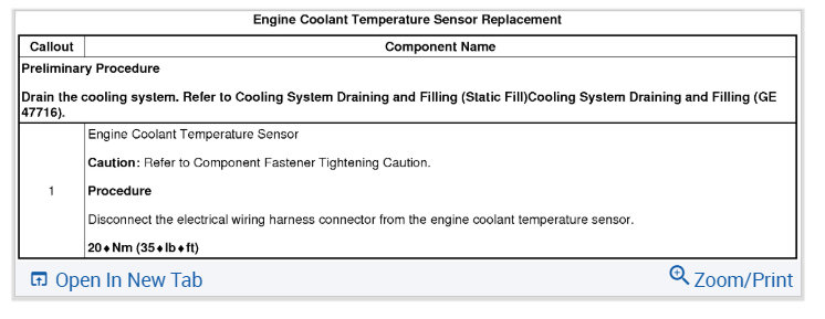

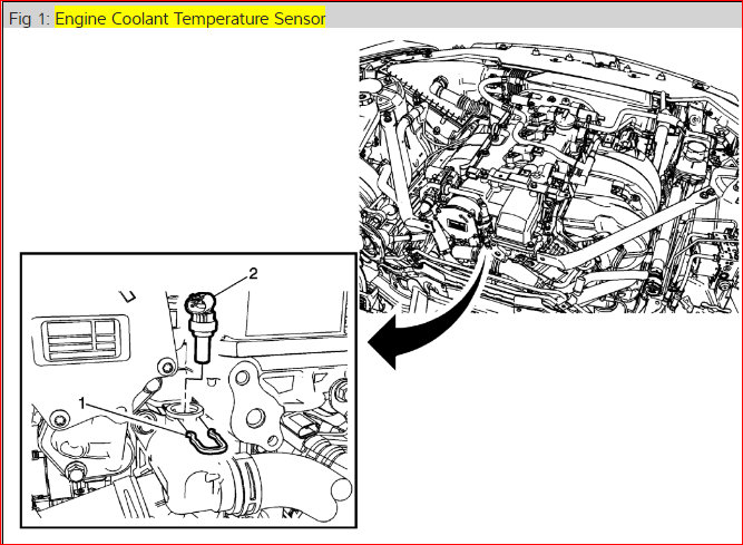

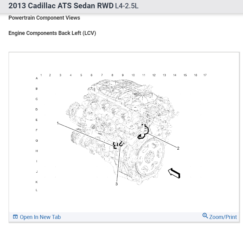

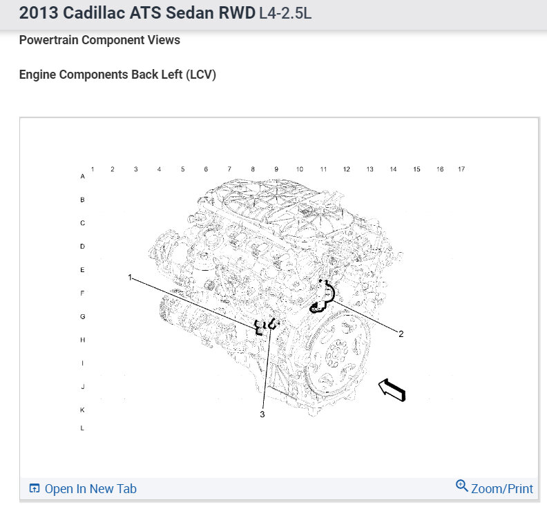

coolant temperature sensor location.
Sep 24, 2020 at 10:56 AM (Merged)

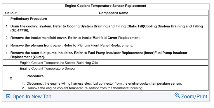

I attached the location for you. I pays 2.7 hours in a shop to replace. Check out the diagrams (Below). Please let us know if you need anything else to get the problem fixed.
