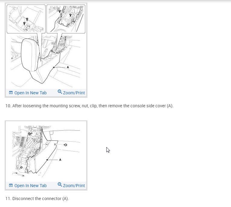

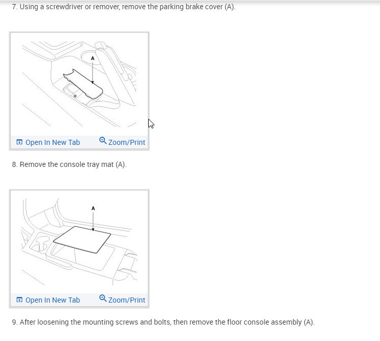

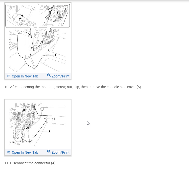

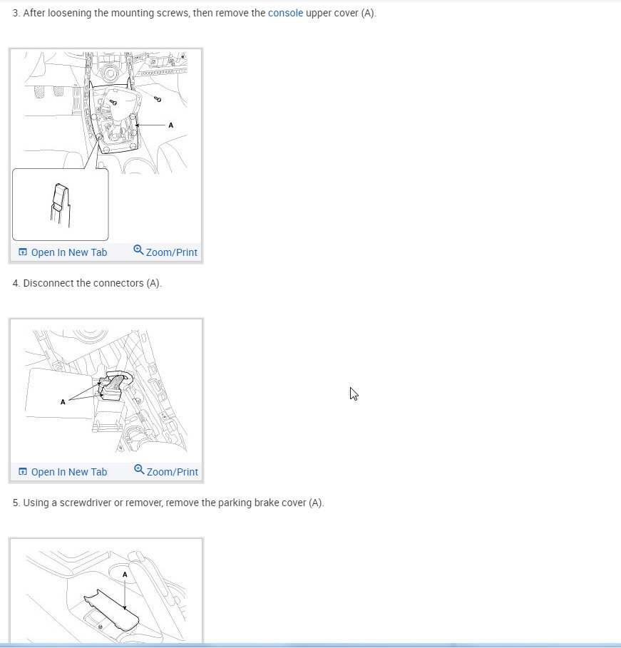

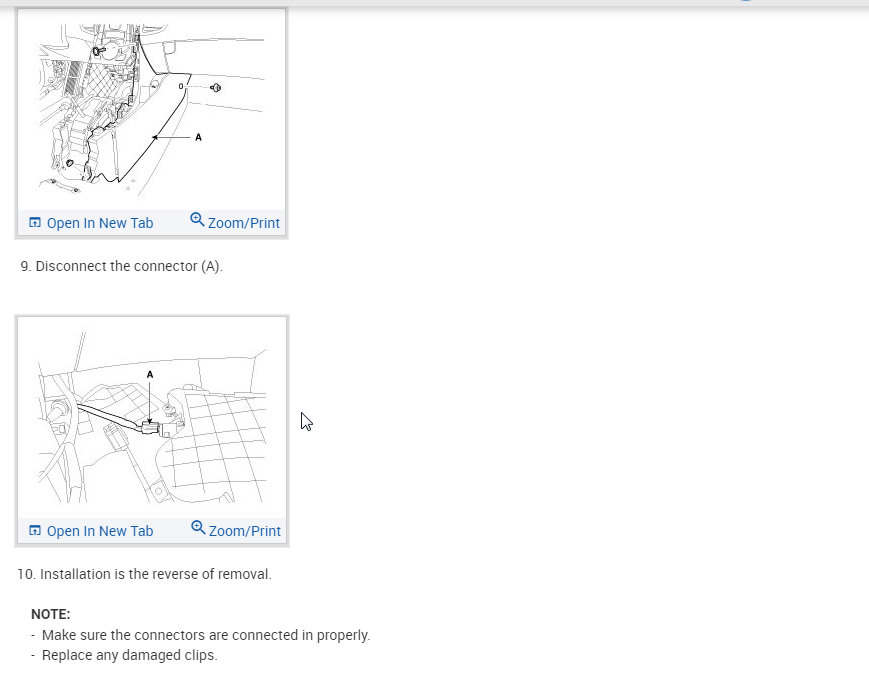

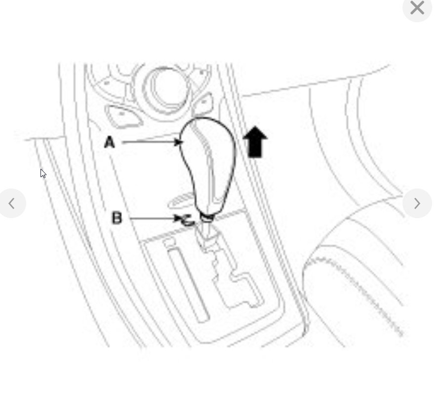

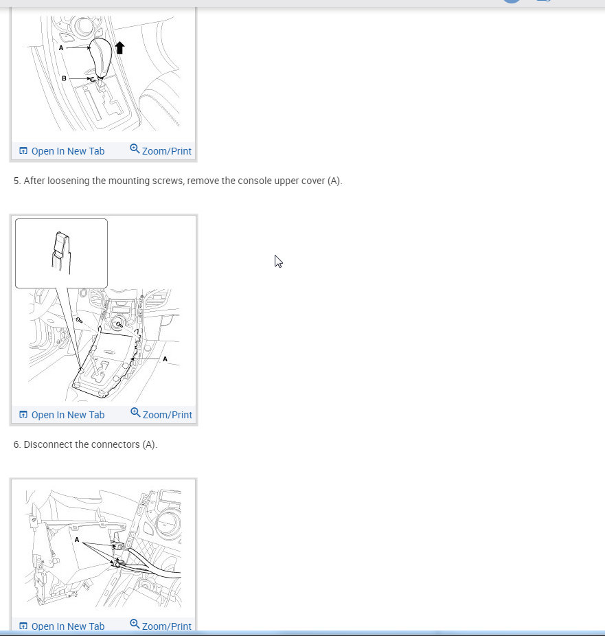

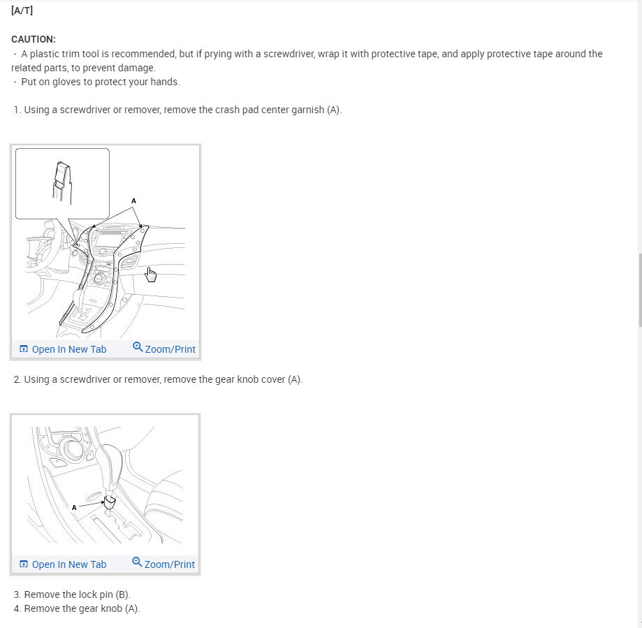

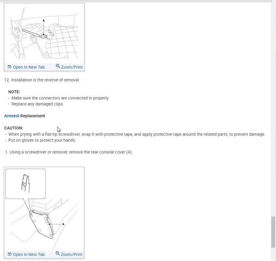

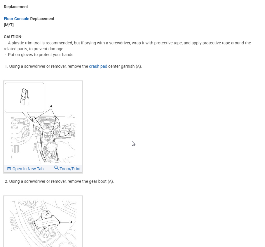

No set screws or clips visual to remove gear shift knob to remove console.
Jul 22, 2019 at 8:01 AM
Hi Jacob,

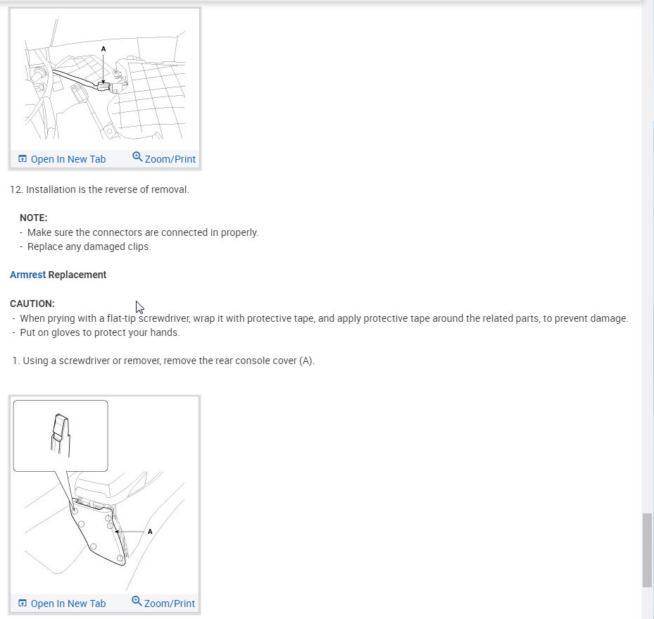

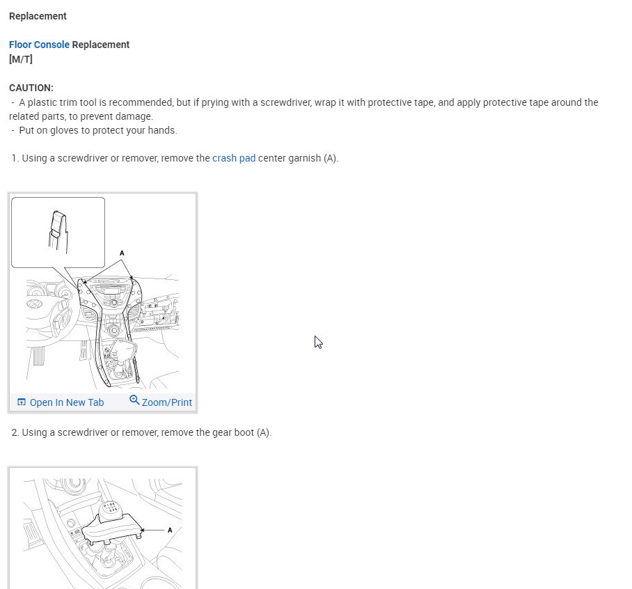

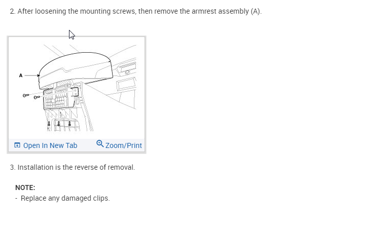

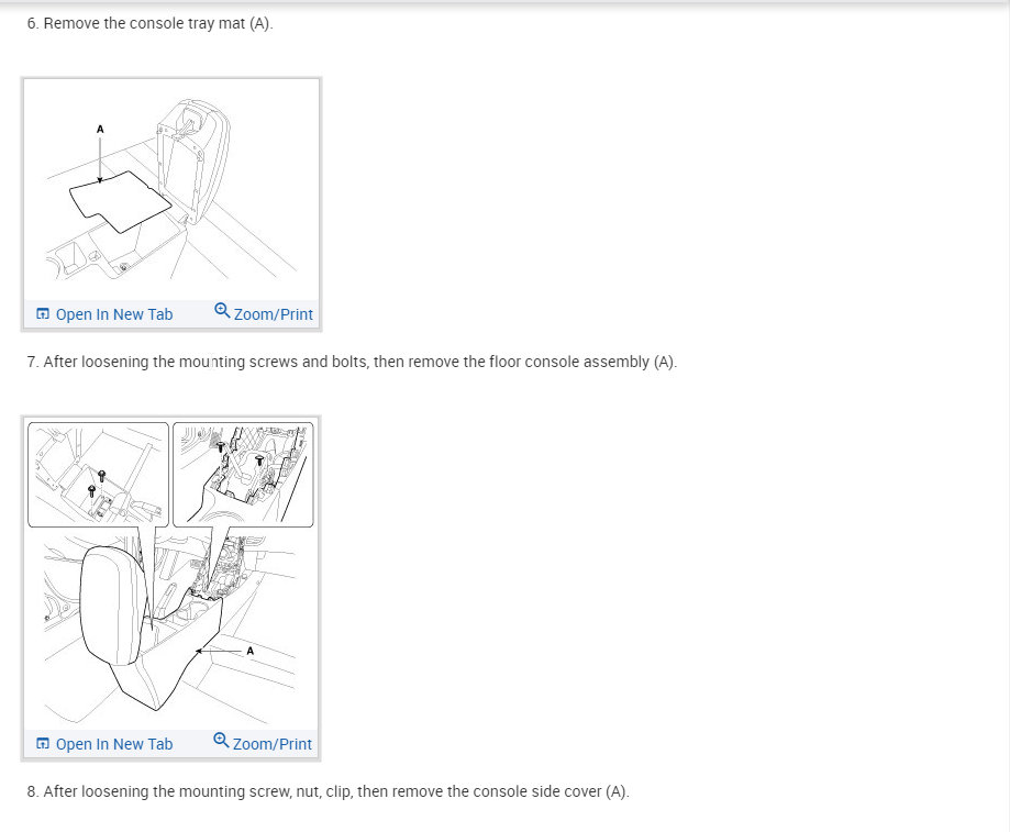

I attached the procedure for both auto and manual transmission. I assume you have an auto transmission because it shows there are no screws. There is a clip that pull out and then you lift up on the shifter.
I enlarged the screen shot on the last attachment. Let me know if you need more info.
