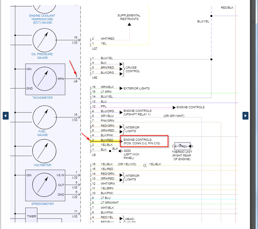

Trying to install a Pro Tach x1000
1,800 MILES
ADAM CROY
What color is the ignition power source wire? I just needed to know nm.
May 17, 2021 at 12:22 PM
  • 55,766 POSTS

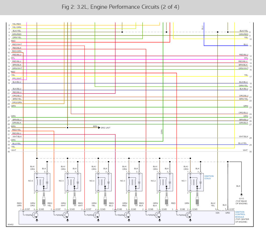

It should go to any of the coil trigger wires ( green, green/white etc). here is a coil wiring diagrams so you can see what I am talking about. be sure to switch the tach to COP mode. Check out the diagrams (below). Please let us know if you need anything else to get the problem fixed.
May 19, 2021 at 4:04 AM

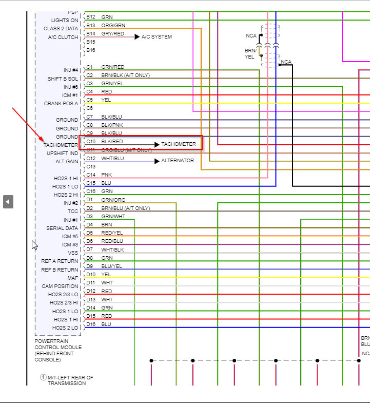

I assume you are looking for the engine speed/tach wire? If this is the case the color is black/red coming from the PCM to the cluster.
Please see the wiring diagrams below that show this circuit. Please let us know if you need other info. Thanks
