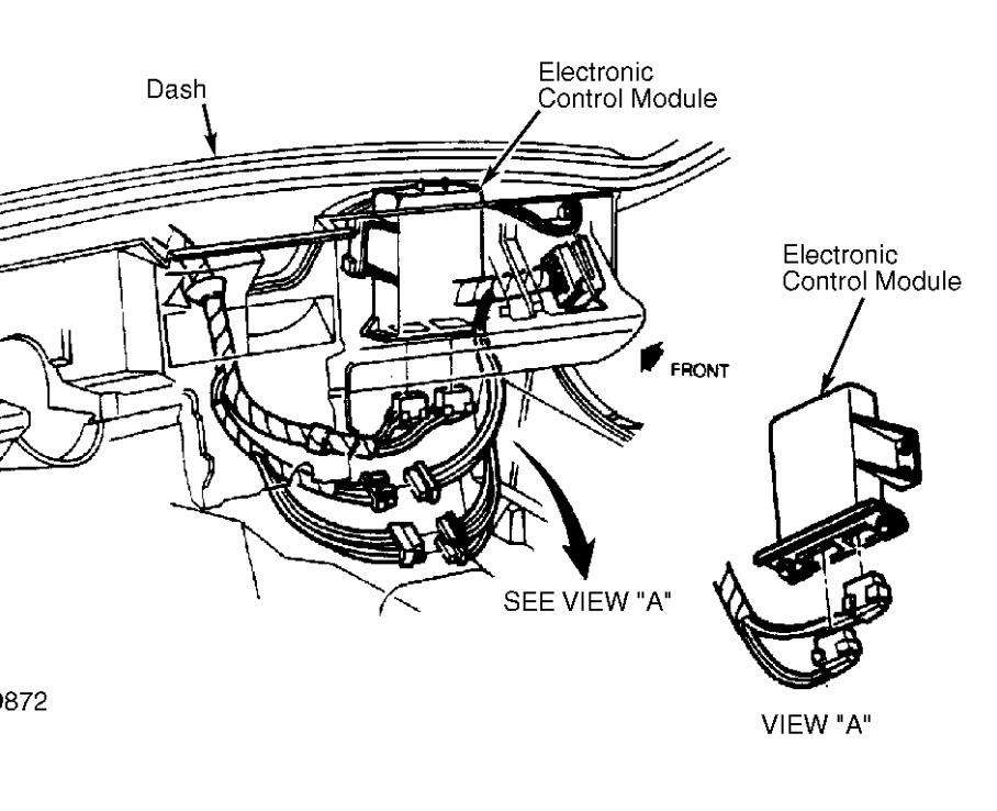

trying to locate computetr to install performance chip
99,999 MILES • 5.7L • V8 • 2WD • AUTOMATIC
AJOYNOW
just need to know where it is and any instructional videos if available

see pic, remove ecm then remove two screws for prom then push clips if any to side pull out old chip reverse for install. be careful to not have any static electricity and use either rubber or vinyl gloves to pull out prom and dont'BEND any pins on install.
