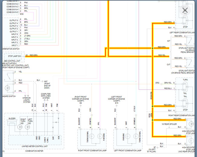

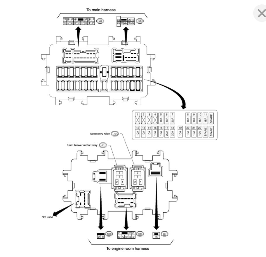

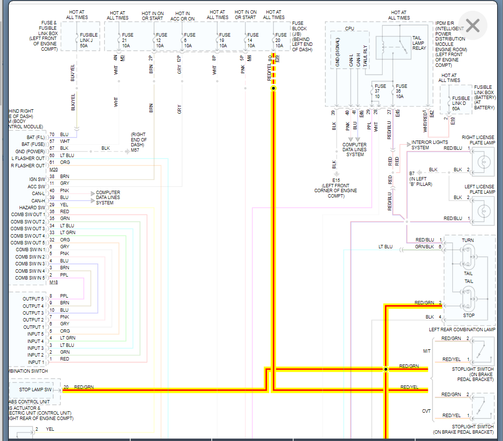

Hi, I’m trying to locate the fuse for the brake lights and have lost the inside cover.
Aug 4, 2021 at 3:37 AM
Experienced Mechanic
18,907 POSTS
There is not a fuse directly for the stop lamps but indirectly through the stop lamp switch.
Here are a couple guides that will help with this:
https://www.2carpros.com/articles/how-a-brake-light-switch-works
Looks like this is fuse 20 and I show all the info below on this.
Please run through this and let us know if you have other questions.
Thanks
