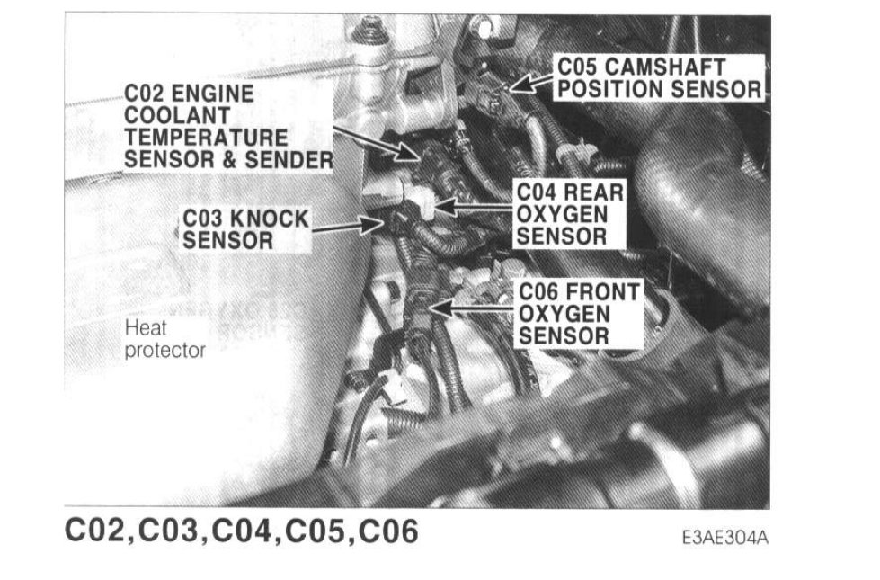

Code p0421
2004 HYUNDAI SONATA
203,549 MILES • 2.4L • 4 CYL • 2WD • AUTOMATIC
DARTANIAN BENSON
Trying to find the location of bank one sensor 2 02 sensor.

I have included the information that you requested in the diagrams down below. Direct Trouble Code[DTC] P0421 is a DTC that sets when your Catalytic Converter has used up it's expected life span and needs to be replaced. I have included the directions on how to replace a catalytic converter below in the link.
https://www.2carpros.com/articles/catalytic-converter-replacement
Please go through the guide and get back to us with how everything turns out.
