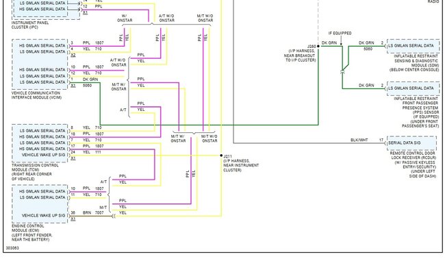

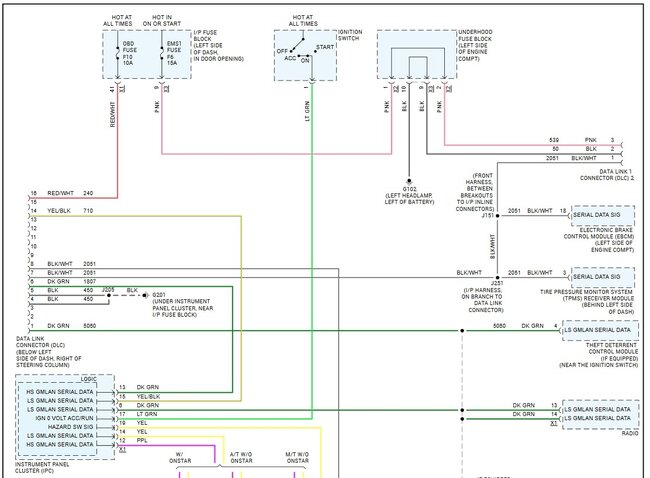

I know that but I also have found out since the first response from me that my car has to have a BCM and I was told that every Aveo 5 most definitely have bcms in them and you guys told me that they don't have a BCM why is that I just curious
Feb 14, 2026 at 10:20 AM
STEVE W.
  • 15,294 POSTS

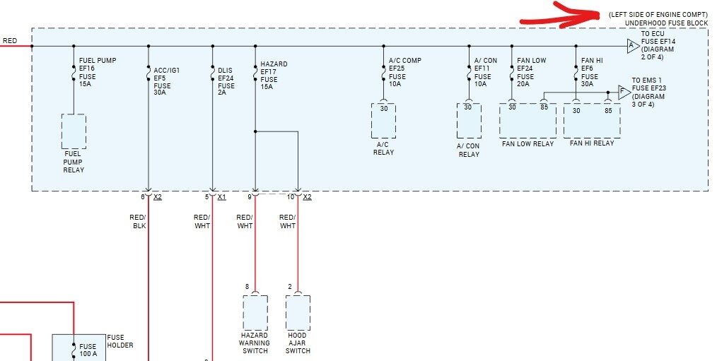

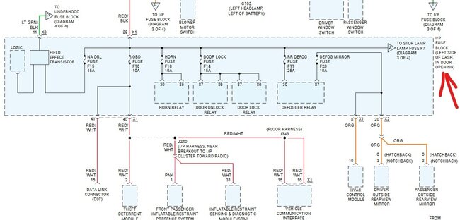

Service information on the vehicle says it doesn't have one for one thing, working on Daewoo vehicles also tells me it doesn't have one. The Aveo is a rebadged Daewoo made in South Korea or Mexico using the same parts.. Instead it has different functions distributed to the other modules. There is part of it in each fuse box, and individual modules that do things like anti-theft which is it's own module, the fuel pump is controlled through the ECM using a signal from the IMMO module that is compared to the security coding in instrument cluster and ECM. There are logic and control section in each of the fuse boxes, but neither are a BCM. They are a type of integrated power center, but do different things than a BCM. That is why I asked the problem, you need to test different things depending on the problem. The attached shows the logic in the fuse panels as well as all of the modules connected to the network. As you can see there is no BCM.
