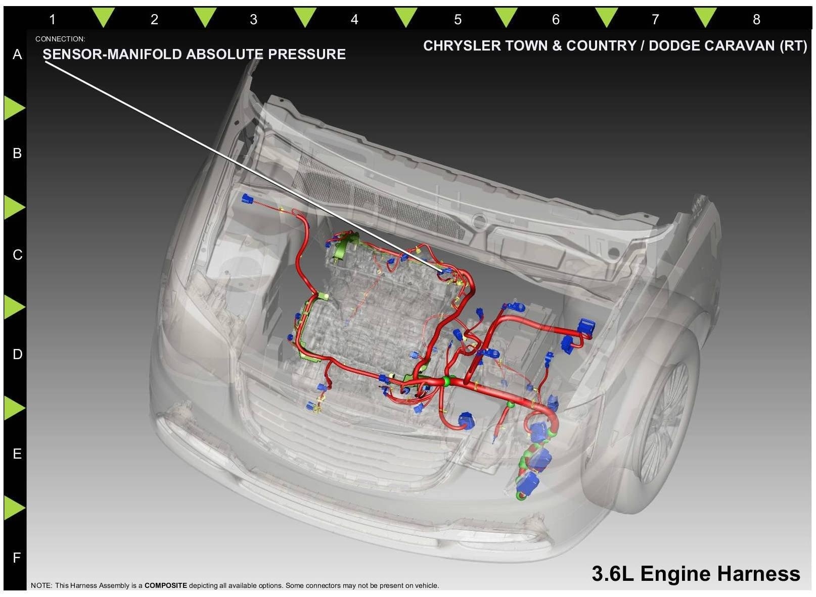

Need to know where map sensor is located? I have an 3.6L VVT.
Mar 6, 2018 at 3:47 PM
CARADIODOC
  • 34,321 POSTS
Back of the engine. They have an extremely low failure rate.
