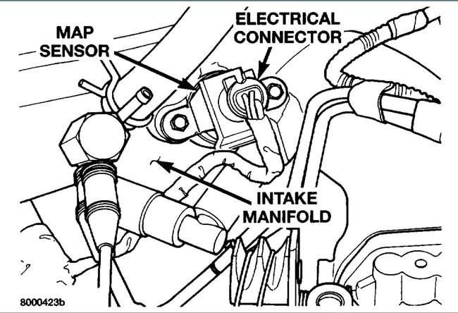

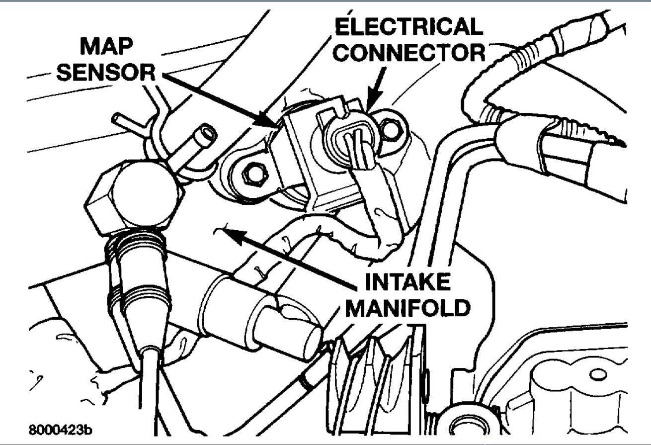

where is the map sensor?
Jun 11, 2008 at 5:32 AM
OBXAUTOMEDIC
  • 3,711 POSTS
It is located on the Plenum it has a single vacuum line going to it and and electrical connection.
See the diagram below for location. My manual has the same diagram for all 3 engines.

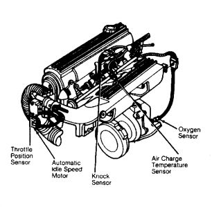

SOLARBLU
Electrical problem
1991 Dodge Caravan 4 cyl Front Wheel Drive Automatic
can you tell me where the map sensor and the fuel position sensor is located on a 1991 dodge caravan 2.4L. If possible please send pic or diagram. Thanks.
Jan 27, 2019 at 12:11 AM (Merged)
  • 110,240 POSTS
The map sensor is on the right side of the firewall and I think you mean throttle position sensor. It is on the throttle body.
https://images.2carpros.com/forum/automotive_pictures/249084_5_34.jpg
