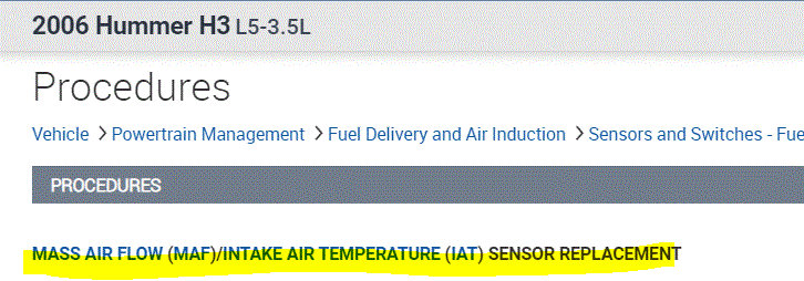

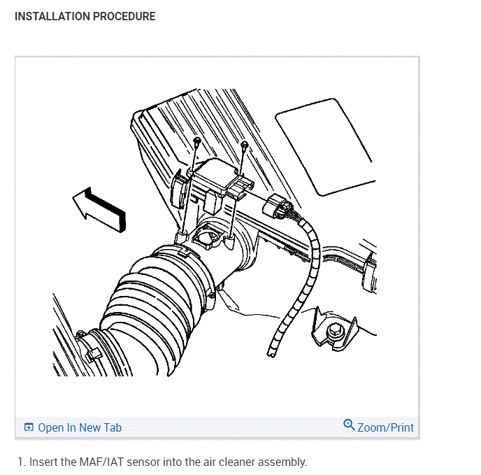

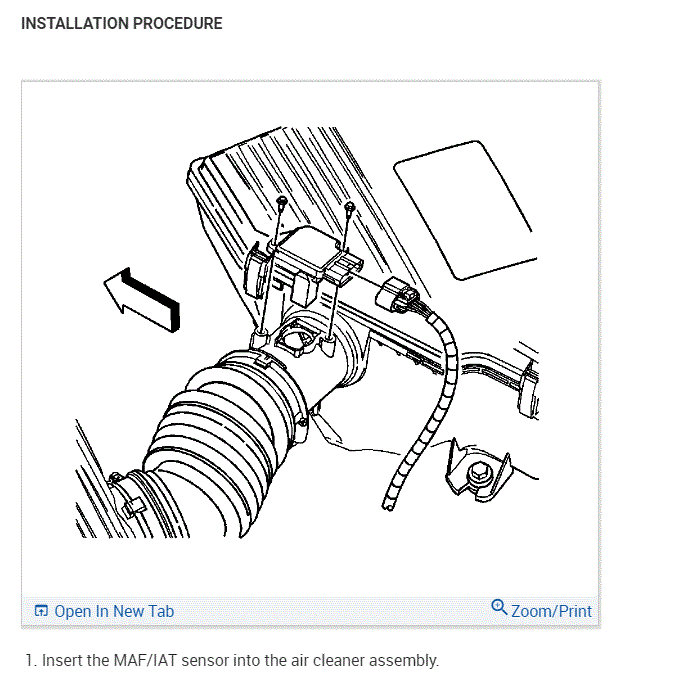

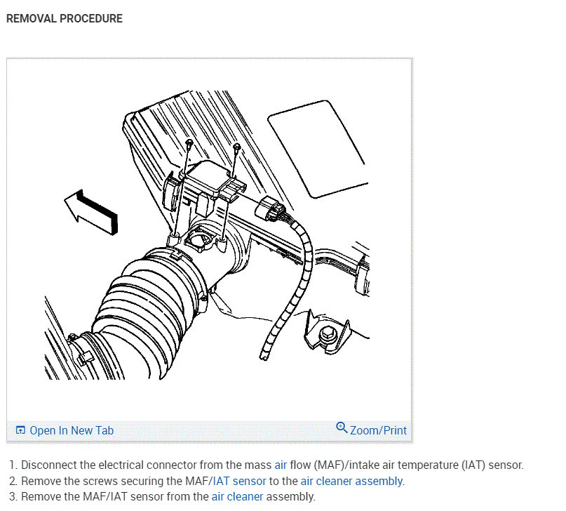

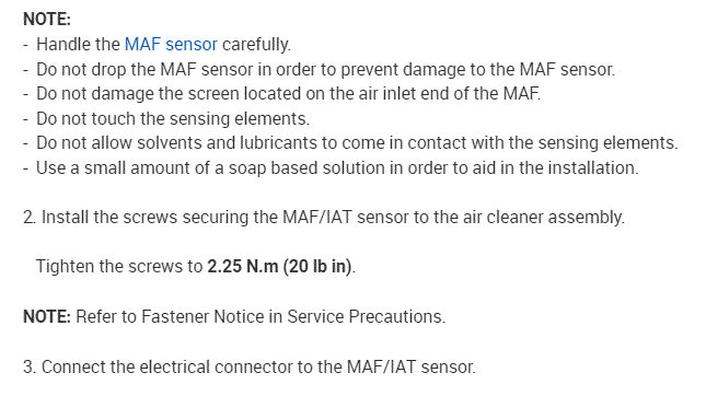

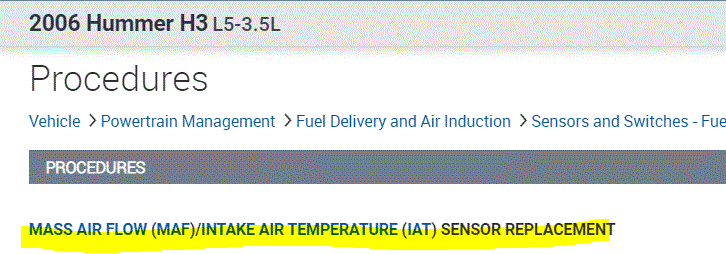

The ambient air temperature sensor is integral to the mass air flow sensor. Chances are that is why you aren't finding info for it. They are located in the air induction tube near the air filter box.
I attached the directions below for replacing it.
