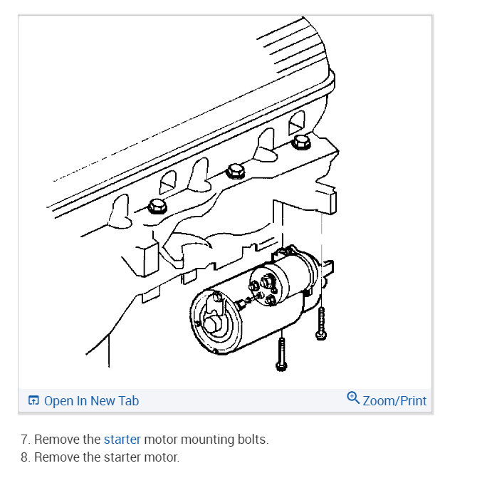

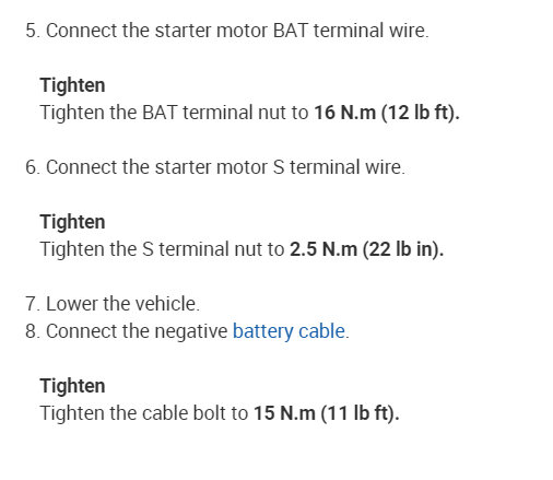

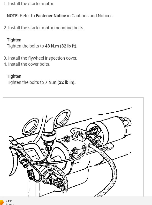

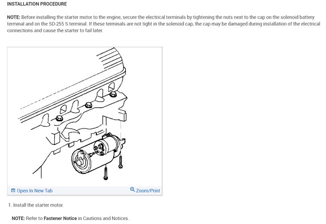

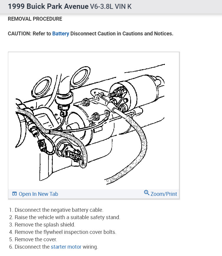

It sounds like the starter motor went bad. To be sure we need to use a test light and hold it on the trigger wire on the starter solenoid, then have a helper turn the ignition key to crank and see if the test light illuminates. If so, the starter is bad and needs replacement. This guide can help, and I have included how to change the starter out in the diagrams below:
