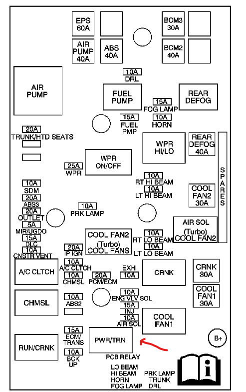

My trunk release button stopped working. Wanted to know if there’s a fuse or relay for it?
Nov 13, 2023 at 9:37 AM
  • 55,399 POSTS

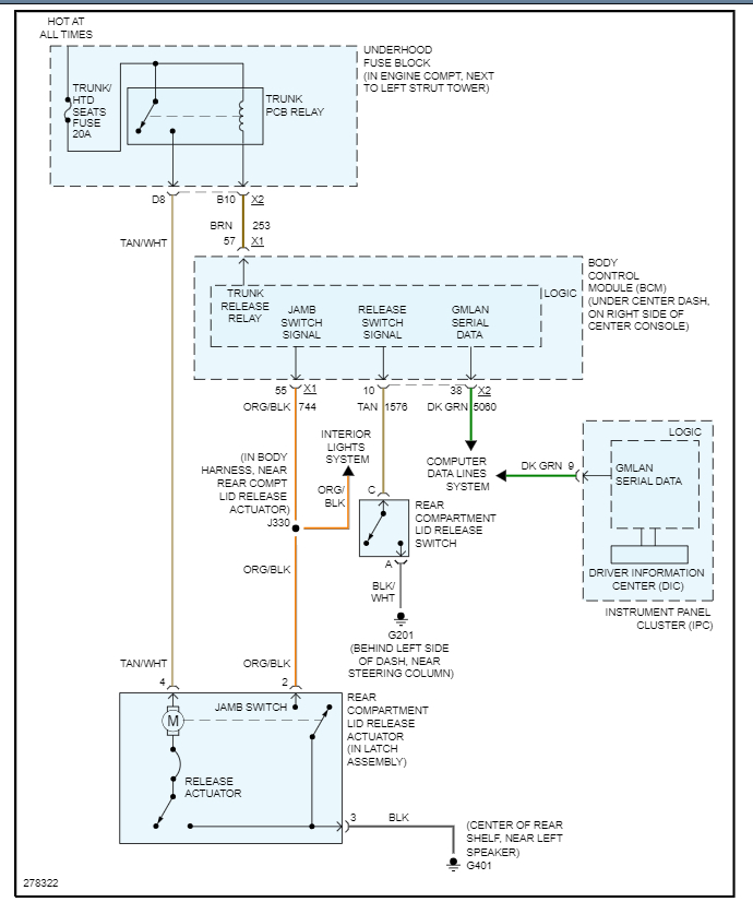

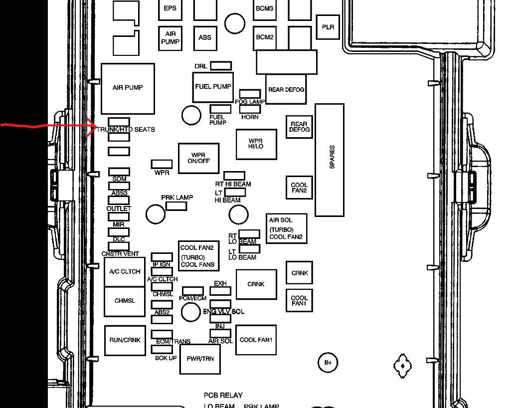

Yes, there is a fuse (trunk/heated seats) and control relay under the hood in the fuse panel on the left side near the shock tower. Here is the location of the fuse and relay so you can check them out and the trunk release wiring diagrams so you can see how the system works.

Would a poor ground cause this? Because my third brake light isn't working, and I used the voltage meter and got 18.60 and that's about right since the fuse is a 20amp. Along with my horn, speedometer, rpm, fuel sending gauge, fuel pump won't prime the gas (which is causing a Vapor Lock) so when I put gas from the pump it shuts off at the pump likes it full and most of the time can put only no more than 2gallons. Then it's full at the filling tube and won't go down. The obe harness that's below the oil filter. I bump it while the car was in secondary, and I heard a click sound. Moved the thick strand of taped wires and click, click. Took a hold of the bulk strand and the other hand was moving portions of the wires till I got to the electrical harness that has four wires and goes under where the starter is.
Nov 14, 2023 at 2:33 PM
  • 55,399 POSTS
Yes, a bad ground or a shorted wiring harness can cause this problem. Try to see if there are any ground connection near where you are moving the harness around?
