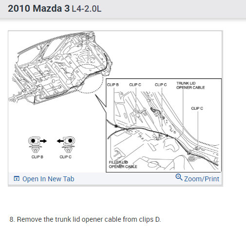

is cabin trunk release in the vehicle listed above electrical or mechanical?
Had flooding. Need to check cabin and trunk. When I open door cabin light usually comes on. Is doing this recommended?
Sep 2, 2021 at 5:08 AM
SQM
  • 6,383 POSTS

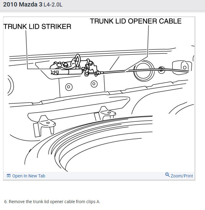

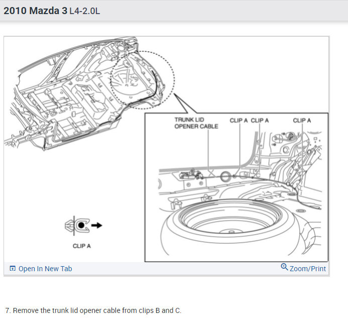

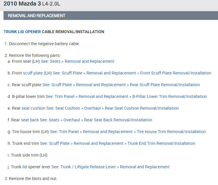

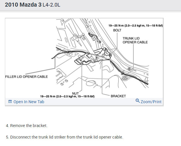

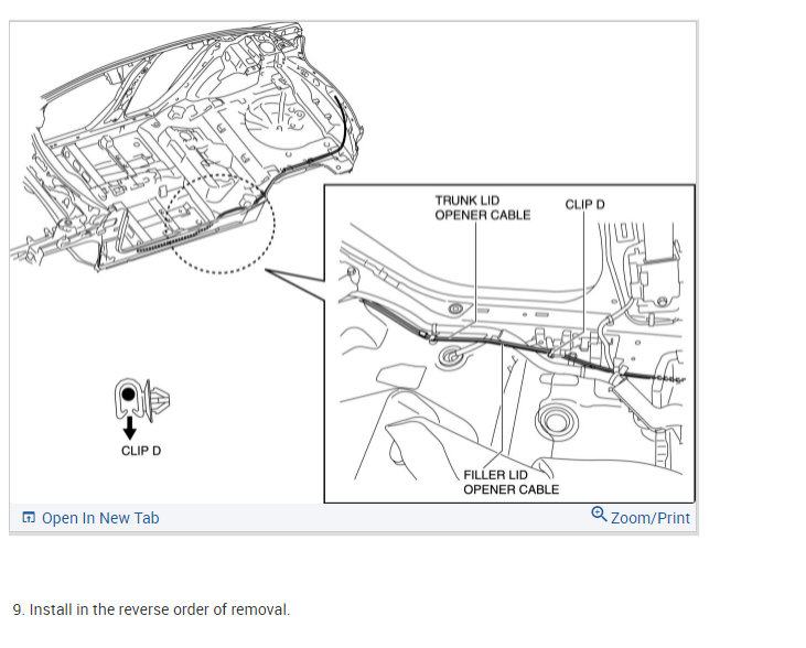

The truck release is operated by cable, so it is mechanical.
Unless something got jammed or broke, you should be able to open the trunk.
See attached for the diagrams.
