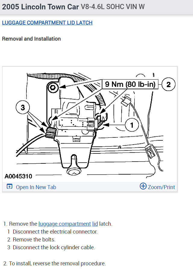

when closing trunk, it tries to close making a quivering sound and will not pull down.

It sounds like you have an auto closing latch that is weak and needs to be replaced.
Here is how to change trunk latch out. Check out the images (below). Please upload pictures or videos of the problem so we can see what's going on.
