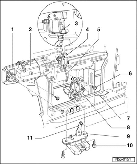

How do I locate and replace the trunk lock actuator?

The actuator is located with the latch assembly. I have attached a picture with all components related to the rear latch assembly. The actuator is number 4 in the picture.
Here are the directions for replacing the latch assembly. I had to include everything to the actuator could be included.
_____________________________________
Rear Lid Lock, Removing And Installing
1 - Locking clamp
2 - Handle
- Removing
- Unclip lid trim (handle is secured with a bolt).
- Unclip pull lever, pry out locking clamp and remove lock cylinder housing from handle.
- Disconnect connector for luggage compartment light and unclip operating rod for central locking system if necessary.
- Remove Torx bolts and remove handle from lid.
3 - Actuator securing bolt
- Loosen and tighten using Socket wrench T10010
4 - Central locking actuator
- Removing
- Disconnect connector from actuator.
- Remove actuator using Socket wrench T10010 and remove from lid.
5 - Pull lever
6 - Torx screw
7 - Operating rod
8 - Lock cylinder housing
- Removing
9 - Lock
- Removing
- Remove lid trim.
- Disconnect connector from lock.
- Unclip operating rod , remove bolt and remove lock from lid.
- install - only with striker catch in detent
10 - Oval-head machine screw
- 20 Nm
11 - Actuator lever
Installing
- Engage locking clamp again.
- Position lock cylinder housing on to grip piece and lock in handle with an audible click.
- Then proceed in reverse order of removal.
