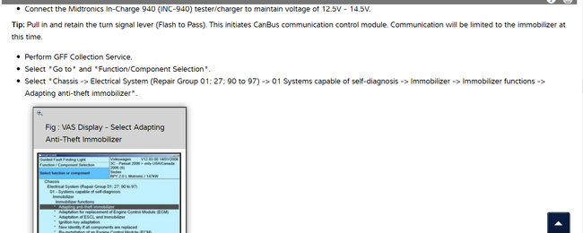

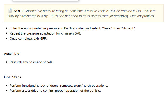

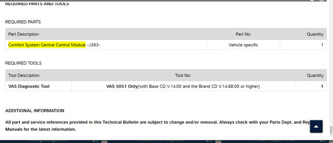

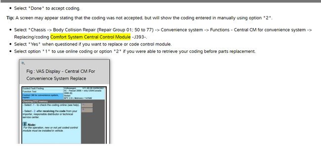

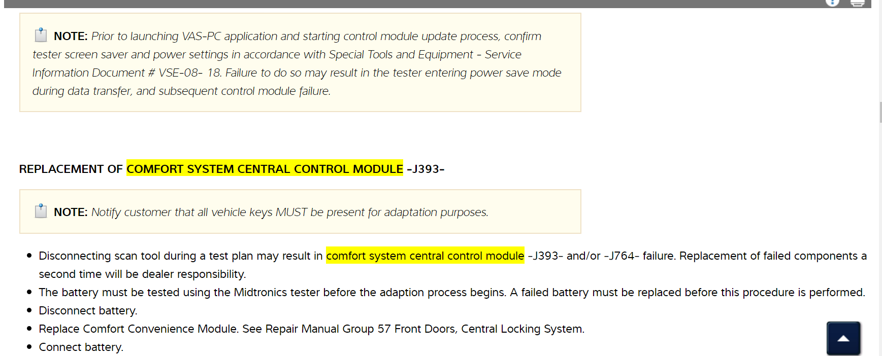

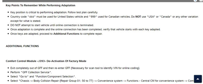

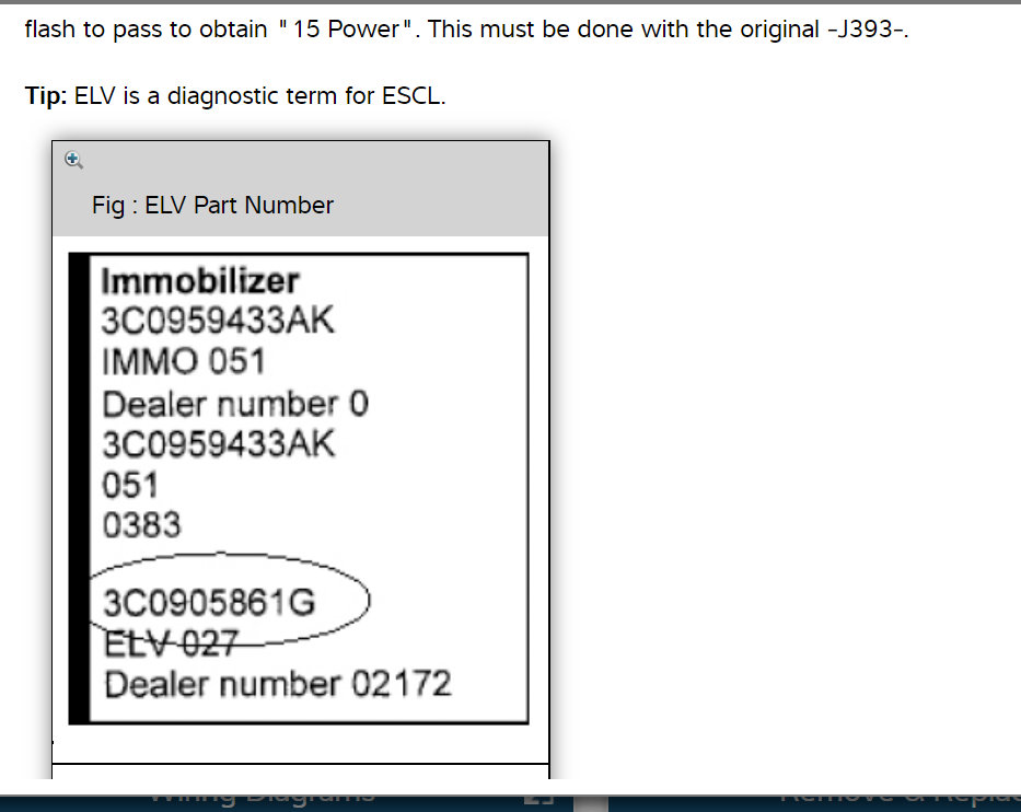

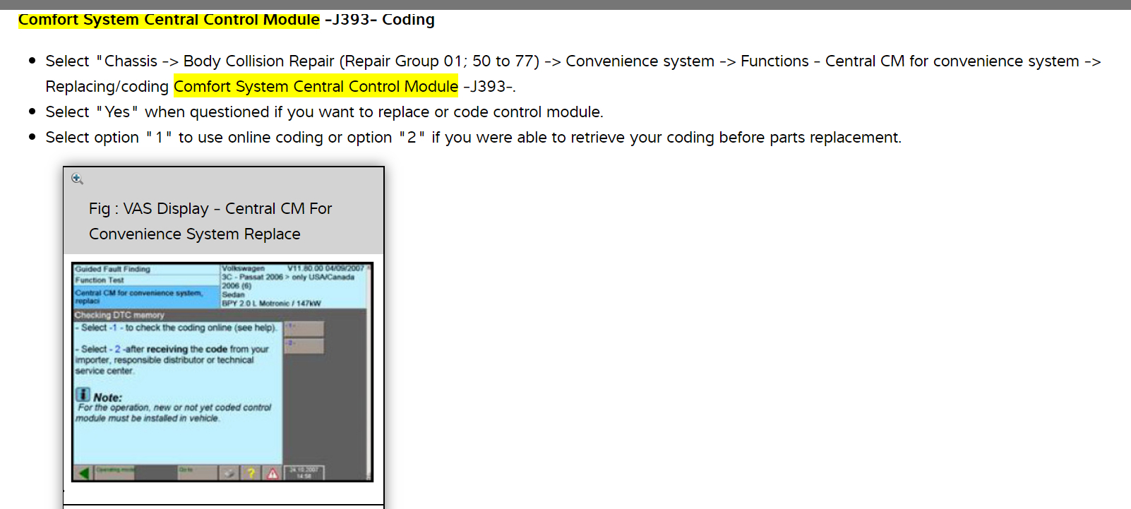

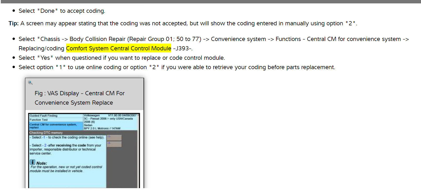

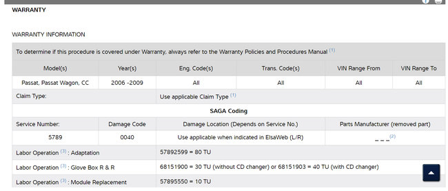

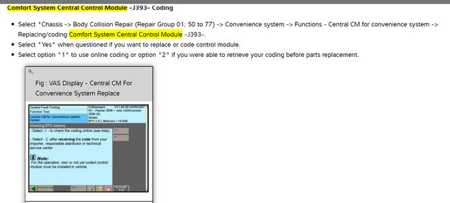

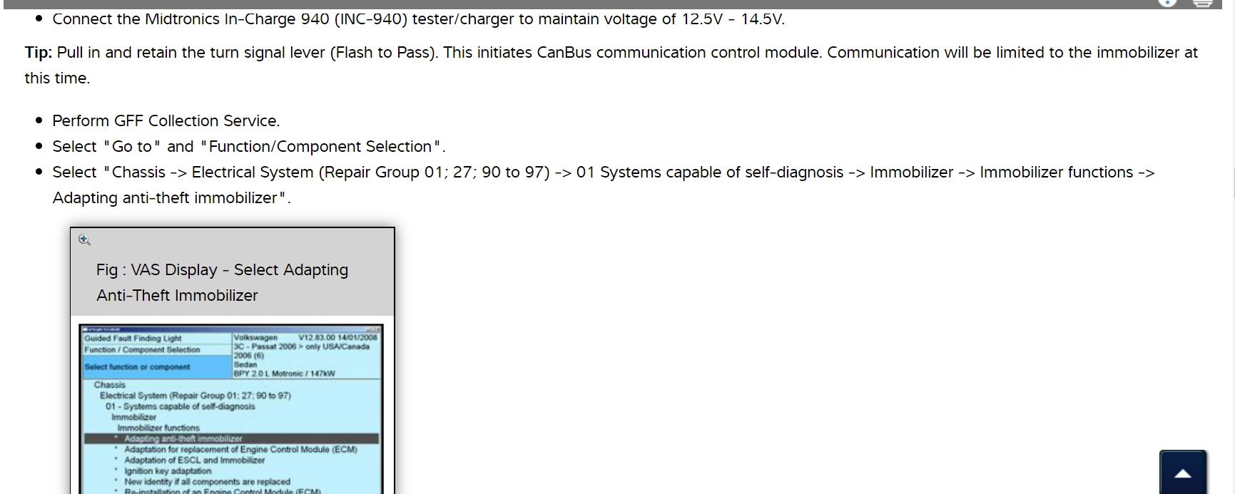

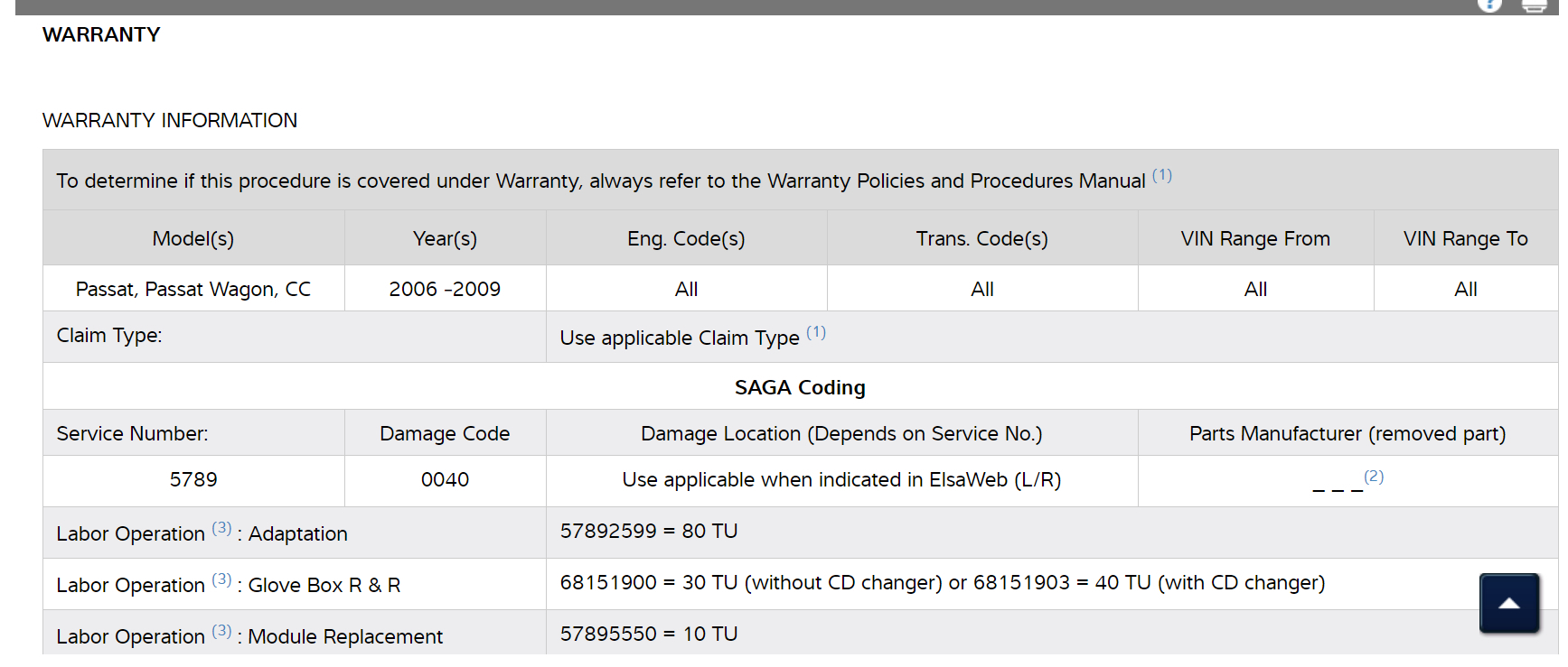

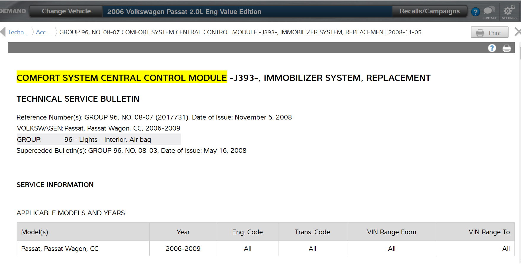

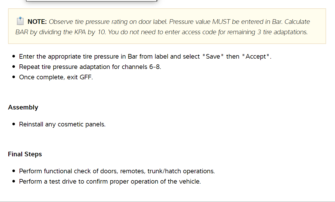

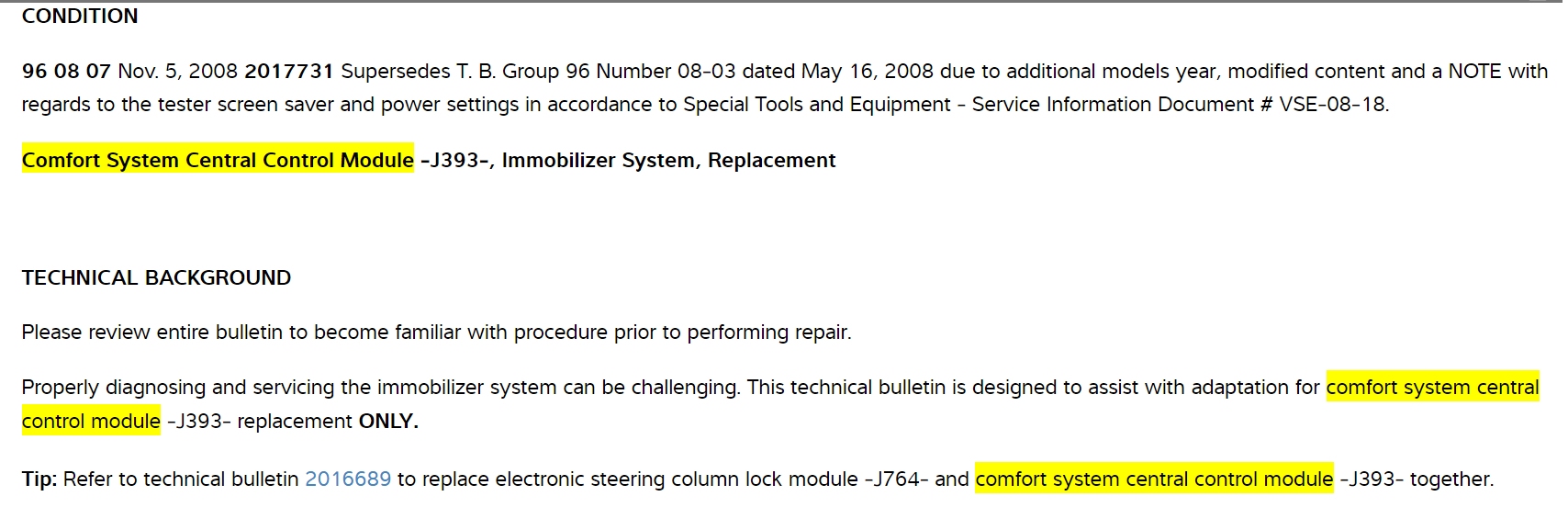

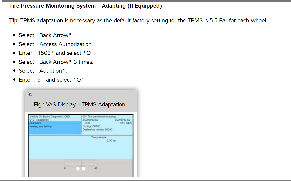

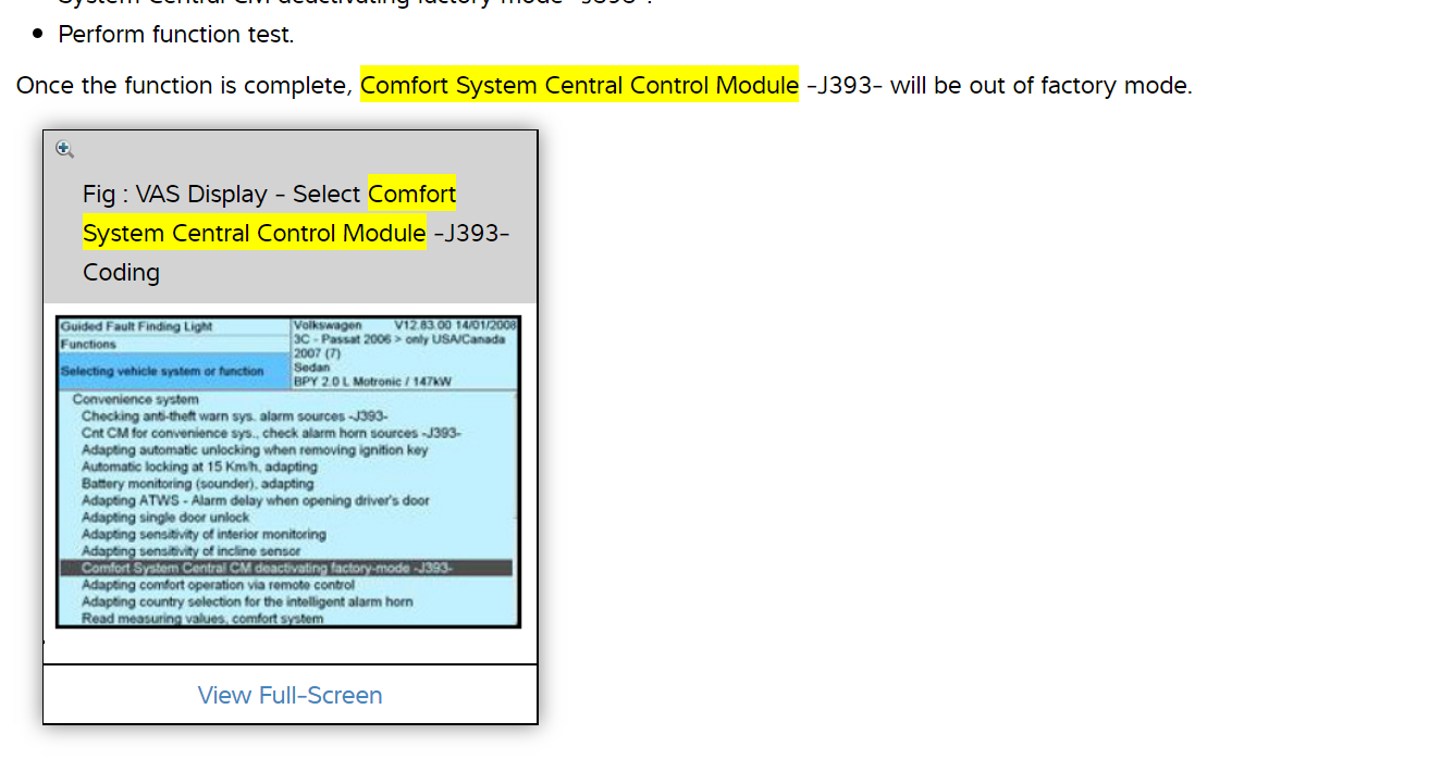

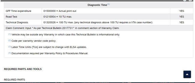

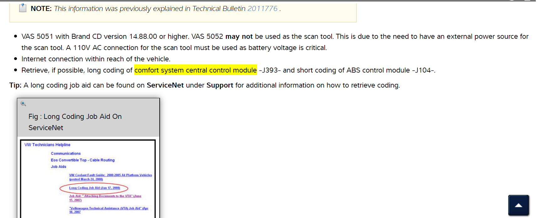

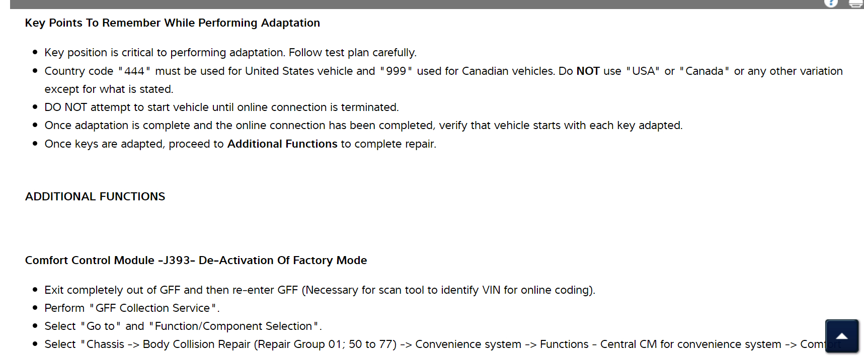

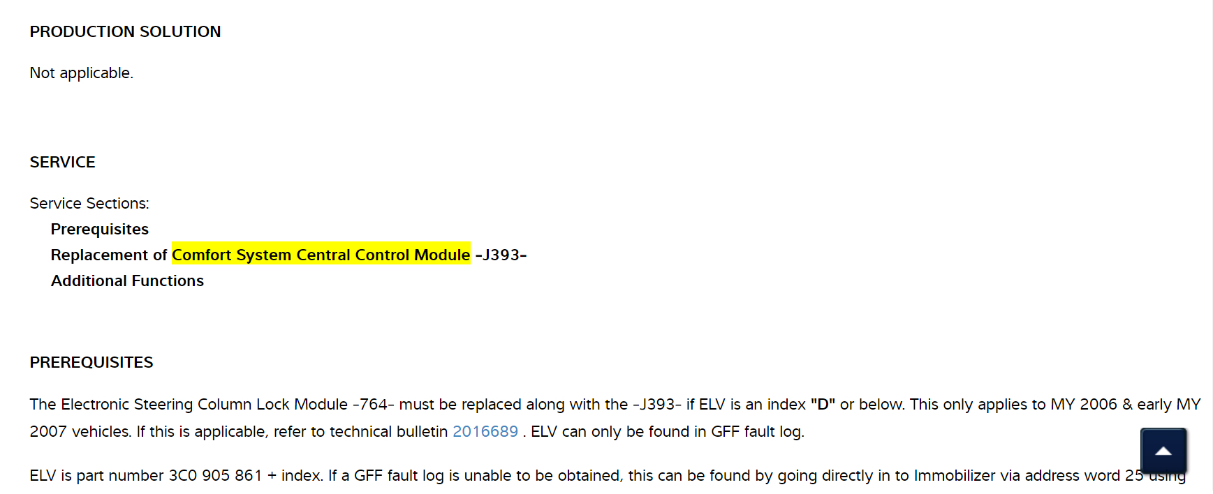

It is fuse #3 in fuse panel B. It is located on the left side of the engine compartment. Fuse at 2 doesn't directly control the Rear Lid Lock Unit though, instead feeding power to the Comfort System Central Control Module. This module is the one that provides power to the Rear Lid Lock Unit. I just found you possibly good news. A Technical Service Bulletin from Volkswagen about replacement of the Comfort System Central Control Module. I have included it in the diagrams down below. You might want to call your local Volkswagen dealer and inquire about it. There is good possibility that you could get this fixed for free. Get back with us and let us know what you find out.
