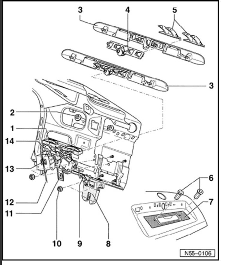

When we attempt to open the trunk we can hear the switch activate but the trunk does not open. I am unable to locate a manual release. How do I manually open the truck, so I can repair the device? The dealership will not share any information. But for a starting $175.00 they will look at it. The VW parts department states there are only two parts, the latch ($79.00) and a servo ($49.00). I cannot get the trunk open. We have a son with autism and mental retardation and I do not want my wife to get a flat tire and not have access to the spare.

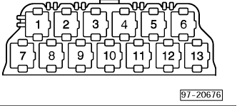

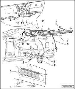

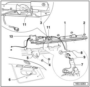

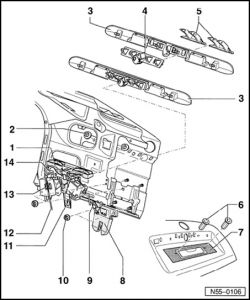

Hello Ray. Okay, I have attached a few pictures for you to review. The one with the relay positions. Try swapping relay #2 with another and see if the lock works then. You may need to get in through the rear seat to remove the panel. If not the other pictures in a couple of them item 6 and 8 have nuts can the nuts be removed and the latch stay connected to the catch and then the trunk open? In the other picture item 7 shows an actuator can you push on it to release the trunk Also, is there a connector you can disconnect and put 12 volts to one pin and ground the other and if that does not work swap pins and try it again. You may have to have someone gently pushing down on the truck during any of these to allow the latch to release with no pressure. Let me know how this goes.
