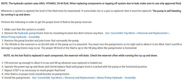

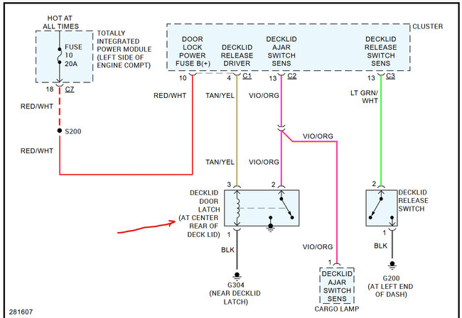

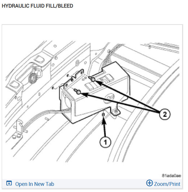

If the trunk latch switch has dirty contacts, it will not signal the module to close. This is why you hear the whining. I would also check the hydraulic fluid in the system as well and add any if it i low. Here is how, also the switch is located at the center rear of the trunk lid. Check out the images (below). Please upload pictures or videos in your response.

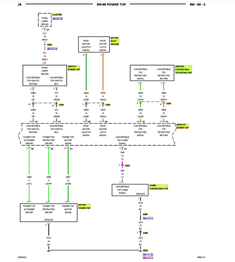

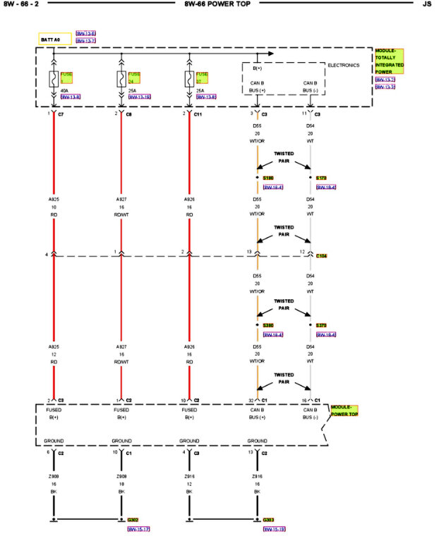

So do you mean you shake the wires under the hood or trunk lid? Either way this is a wiring issue. You will need a wiring harness or some one to chase the wires. Here is a wiring diagram for the system and a guide to help test the wires so you can see what needs to be done. Check out the images (below). Please let us know what happens.
