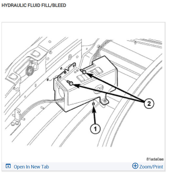

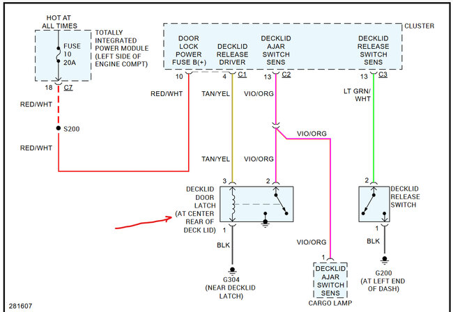

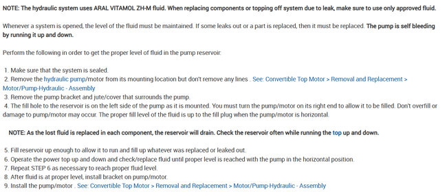

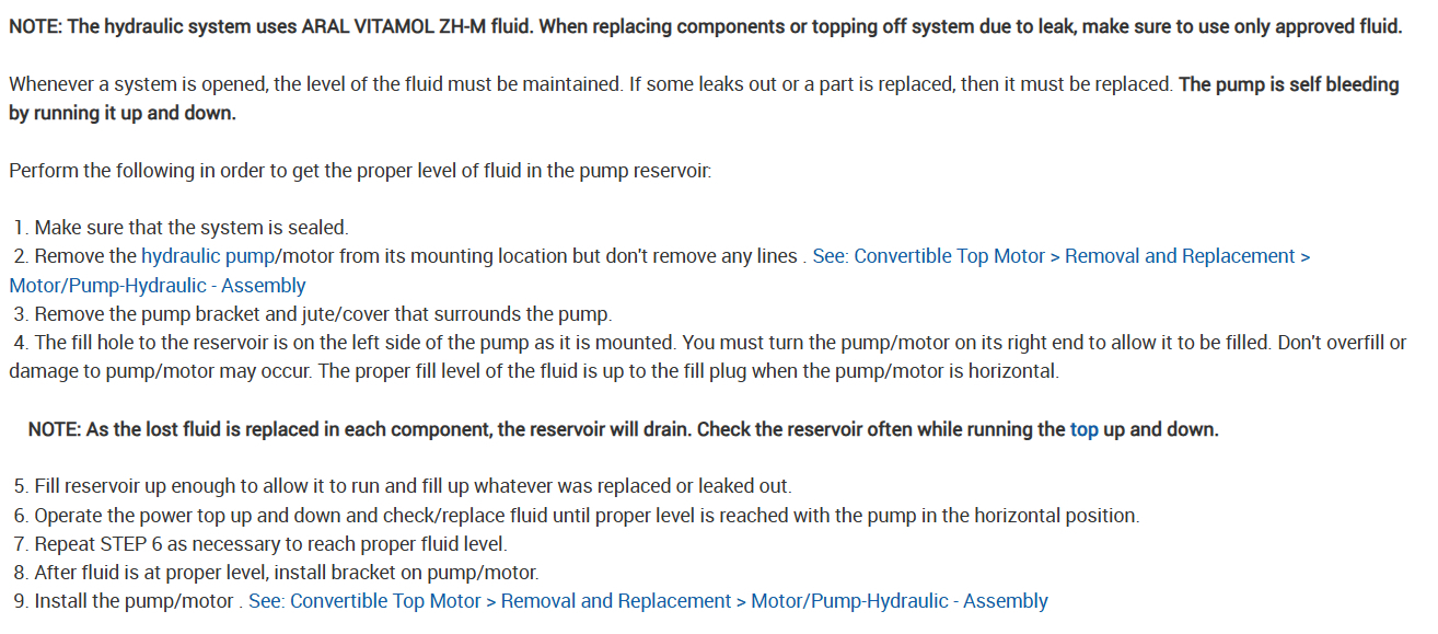

If the trunk latch switch has dirty contacts, it will not signal the module to close. This is why you hear the whining. I would also check the hydraulic fluid in the system as well and add any if it i low. Here is how, also the switch is located at the center rear of the trunk lid. Check out the images (below). Please upload pictures or videos in your response.

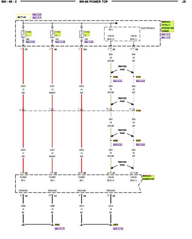

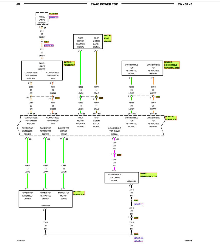

So do you mean you shake the wires under the hood or trunk lid? Either way this is a wiring issue. You will need a wiring harness or some one to chase the wires. Here is a wiring diagram for the system and a guide to help test the wires so you can see what needs to be done. Check out the images (below). Please let us know what happens.

It is the wires that run along the hinge in trunk on passenger side. There seems to be many, so this is outside my ability being the way my health is. I'm thinking that there is only a few that deal with the lowering of the trunk lid, but only a guess. I will check out what you sent me. Thanks, take care, Happy Independence Day, and I will be in touch.

Yep, happy 4th!! Yep, it sounds like you have a break in the wire or a lose ground wire. The harness will need to be checked. It would be nice if I could fix it for you but I am in computer land :/
