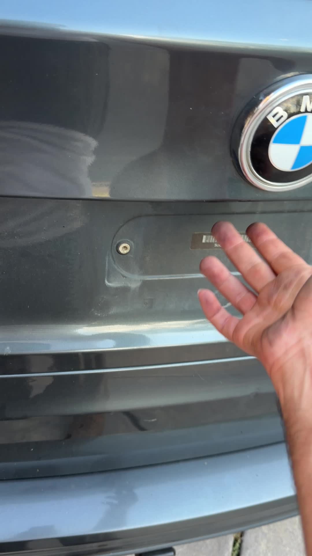

Would not open. Hard to lift. Its a power gate

Yes, these have a spindle drive that go out, here is how to replace it.

I replaced both sides but now the gate wont close using power or by hand.

Are those used power struts? It looks like they are trying but dot have the power.

No, they are new. I would not dare to put used ones, they are a bit pain to remove

I see. but that would not explain why it loses power sometimes at the compressor, and why the compressor can work all day freezing cold then soon as you shut off the car and start it it won't come on

Lets do a CAN scan for codes.

All good. Thanks

Good job, glad you got it fixed!
