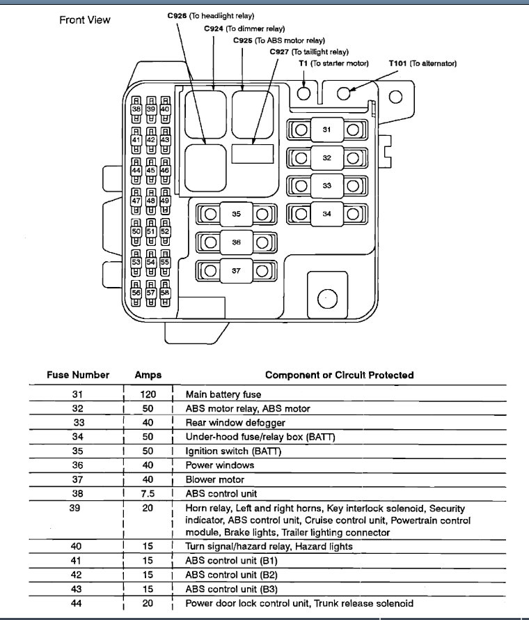

I do not have a fuse box cover and i need the trunk button fuse.
Jun 29, 2019 at 8:49 AM
Hi Nicole,
Looks like it says fuse number 44 is for the trunk release. Is this what you needed? Let me know if you need more information. Check out the diagrams (Below). Please let us know if you need anything else to get the problem fixed.
