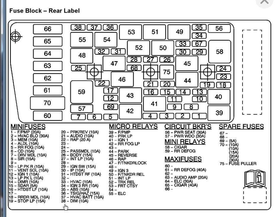

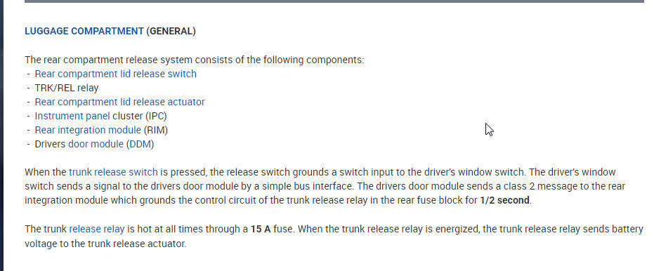

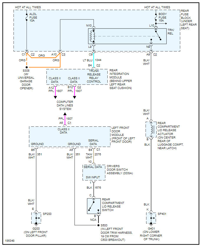

More then likely this is a faulty relay. I suspect the relay is shorted and it making intermittent connection and it pops the trunk.
Here is a guide on how to test the relay:
Also I attached the wiring diagram and location of the relay. If it were me, I would replace the relay and see if it acts up any more. I suspect it won't but we won't know for sure unless it does it again.
Let us know what questions you have and we can go from there. Thanks
