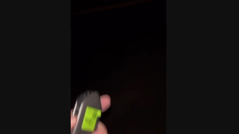

So I have a brand new 2025 k4 with only about 300miles on it and I noticed I have an intermittent issue with my trunk. So yesterday I pressed down the trunk button on my key fob and I heard the beep and click as if my trunk were unlatching but it remained closed. It wasn't until the third attempt that it finally opened . Now it's working just fine but there's certain times I'll press the fob and it doesn't unlatch or only partially lifts when trunk is popped. Any ide what the issue could be?

Yep, I would use WD40 on the trunk latch to see if that helps. The electric actuator may be slightly misaligned or stiff from the factory. Sometimes they loosen up after a bit of use. Please upload a video of the problem in your response so I can see?

It seems like the gas lift shocks are bad, this is a new car though so it is a strange problem, when you push the button for the trunk to open can you try helping the trunk lid up to see if that helps. This way we can tell if the problem is the latch or the lift shocks. Thanks for the video it helps.

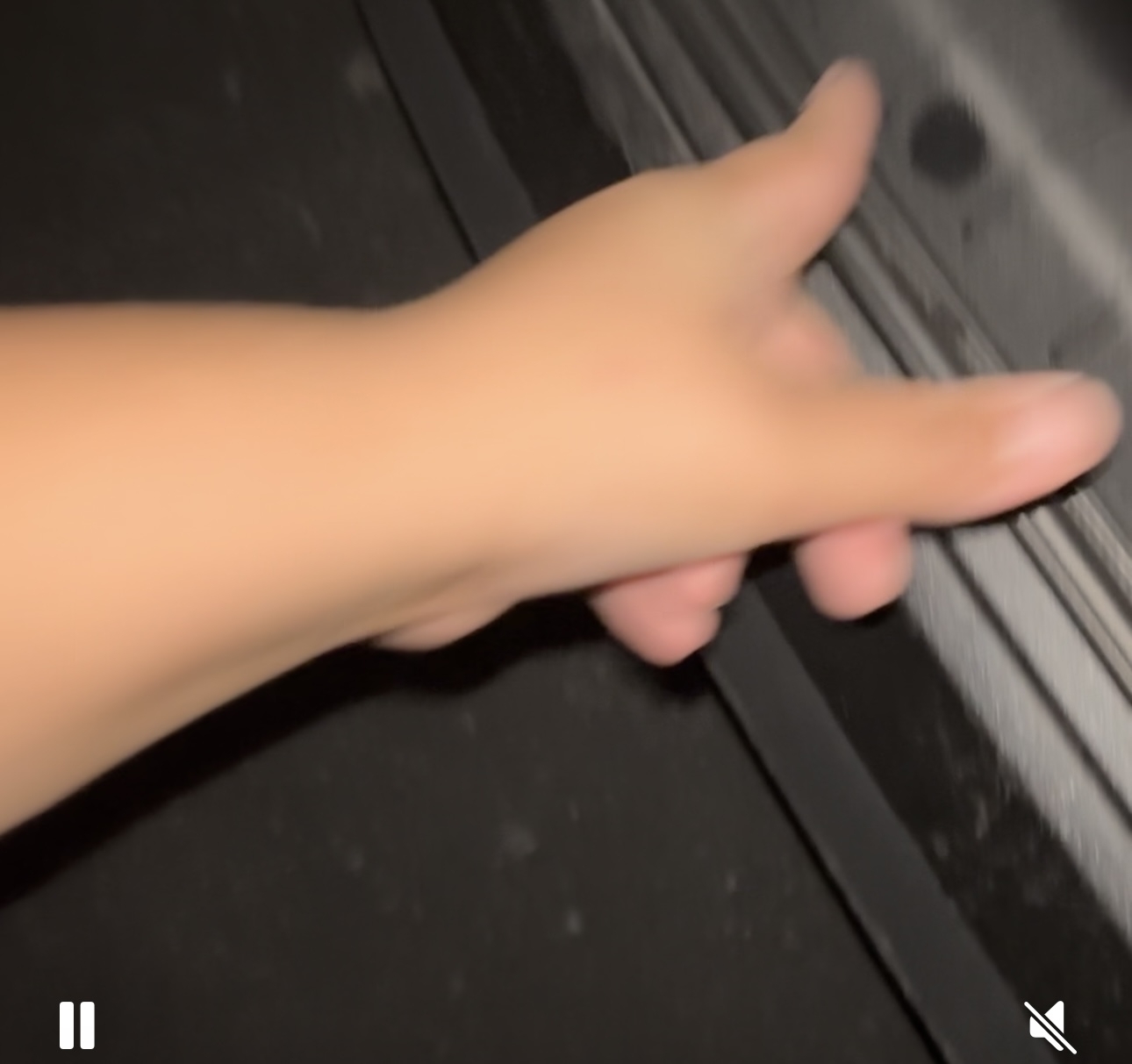

Rarely use my trunk, been like a month since I last popped it open and today I went shopping and went to pop the trunk and I heard it unlatch but didn’t lift so closed it and tested again and it worked just fine. I noticed an oil residue on the knob’s of the trunk latch as well. Would cold weather in the 30s-40s lately cause it to get stuck or Is this indicative of an actual electrical issue With the trunk?

This is the oil residue

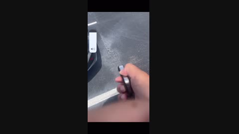

Here's another video of what happens
Nov 24, 2025 at 8:34 AM
  • 55,433 POSTS
Thanks for the video, yes this will be a programming issue, it looks like the car will need to be updated at the dealer. I would take it back to them and show them what you showed me. They should reflash the BCM and CAN-bus system which will fix the problem. Please let me know how it goes.

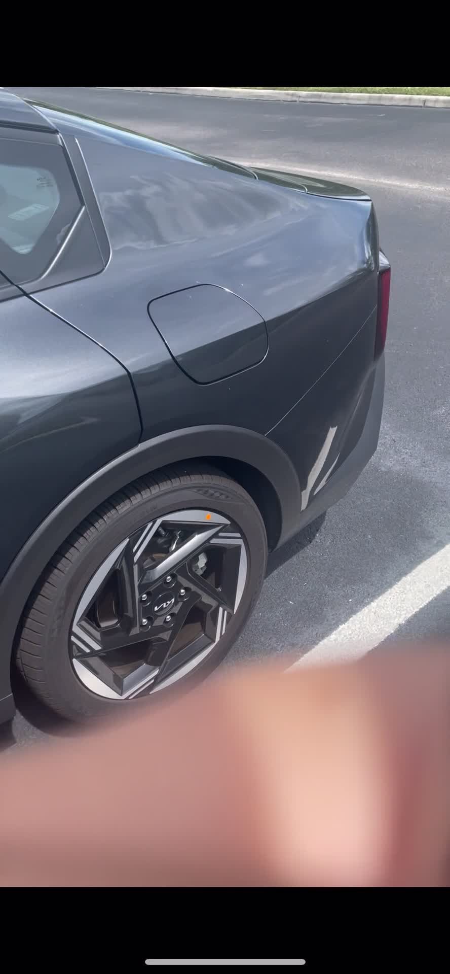

Hit button on key fob and trunk unlatches but doesn’t always lift open. It pops open but doesn’t lift. Already been to the dealership 3x and they can’t replicate issue because ii’s intermittent. They had taken harness apart And tested latch mechanism and circuits and then applied silicone oil and issue persisted. Any ideas? I uploaded the dealership info as well as a video of the issue. Hope this helps! Thanks a bunch
Dec 12, 2025 at 9:03 AM (Merged)
  • 55,433 POSTS
It sounds like the latch is the problem,(not opening fulling sometimes) I would swap it out which should fix the problem.

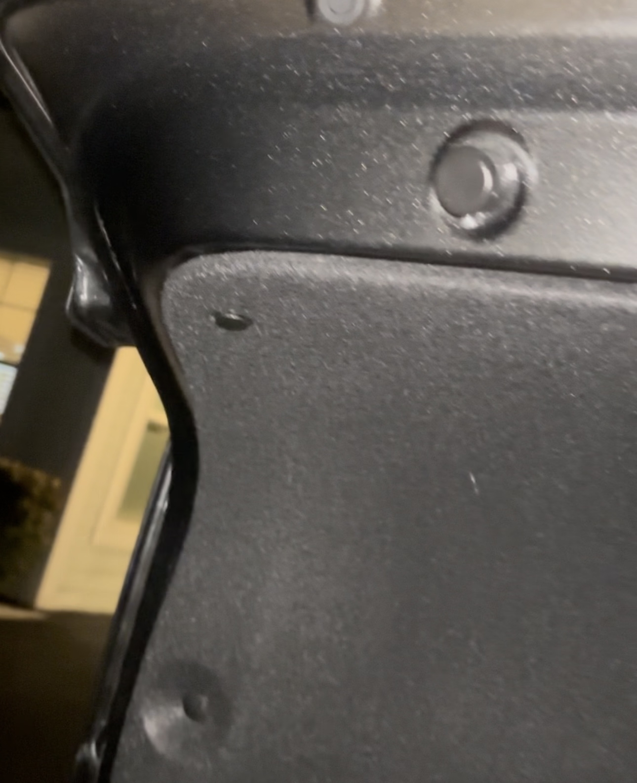

No but I noticed there were grease marks on the rubber border of the trunk where the grommets align. I already went to the dealer over 4x and they ran a bunch of tests and looked at the actuator, latch, etc and couldn’t replicate the issue and it’s intermittent which drives me crazy
Dec 30, 2025 at 4:00 AM
  • 55,433 POSTS
Yep, it sounds like there are missing something. I would try the latch because if it doesn't fully release sometimes it will cause this issue.
