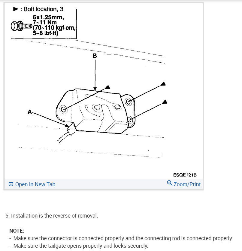

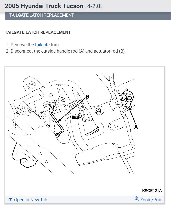

The trunk latch is not working.
Jun 18, 2019 at 12:11 PM
  • 54,832 POSTS
It does not open does not close? What is wrong? If it wont open the control rod may have fallen off and you will need to replace the inner panel. Here are diagrams so you can get the job done. Check out the diagrams (below). Please let us know what happens.
