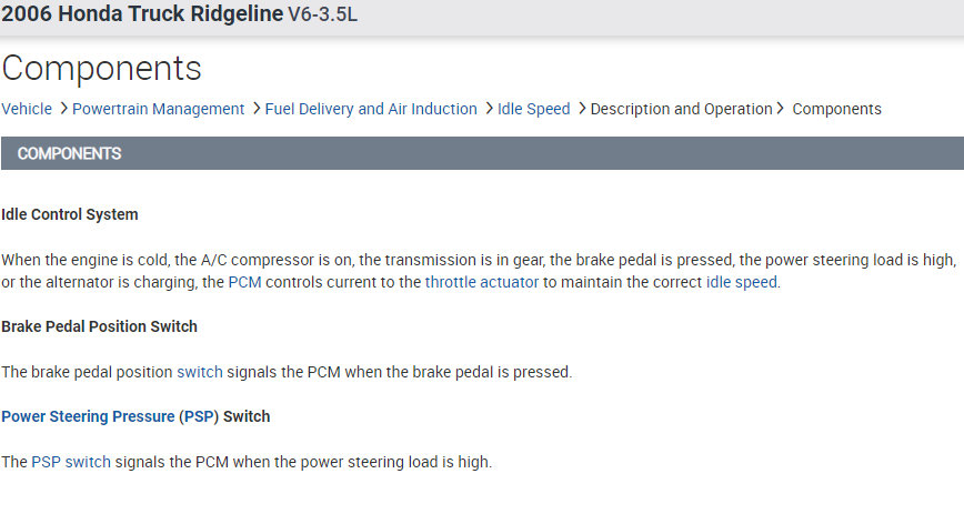

It sounds like you might have a faulty Idle Air Control motor/valve.
The idle air control valve is responsible for controlling the engine idle speed via the car's PCM (computer). These valves are configured differently depending on manufacturer but perform the same task. The IAC or ISC valve as it's called diverts engine intake air from the main throttle body and bypasses a portion of the intake air to control idle speed. When the idle speed cannot be controlled it will trigger a check engine light (MIL) due to idle speed fluctuations.

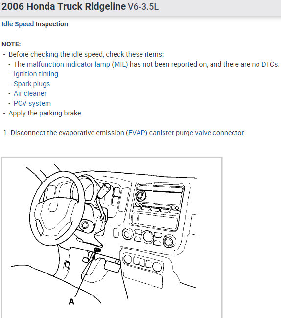

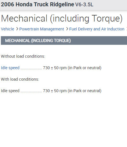

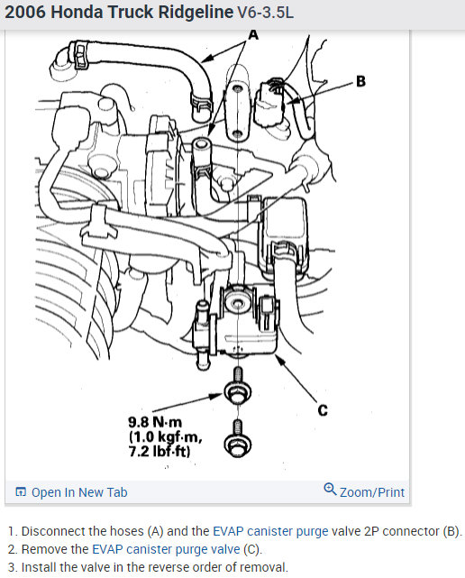

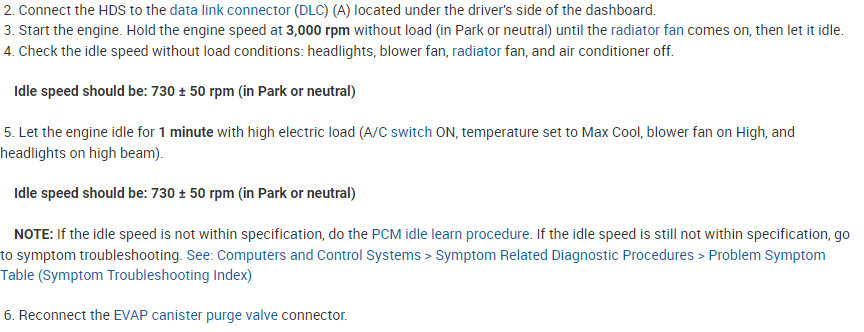

What are the codes that you have on this truck?
I have attached diagnostics for the IAC on your truck.
Let me know of any questions.
