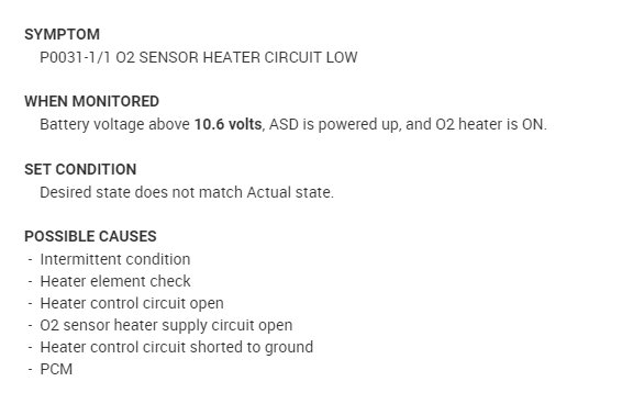

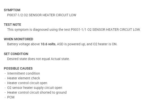

I drove through some flood water that was maybe 1-2 foot deep and my truck began running badly, lost power and spits and sputters. It's run horrible ever since. It shows codes p0031 and p0037 any suggestions?

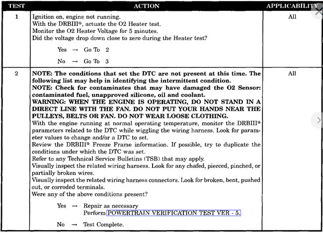

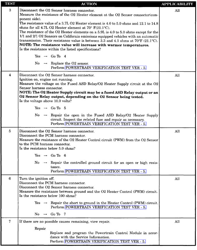

Both of those codes are Oxygen sensor codes. It's likely due to getting the harness wet.
Please let me know a little more of what you have been experiencing.
