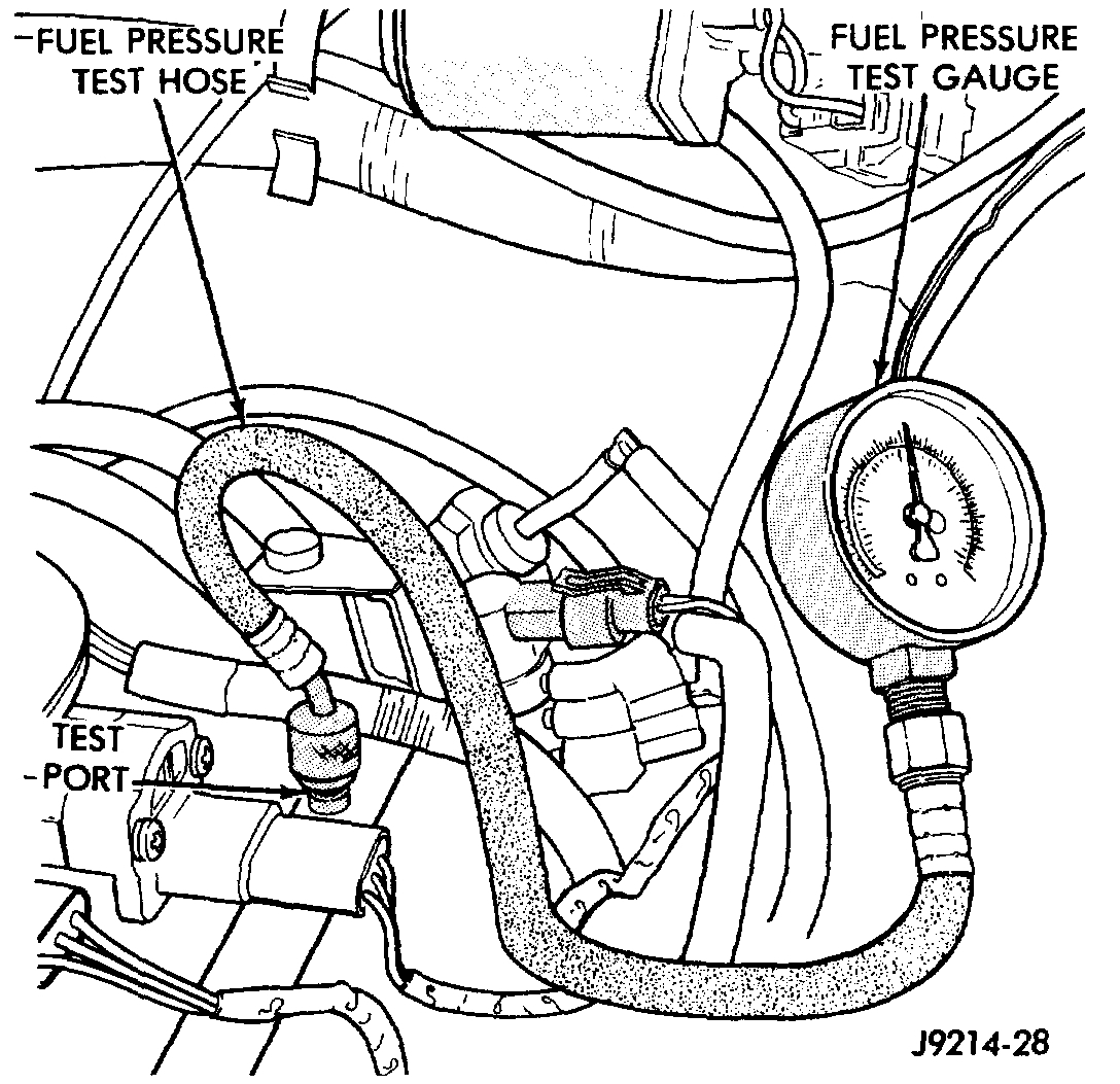

I have to be honest, it does sound like a fuel related issue. Have you actually checked fuel pressure? Also, have you checked for major engine vacuum leaks? Although you don't have a fuel pressure gauge, most parts stores will lend or rent one to you. We really need to confirm it is within spec. Please keep in mind, you may get fuel but if the pressure is too low, the engine won't run or run properly.
Here is a link that shows how to check pressure:

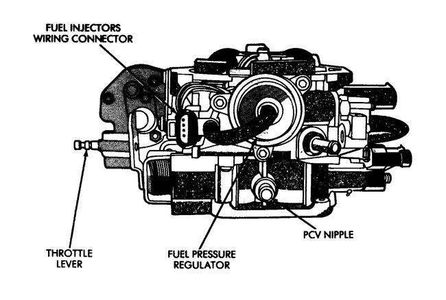

Here are the specific directions for your vehicle. The attached pictures correlate with these directions.
FUEL PRESSURE TEST
Dual Throttle Body Assembly
picture 1
Pressure Regulator And Vacuum Hose
picture 2

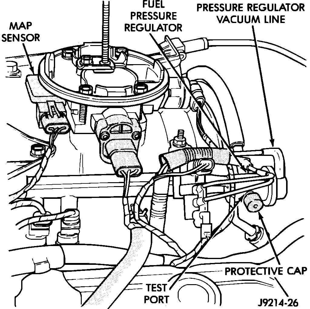

Fuel systems on these vehicles are equipped with a vacuum assisted fuel pressure regulator. With engine at idle speed, system fuel pressure should be approximately 214 kPa (31 psi) with the vacuum line connected to the regulator. With the vacuum line disconnected from the regulator, fuel pressure should be approximately 269 kPa (39 psi). This is 55-69 kPa (8-10 psi) higher.
1. Remove the protective cap at the fuel rail.
Fuel Pressure Test - Typical
picture 3
Connect the 0-414 kPa (0-60 psi) fuel pressure gauge (from Gauge Set 5069) to test port pressure fitting on fuel rail.
2. Note pressure gauge reading. Fuel pressure should be approximately 214 kPa (31 psi) at idle.
3. Disconnect vacuum line at fuel pressure regulator. Note gauge reading. With vacuum line disconnected, fuel pressure should rise to approximately 269 kPa (39 psi).
Fuel pressure should be approximately 55-69 kPa (8-10 psi) higher with vacuum line removed from regulator. If not, inspect pressure regulator vacuum line for leaks, kinks or blockage. If vacuum line checks OK and fuel pressure does not rise approximately 8-10 psi after disconnecting vacuum line, replace fuel pressure regulator.
NOTE: The fuel pressure regulator is not adjustable.
4. If fuel pressure exceeds 45 psi, check fuel return line for kinks or obstructions.

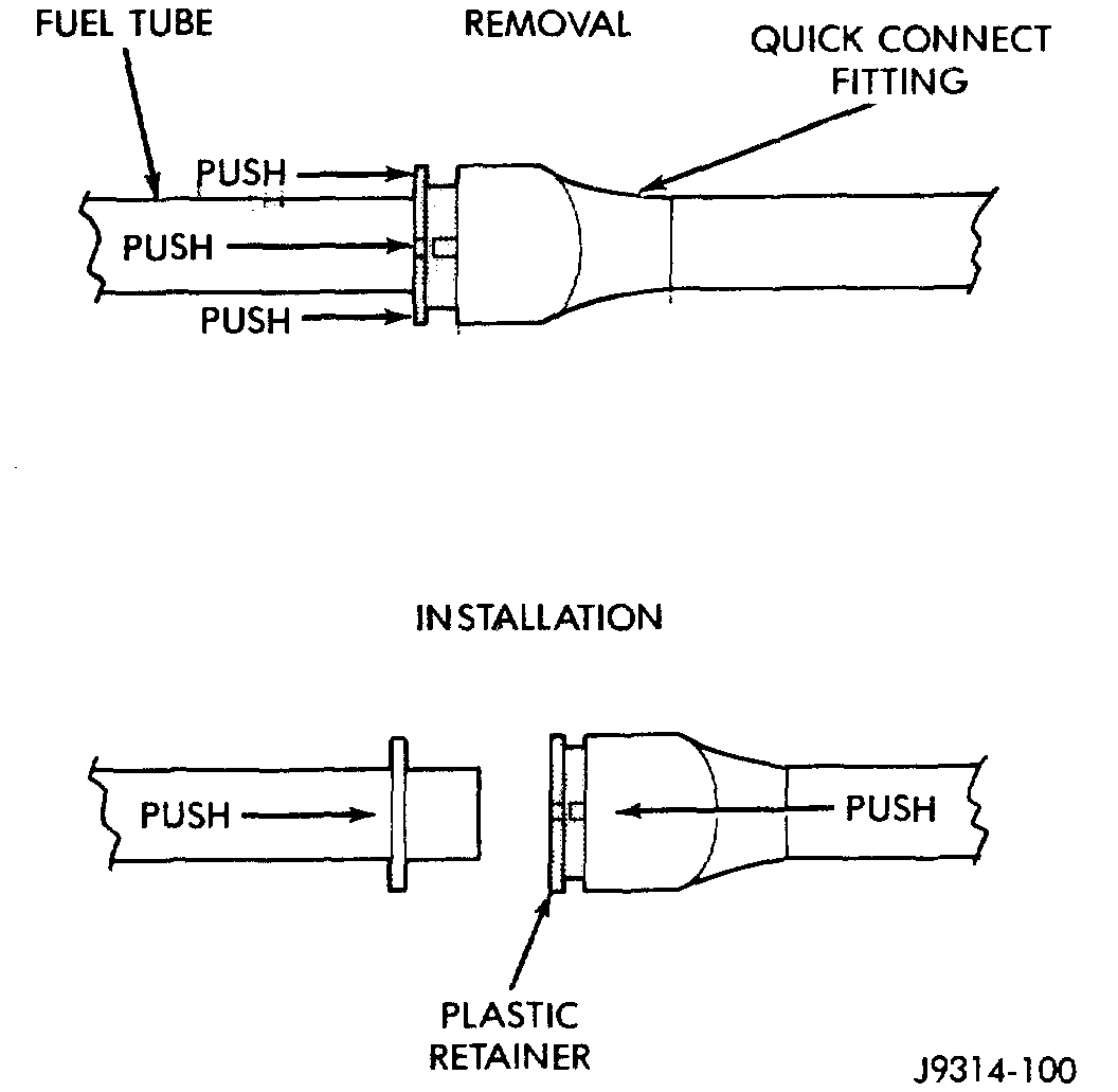

Quick Connect Fittings
picture 4

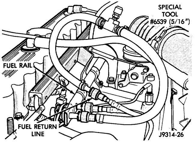

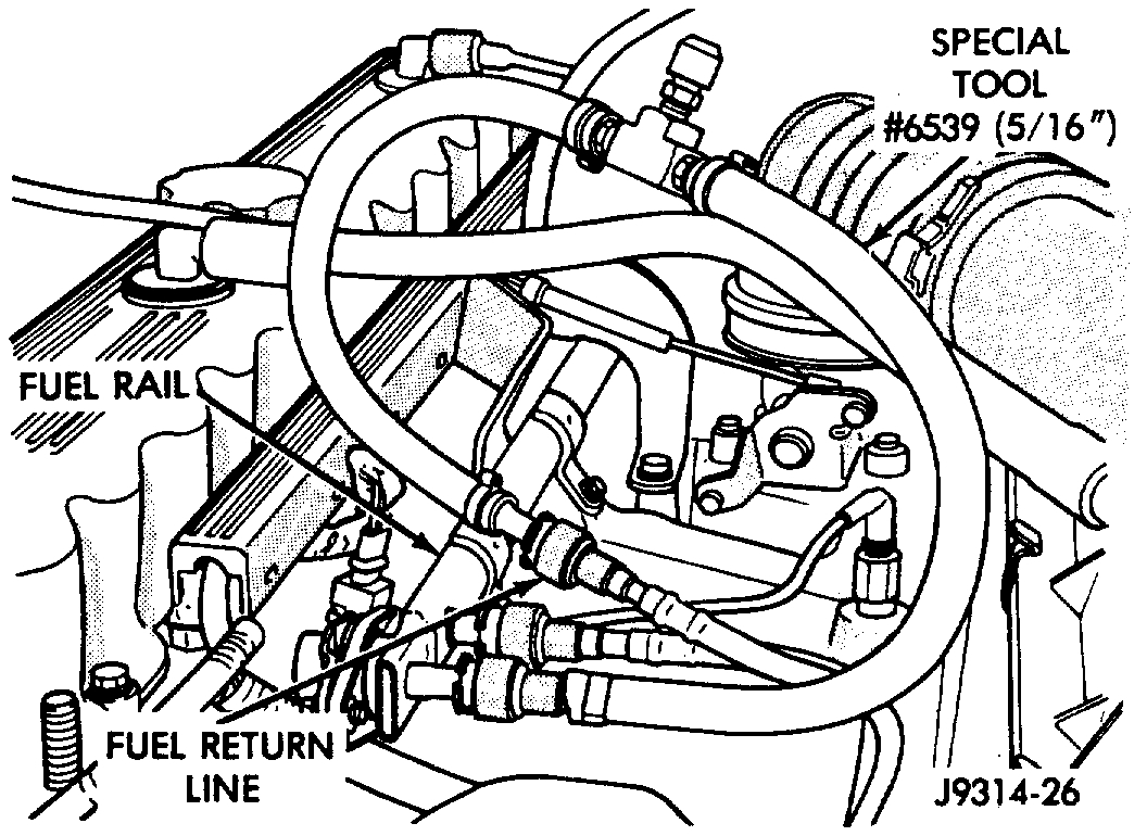

2. Disconnect the 5/16 inch fuel return line quick connect fitting on fuel rail near fuel pressure regulator.
Adapter Tool Connections - Typical
picture 5
Connect Fuel Line (Tube) Pressure Test Adapter Tool number 6539 (5/16 in.) between the disconnected fuel return tube and fuel rail.
Warning: the fuel system pressure in the following test may exceed 100 psi. Before starting test, verify good connections at ends of adapter tool 6539. Be sure tool is locked onto fuel rail and fuel return line. Pull firmly on ends of tool to verify.
3. Using the DRB II or an equivalent scan tool, activate the fuel pump and pressurize the fuel system. Refer to the scan tool manufacturers service manual for scan tool operation.
4. Momentarily pinch the rubber hose portion of adapter tool 6539. Pressure should rise to approximately 75 psi within two (2) seconds. DO NOT pinch hose for longer than five seconds.

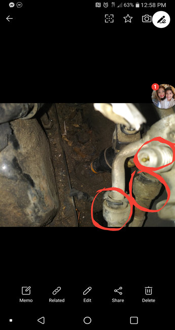

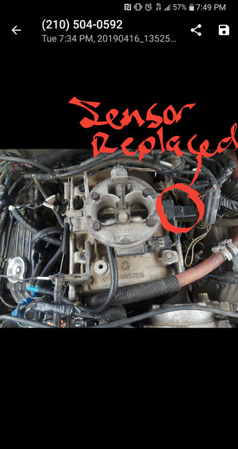

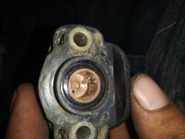

So I tested the fuel pressure and it is all within specs with the vacuum line on and without the vacuum line on. As far as the codes on the truck the only code that is popping up is code number 12. I also took off the sensor that is to the right of the throttle body and as you can see in the picture it is chipped. Could this be the problem?
Tuesday, April 16th, 2019 AT 12:58 PM
  • 110,055 POSTS
Welcome back:

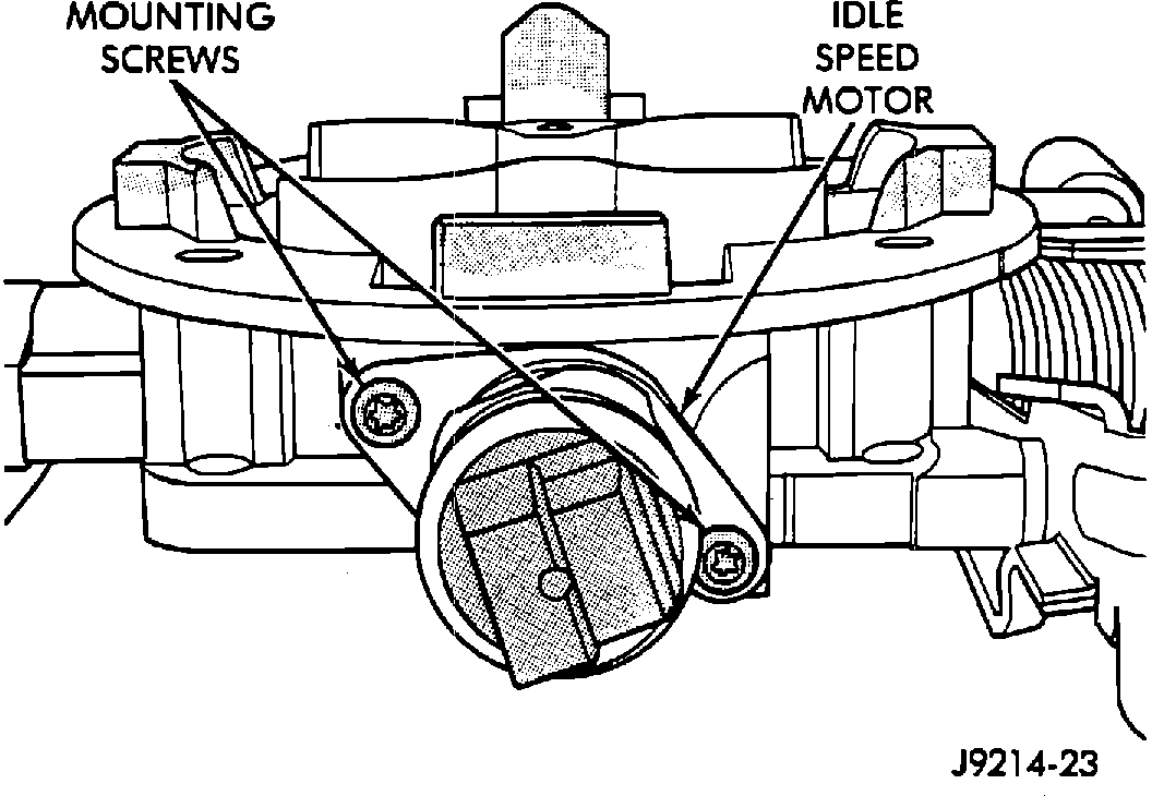

That appears to be the idle air control valve. Yes, it is what maintains engine idle speed. The broken part is a concern. Is it inside the throttle body?
I attached a picture for you to look at. Confirm that it is the part you removed.
Tuesday, April 16th, 2019 AT 4:06 PM

So that sensor was the throttle position sensor I believe. Either way I replaced it and it is still doing the same thing. I am at a loss. Don't know what else to do.
Tuesday, April 16th, 2019 AT 4:10 PM

The picture I sent is the idle air control valve. Are you able to get it to run if you lightly hold your foot on the throttle? If not, I need you to recheck for spark. Here is a link:
If there is no spark or weak spark, the distributor pick up coil is my primary suspect. It is located in the distributor itself.
Also, see if it will start for a couple seconds using starting fluid.

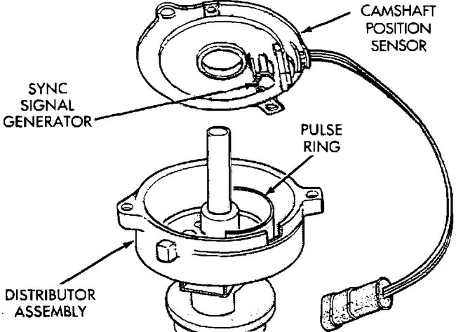

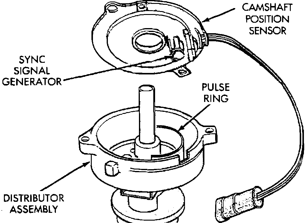

Also, I need you to open up the distributor and check the pick up coil (referred to as a cam sensor in the manual). See if there is rust or dirt build up on the pulse ring or if the sensor itself. If it appears to be in poor condition, replace it and clean the pulse ring with emery cloth. (see picture 1)
Next, if that is good and you feel, I need you to get a test light and check engine timing to determine if it is off. This engine came from the factory without any type of timing chain tensioner. The timing chains stretch, usually you will hear it make noise, and they can jump time. The backfire has me questioning timing or the sensor I mentioned. I had a 90 with the same engine and when I decided to replace the chain because of noise, they offered a tensioner as optional. It never made a sound after that.

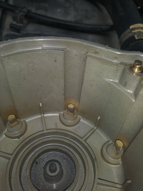

So I did open the distributor the pick up coil looks good but I did attach a picture of the distributor cap which looks worn to me (almost two years old along with the whole distributor assembly).
Aldo attached a picture of the sensor I replaced which is the throttle body sensor.
Wednesday, April 17th, 2019 AT 5:52 PM
  • 110,055 POSTS
The cap does look worn, but I don't think that is the problem unless it is cracked. However, that may cause a backfire or misfire, but normally, not a stall. Try the test with the timing light. If spark is an issue, you will see an erratic flash. At that point, we will need to check the coil as well as the sensor I mentioned. Also, it will give us a good idea if timing may have jumped.

Okay, cool. I will try the timing and the sensor you were talking about is which one just to be clear? Pick up coil looked good. Is there another coil I should check?
Wednesday, April 17th, 2019 AT 6:18 PM
  • 110,055 POSTS
The pick up coil is referred to as a cam sensor in the manual. It is the one under the plastic cover inside the distributor. I forgot to attach the picture, so here it is.
