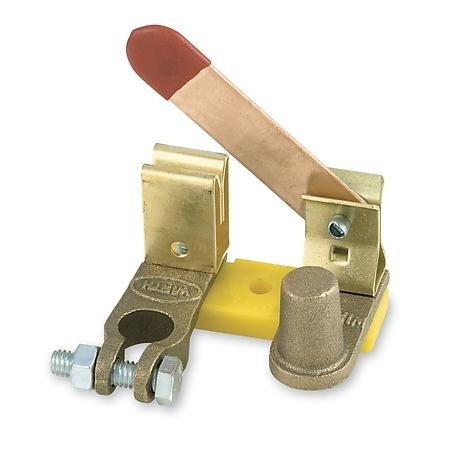

One of these below might help during diagnosis or in the future as well.
