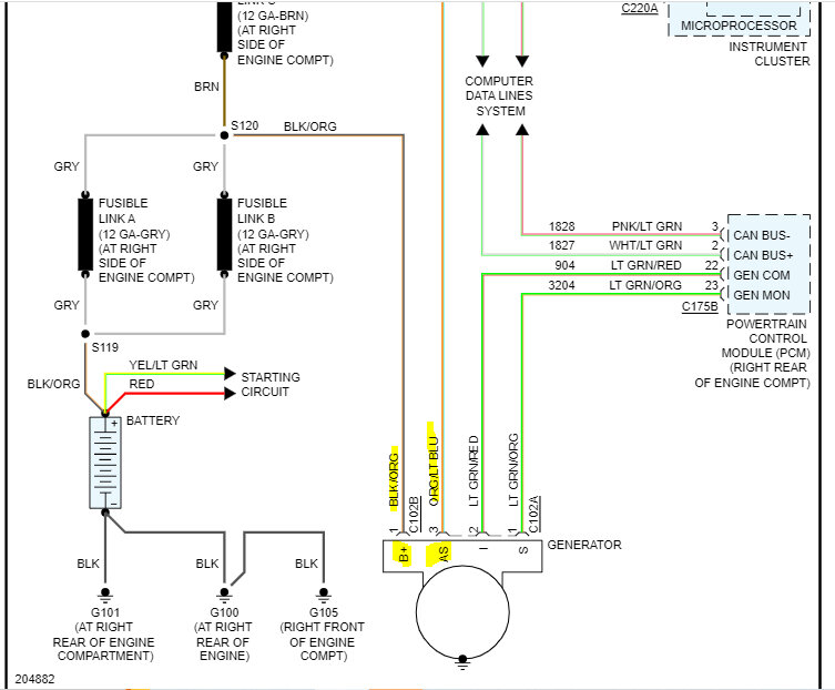

While driving all windows up air conditioning on 4 I noticed the output was weak, then all power shut off inside, instrument panel, radio, windows, everything. I parked turned the engine off. Got a jump but couldn’t get it out of park. Installed a new battery drove it home. Even with new battery, battery light kept coming on only while in idle mode, stop lights or in park ect. A couple of days went by and my son replaced the alternator because of the battery light being on. Now the brand-new battery is showing it’s dead, jumping it didn’t work so we are charging it overnight to see if it will start in the morning. A couple hours into charging battery it seems to be taking a charge but I’m still going to wait till morning to see if it’s going to start. I’ve never had electrical issues before and I keep up on all maintenance. Wondering if it could be as simple as a relay?

It sounds like even the new alternator isn't charging. We may not be getting power to it.

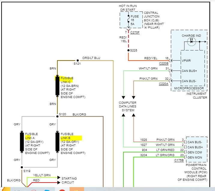

I attached the wiring schematic for the charging system below so that you would have a reference. Here is what I need you to do.
At the alternator, there will be a black wire with an orange tracer. Also, there will be an orange wire with a light blue tracer. Check both of them for power. They should have battery voltage.
Let me know what you find.
Sep 22, 2023 at 4:21 PM
SANTACRUZLOCAL
So, the alternator was fine, a friend looked at it and the connectors to the battery were not tightened enough. It started right up once he did that. He also checked the amps and voltage on both battery and alternator and he said they seem to be right where they should be so thank you, I’m just happy my truck is back on the road.
