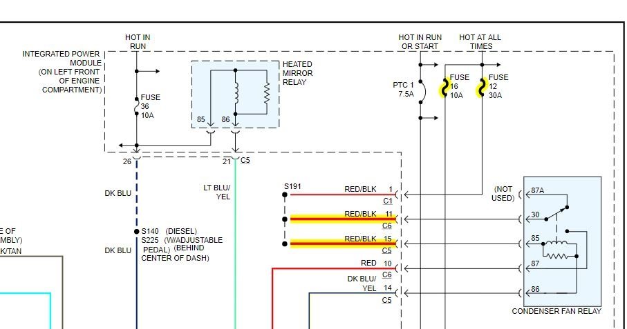

I was told I had a bad A/C condenser fan relay. So I bought one from AutoZone and replaced the bad one, but now my truck just cranks over and won’t start. I tried putting the old relay back in but no luck. Any help is appreciated.
Wednesday, August 21st, 2019 AT 3:06 PM
18 Replies
  • 52,797 POSTS
Good evening,
Check all your fuses with a test light for power on both sides. Do not do a visual test, do the power test.
Chances are you either have a bad relay or you put it in with the wrong terminal alignment and it shorted and blew a fuse.

I tested them with a light like you said to. I have an ammeter but I am not sure how to use it to test the fuses.
Thursday, August 22nd, 2019 AT 2:52 PM
  • 52,797 POSTS
Are these the 2 fuses you checked with a test light?
Thursday, August 22nd, 2019 AT 3:01 PM
DAVIDRAMBO2
  • 10 POSTS
Yes, both of them light up.

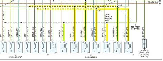

  • 52,797 POSTS
No worries.
Can you check for voltage to the coils? Do you have a voltmeter to check this?
I attached a diagram for you. Check the highlighted wires for power with the key on.
