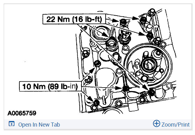

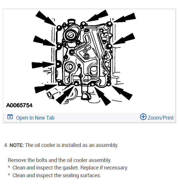

I replaced the oil cooler and EGR cooler on my truck because the oil cooler was plugged up. I put everything back together and now the truck won’t start it cranks over strong but won’t start.

It cranks over strong. I replaced the diesel filter, oil filter and air filter with a Motorcraft filter. No lights are on or flashing. I connected my code reader and there weren’t any codes. I checked the ICP pressure while cranking and it’s at 1,100 PSI.

I sprayed a little starting fluid and it started for a second and shut off.
Jul 13, 2024 at 10:54 AM
  • 55,676 POSTS

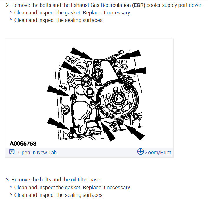

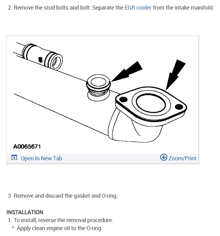

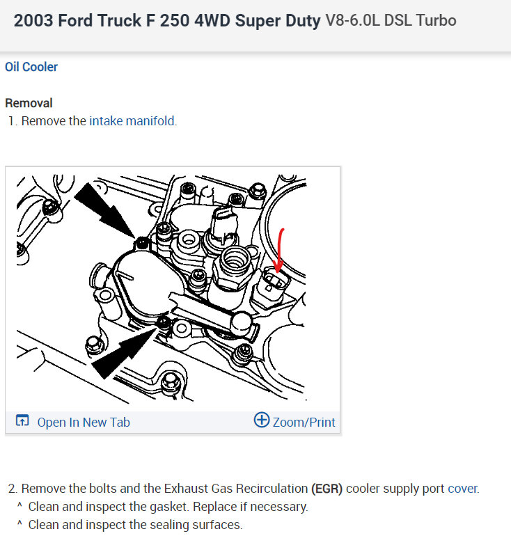

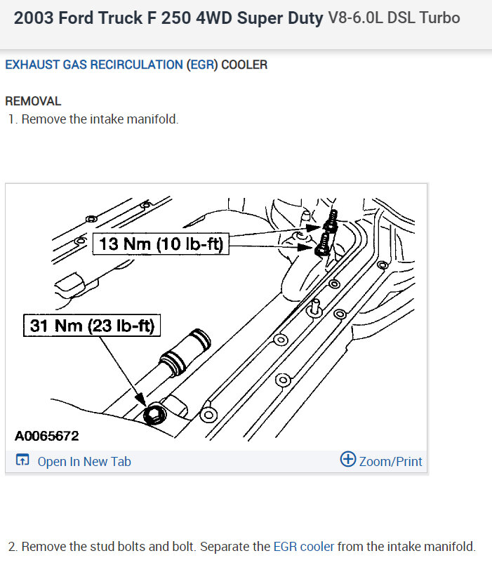

That is a good sign it means the engine is okay, now that the engine ran for a little bit let's re-run the codes to see what is stored. Also, if you removed any grounds or sensor connector lets recheck the connectors, it must be something you did while doing the repair if the engine run before. I have marked the sensor I want you to check in the images below and it shows how the job is done so we can be on the same page.
