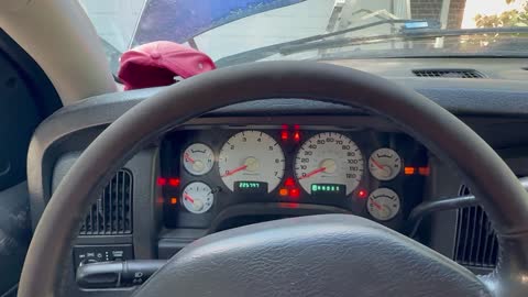

Truck quit running while driving. I have a full tank of fuel. Overhead console reads (-)for dte fuel gauge pegged on empty. The red light for the security system is on. Only have 1key grey. Remote entry fob. It will crank but won’t start. I replaced the fuel pump.

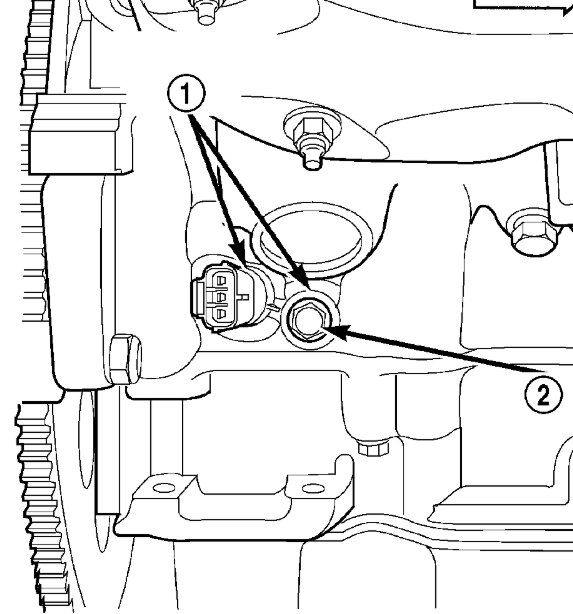

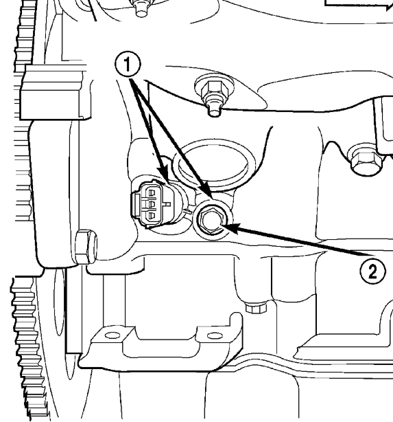

It sounds like the crankshaft angle sensor has gone out. But to be sure it is the ignition system causing the issue, let's check the system for spark, here is a video to help you:
https://www.youtube.com/watch?v=lXLJbuAZ4CE&t
Also, have does the engine sound while cranking normal? Can you upload a short video of the engine cranking so I can hear it? That way I can tell if the engine is in good shape or not. Here is the location of the sensor. Check out the images (below). Please upload a video in your response.

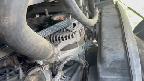

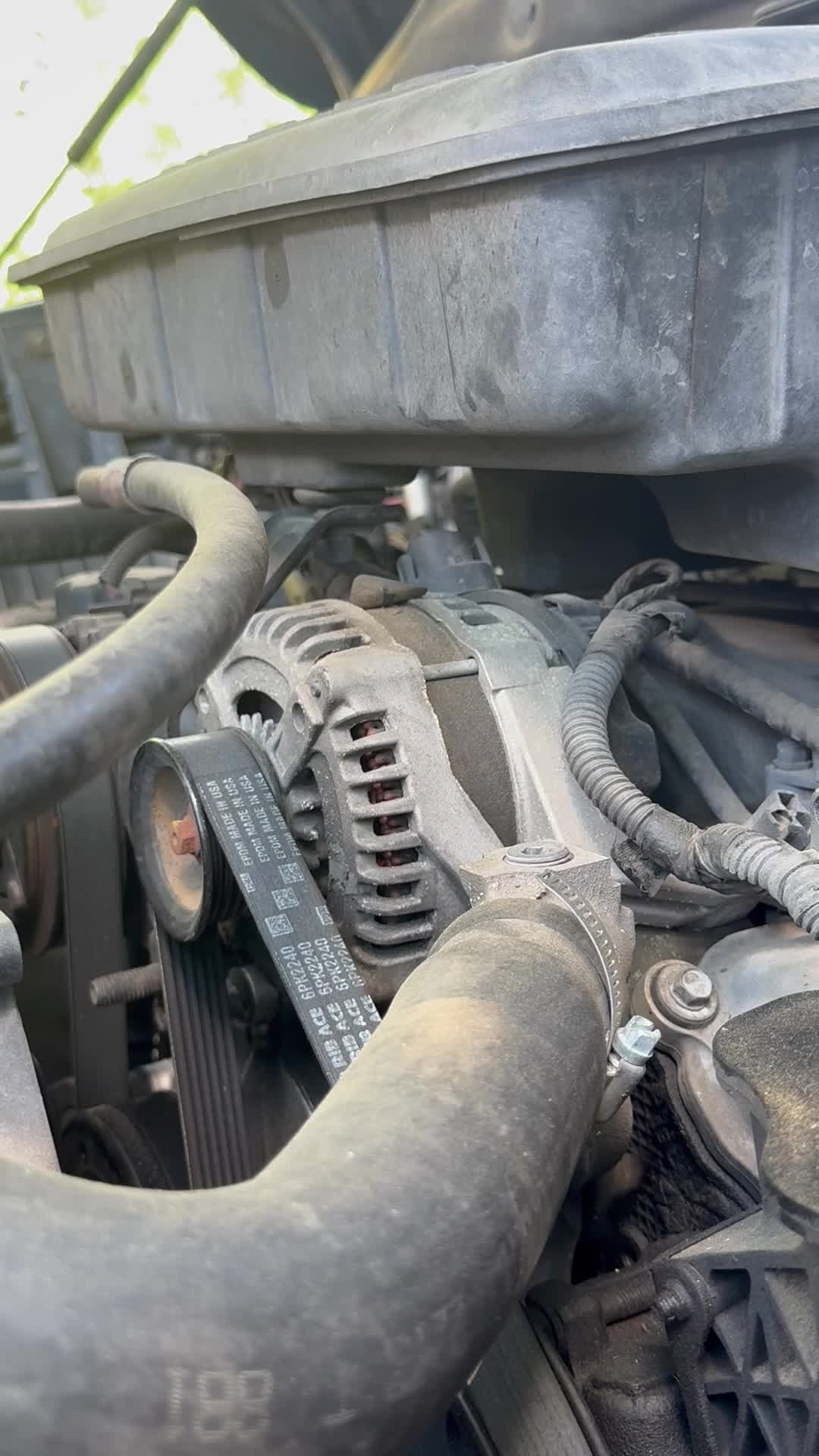

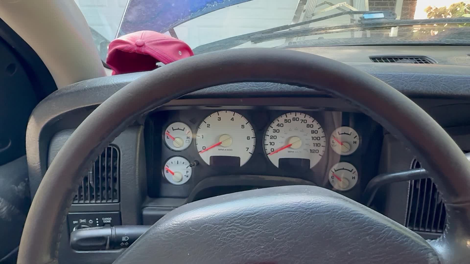

I was just now able to get some videos any suggestions would be greatly appreciated thanks flipperjw

I am sorry the site has not been updated so I cant see the video because of the new file format from apple, can you please the file setting and try again?
