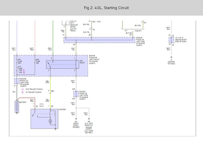

has no codes. turns over great but once you hit clear codes it starts right up and runs great.
Jun 22, 2019 at 8:13 AM
SCGRANTURISMO
  • CAR REPAIR CONTRIBUTOR
  • 4,897 POSTS

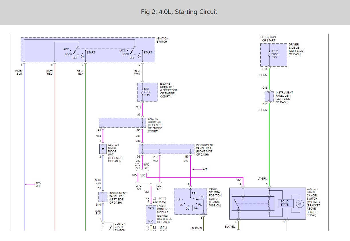

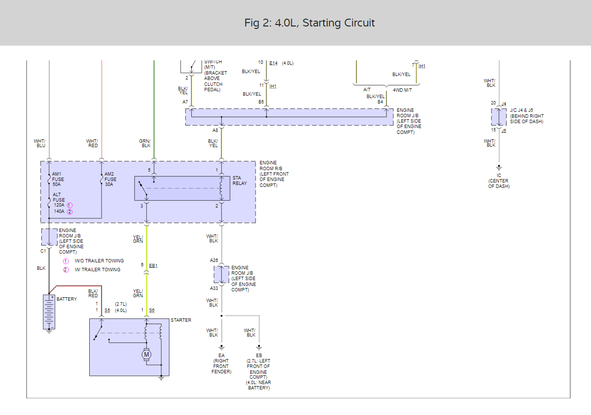

If it has no Direct Trouble Codes (DTC)(s) present, then what do you mean when hit "clear codes" it starts up? In the diagrams down below I have sent you a wiring diagram of your vehicle's starting circuit. Nowhere is there anything about "clearing codes". Is your vehicle having a starting issue? Please get back to us and we can go from there.
Thanks,
Alex
2CarPros
