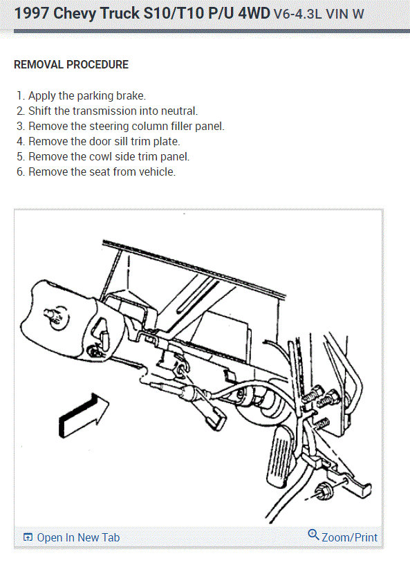

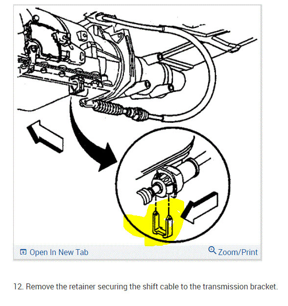

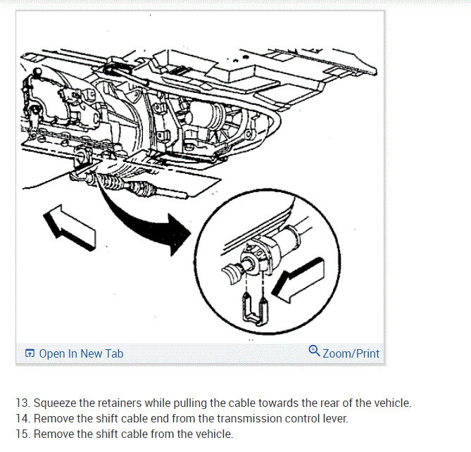

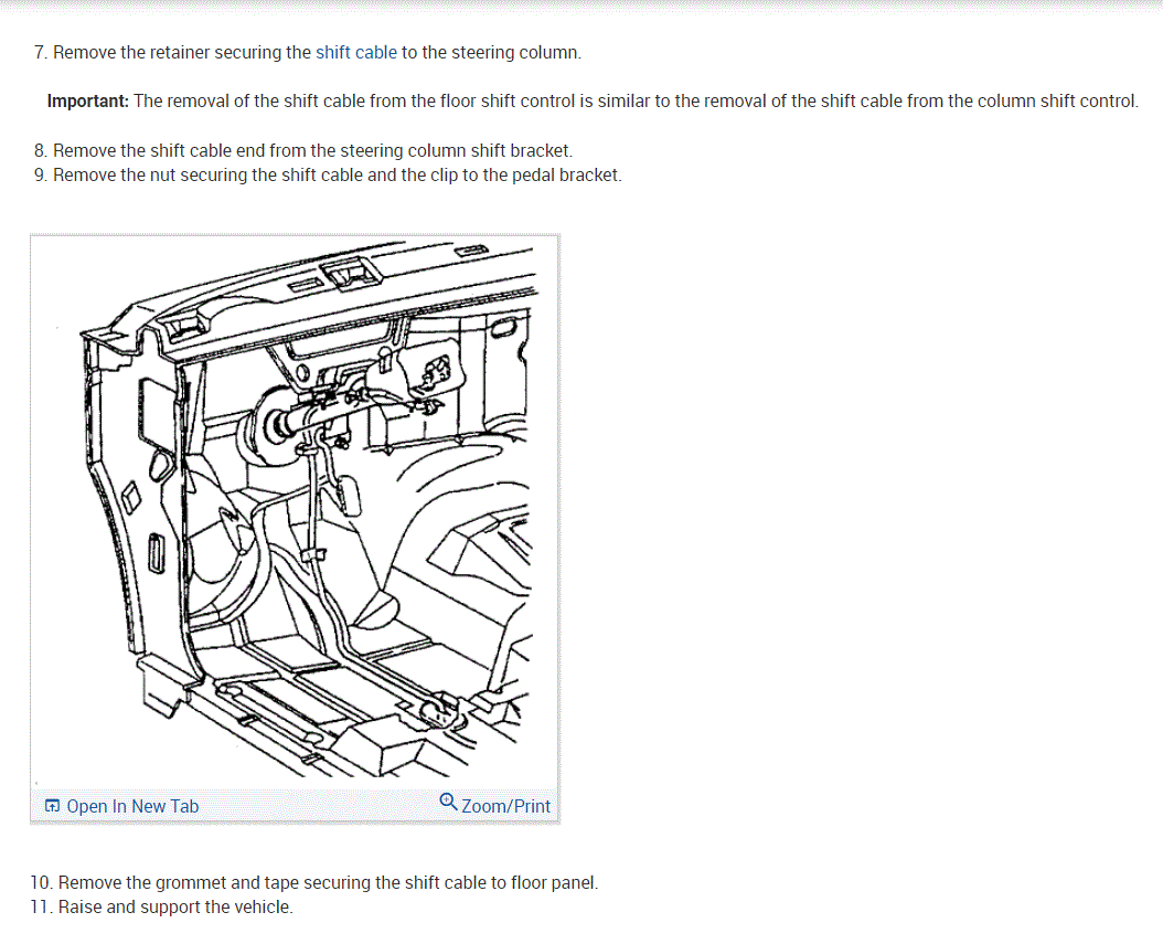

I attached directions below for the removal and replacement of the shift cable. Take a look through them to make sure nothing was missed or done incorrectly.
See pics below. Also, let me know if this is a floor or column shift.
