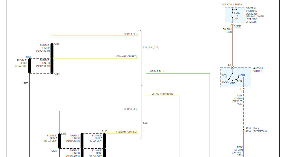

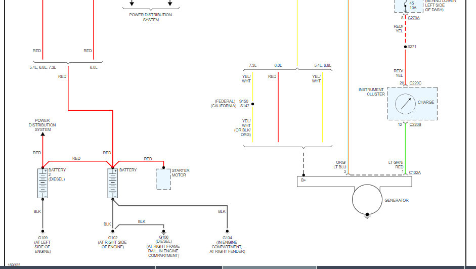

My truck wouldn’t start this morning. Friend jumped it, it started acting weird as I drove, pulled over to a Walmart. It was acting like it was about to shut off again (gas gauge kept going towards empty and bouncing, was full of gas). I kept revving it to keep it going as my wife ran inside Walmart. Truck ended up shutting off. Had tow company attempt a jump start. It started up 3 times but would act up then shut off. Ended up getting towed. Nearest diesel shop can’t see my truck for 3 more weeks. Yikes! Please help.
Nov 27, 2019 at 4:53 AM
Good afternoon,
You have low voltage. That is the reason it wont run right.
https://www.2carpros.com/articles/how-to-charge-your-car-battery
If the alternator is not working, it will try to run off the battery. If the battery is less than 12.2 volts, it will not run correctly.
I would charge the batteries up to 12.6 volts.
Then start the truck and check the voltage at the battery with it running.
Let me know the results.
