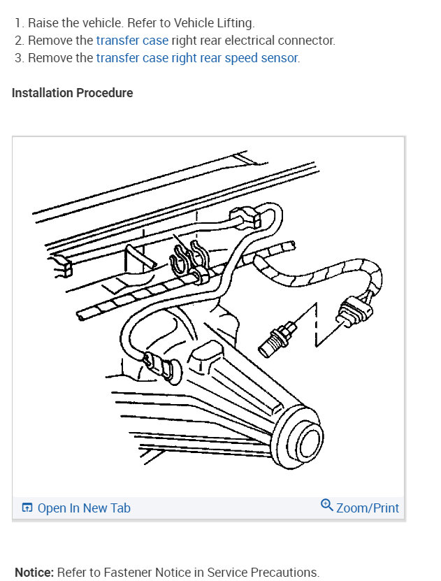

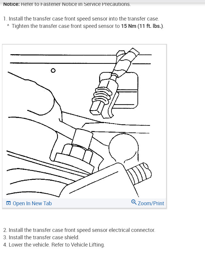

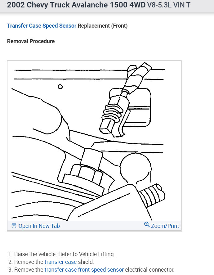

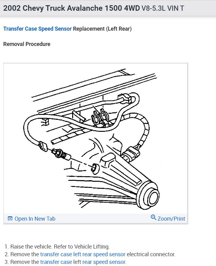

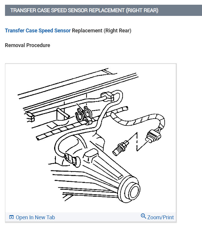

Did they run codes on the truck? here is a guide that will help so we can what's going on:

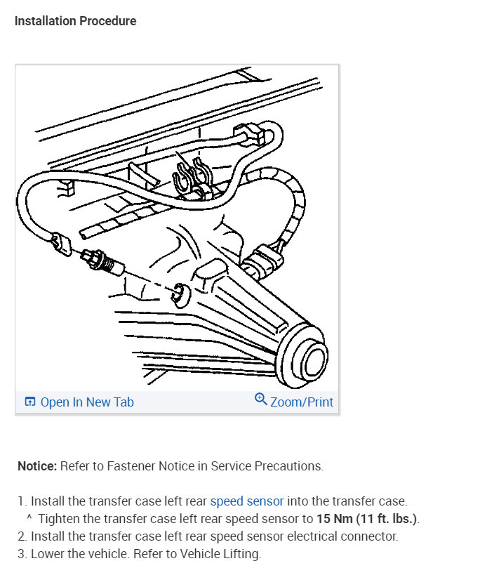

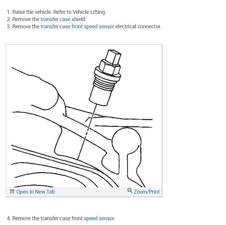

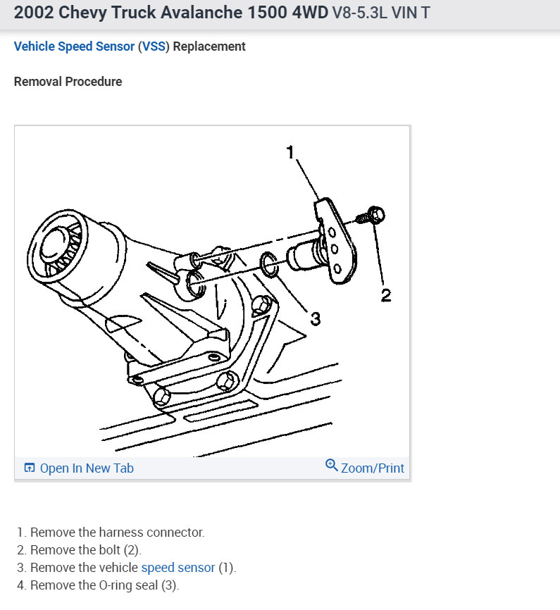

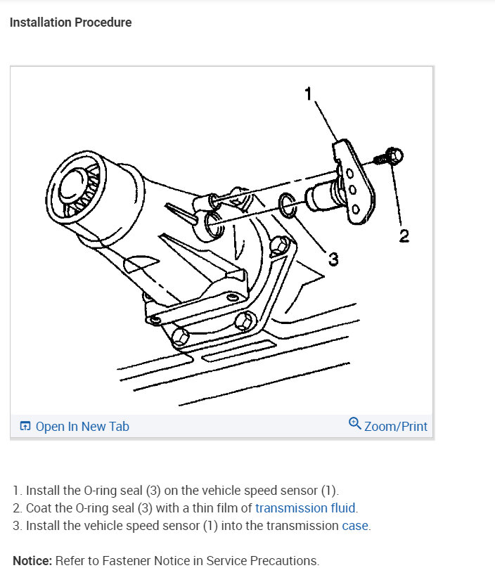

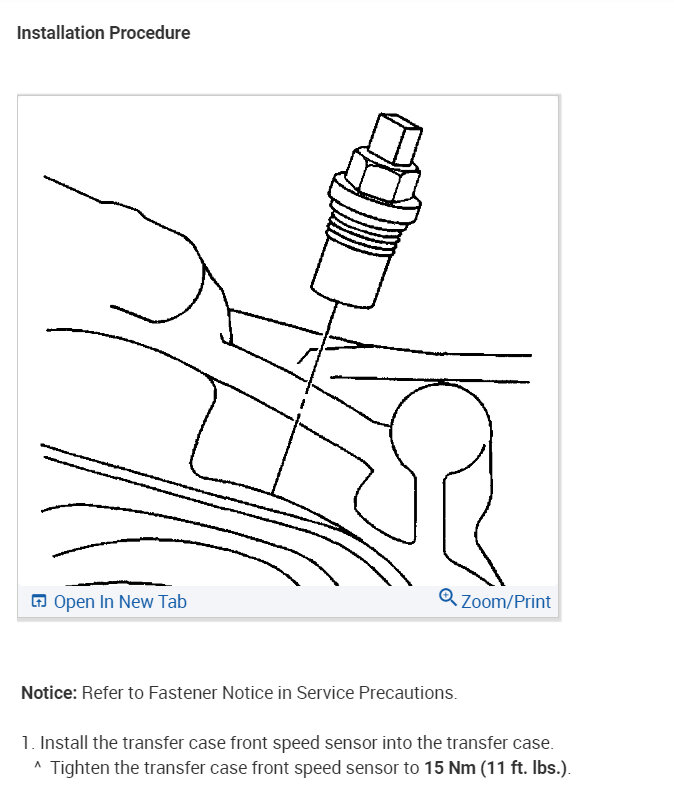

Since this truck is 4WD that are four VSS sensors, one in the transmission and the others in the transferase, did you replace both of them? Here are the locations, Check out the images (below). Please let us know how it goes
Aug 1, 2023 at 6:28 AM

I would clear the codes and replace the remainder of the sensors; the speedometer must work for the transmission to shift correctly. Please let me know what happens.
