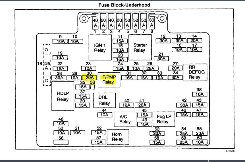

My SUV listed above had some issues cranking for about 2 weeks and finally it wouldn't crank at all. I got a used fuel pump and it worked fine for a week. Now it won't crank. It's firing but not getting fuel. What could be the problem to check? Also the gas gauge is off and the needle is off the charts in between the two pegs down south between the empty and full. The truck also won't drive in third year only second and first.

Can you hear the fuel pump prime when you first turn the key to the run position? Have you checked both the fuse and fuel pump relay?
See picture 1. It is the under hood fuse box. I highlighted what needs checked first. Also, make sure there is power to the relay.
