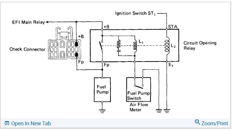

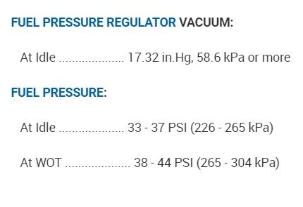

okay, have you done a fuel pressure test? i'm going to assume you have no fuel pressure at this point since you just put a new pump in, but I would do a pressure test to start with. Here are the specs for pressure. If no pressure then the pump needs to be checked for power. You may have a bad fuel pump relay, Toyota calls it a "Circuit opening relay".

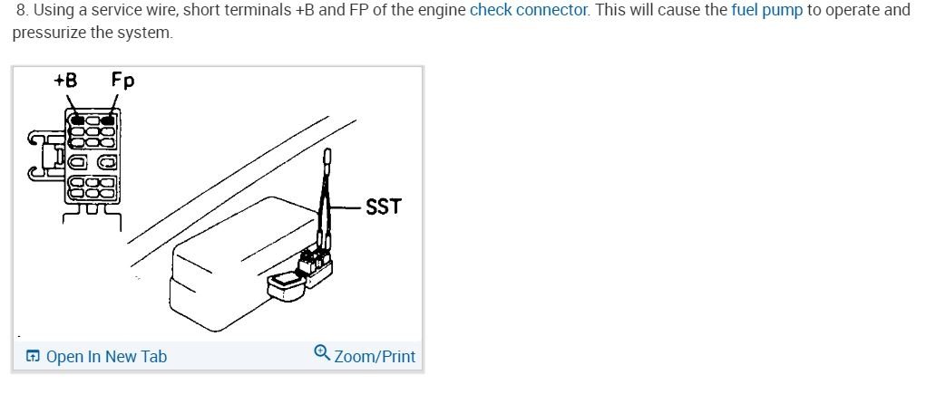

In this picture, it shows what terminals you can jump to activate the fuel pump, this can aid in checking for pressure. It also bypasses the Circuit Opening Relay, so you can rule that out as a problem. Power comes from the EFI relay next. Okay, so you're saying you have no injector pulse, this can be caused by a number of things. Such as no signal from from the pick up in the distributor, a wiring issue, a bad ECM. Lets see if you're getting any activity from the Injectors first.

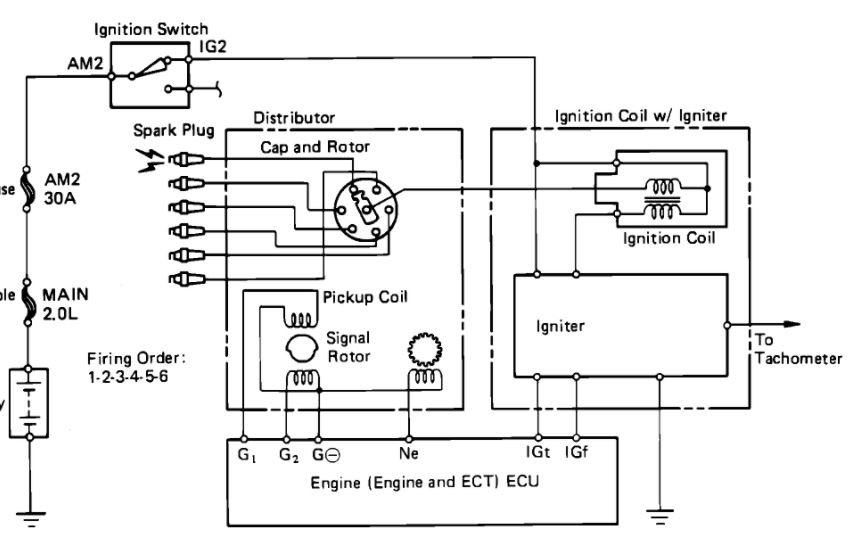

where is the crankshaft angle sensor located on Toyota pickup?
Nov 17, 2020 at 2:17 AM
4DRTOM
  • 467 POSTS
Your crank position sensor should be located on the front of the motor behind the timing cover. You should see two small wire leading down behind the harmonic balancer on the front of the motor. i have attached diagram of your ignition system hopefully it will help you out.
