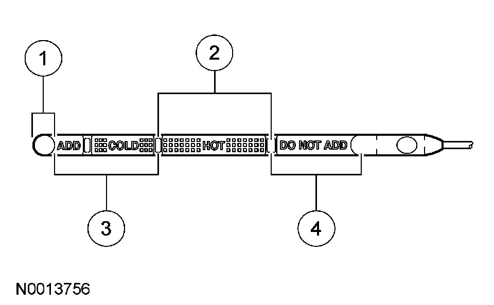

SUV drives fine until I reach 20 mph. When I try to accelerate, car will rev up but won't increase in speed. No check engine light came on. I was a block from home and immediately turned around and brought it home. Any suggestions?

It sounds like you lost second gear. What I suggest is to first confirm the transmission fluid is clean and full. If it is, there are a few different things that can cause this. Things such a low transmission line pressure, a bad or worn clutch pack, or even a failed transmission control module (TCM).

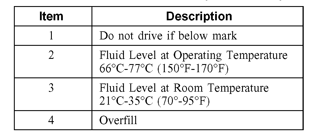

Check the fluid first. Here are the directions on doing this. The attached two pictures attached correlate with these directions.

Transmission Fluid Level Check
CAUTION: The vehicle should not be driven if the fluid level indicator shows the fluid below the DO NOT DRIVE mark or internal failure could result.
NOTE: If vehicle has been operated for an extended period of time at highway speeds, in city traffic, in hot weather or when pulling a trailer, the fluid needs to cool down to obtain an accurate reading.
NOTE: The fluid level reading on the indicator will differ from operating and ambient temperatures. The correct reading should be within the normal operating temperature range.
Under normal circumstances, the fluid level should be checked during normal maintenance. If the transmission starts to slip, shifts slowly or has signs of fluid leaking, the fluid level should be checked.
1. With the transmission in (P) PARK, the engine at idle, foot pressed on the brake, move the range selector lever through each gear and allow engagement of each gear. Place the range selector lever in the PARK position.
2. Wipe the fluid level indicator cap and remove the indicator.
3. Wipe the indicator with a clean cloth.
Picture 1
Picture 2
4. Install the indicator back in the filler tube until it is fully seated, then remove the indicator.
The fluid level should be within the normal operating temperature range.
