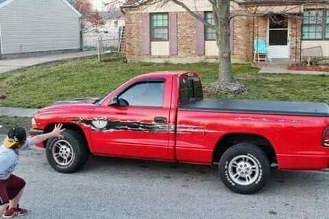

Done a little digging and it is my clutch. When clutches go out the clutch plate starts wearing down and over time or use if not noticed right off hand the plate starts to give and then there is no grab for the transmission to change or keep gears. So when the plate goes it makes the RPM's shoot up from not being able to grab the gears. Which is why my acceleration was slow and my RPM's were high. I got under neath my truck and found pieces of fiber. Which i then knew it had to be the clutch. But the reason the clutch felt fine is because the clutch cable is still intact. But the clutch doesn't have enough to grab the gear. Thank you so much anyways. Guess it took a little bit more digging! Below is an older picture of the Dodge! Thanks again!
