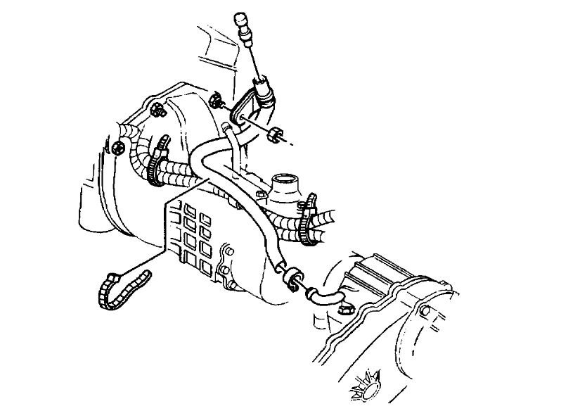

Please help.. One day driving down the highway heard a loud scraping sound and all of sudden the truck would not stay in gear.. I have changed fluid, filter, shift solenoid, neutral safety switch, new shift cable. when i pulled my pan off there was a big shard of metal in the pan... The parking pawl had broken off... So i replaced that as well... I pull off the valve body and cleaned everything really good and at first it wanted to go in gear then nothing. Except only in 4 wheel low then it drives fine except you can't drive it to well in 4 wheel low on dry pavement.
I also replaced the actuator... Also only replaced one of the shift solenoids.. If anyone could help id truly appreciate it.

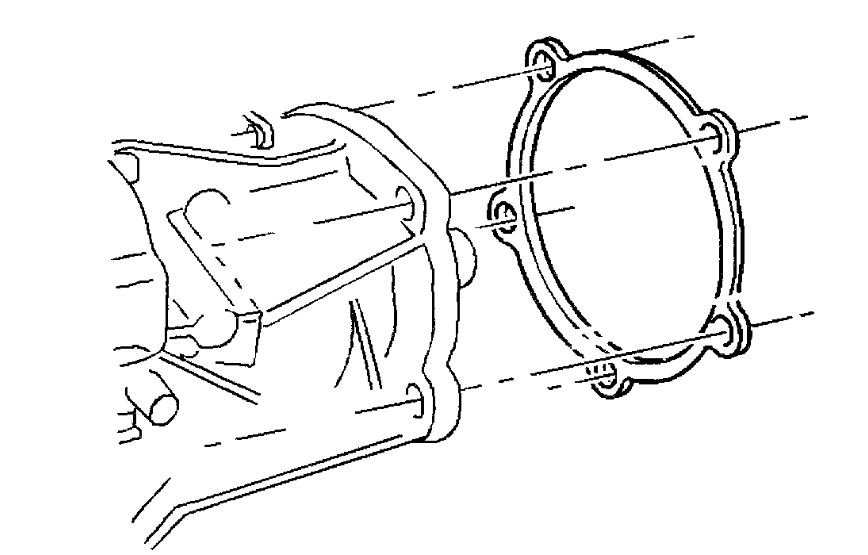

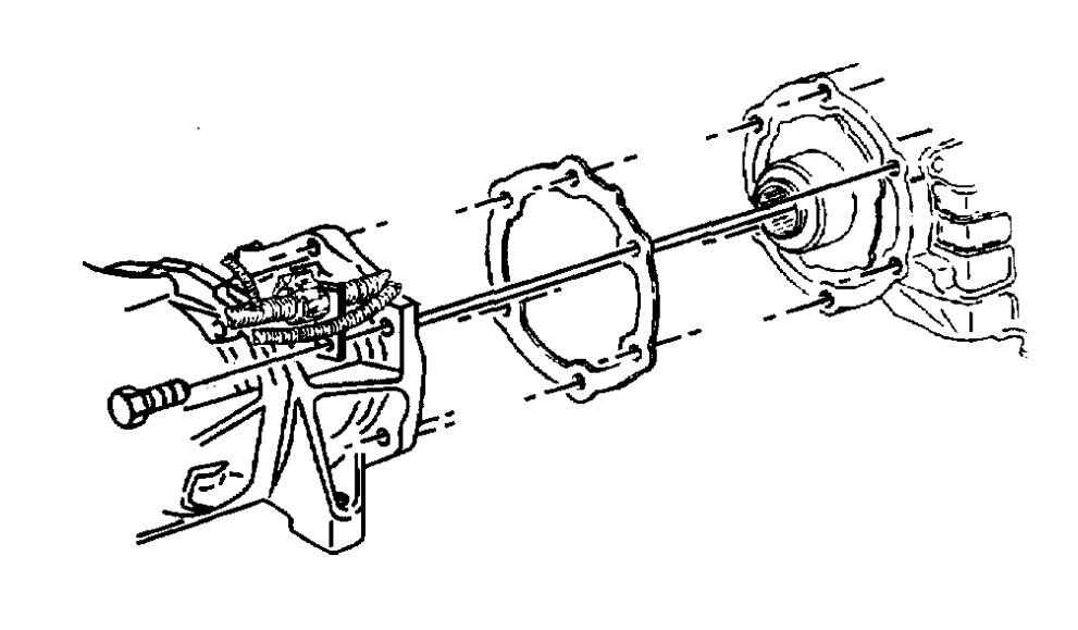

Okay, this sounds like you have a failed transfer case. In 2 wheel drive there is a failure in the case, not transferring power to the wheels.
REMOVAL PROCEDURE
1. Raise and support the vehicle. Refer to Vehicle Lift Points.
2. Remove the transfer case shield. Refer to Shield Replacement.
3. Remove the front propeller shaft. Refer to Propeller Shaft Replacement-Two-Piece in Propeller Shaft.
4. Remove the rear propeller shaft. Refer to Propeller Shaft Replacement (System Balanced Assembly) in Propeller Shaft.
5. Disconnect the vehicle speed sensor electrical connector.
6. Disconnect the wiring harness from the transfer case.

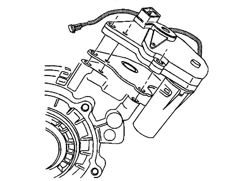

7. Remove the transfer case motor/Encoder.
Support the transfer case with a jack.

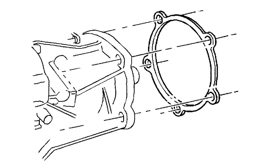

8. Remove the bolts securing the transfer case to the transmission adapter.
9. Remove the gasket.
Jan 6, 2020 at 2:38 AM

I didn't think my transmission had an encoder motor? I could not find it on it. Because i had bought one but i thought since my 4 wheel drive is manual shift that it did not have an encoder motor.
Jan 6, 2020 at 3:36 AM
The transfer case has the encoder motor, not the transmission.
This is not a transmission issue, it is a transfer case issue.
