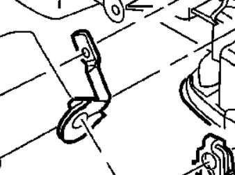

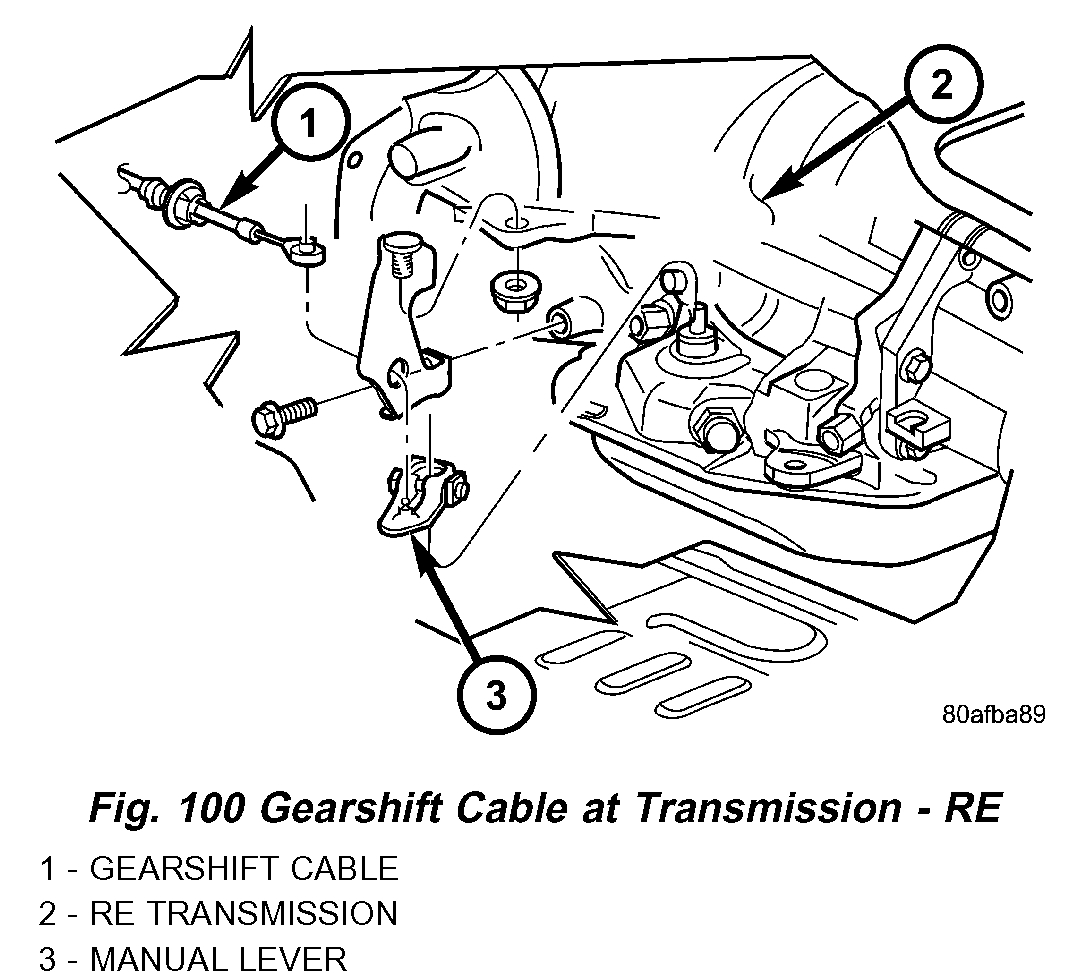

I got stuck in the ditch and when I want to put it in park it would not go in park. But if I put in reverse I can shit the truck off and remove the key. I just have to put it neutral to crank it up.
Feb 16, 2019 at 6:57 AM
  • 110,244 POSTS
Since it was stuck in a ditch, my fist suspect is the shifter cable was damage or the shift lever was bent. What I am going to provide are the directions for replacing the shifter cable that runs from in the truck to the transmission. However, before you replace it, secure the vehicle so it is safe to crawl under it and check the cable, the mount (which is easy to bend) and the lever. If you look at the first picture in the directions, it shows all three. My guess is that the mount that holds the cable has been bent. The result is the cable doesn't retract far enough to actually reach park. Do this first.

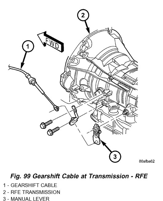

3. Disengage cable eyelet at transmission shift lever and pull cable adjuster out of mounting bracket (Fig. 99) or (Fig. 100).

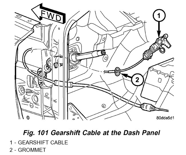

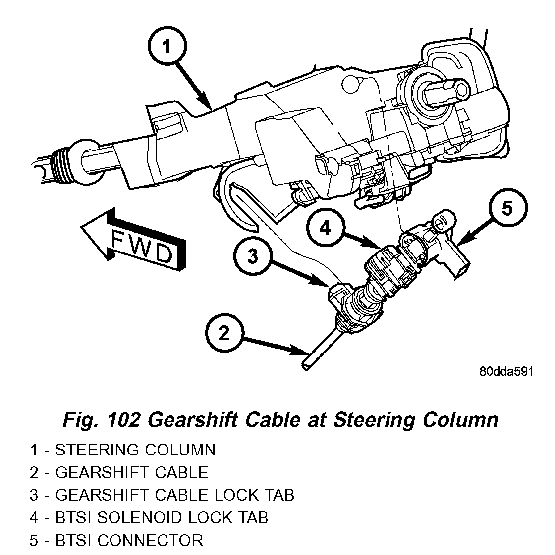

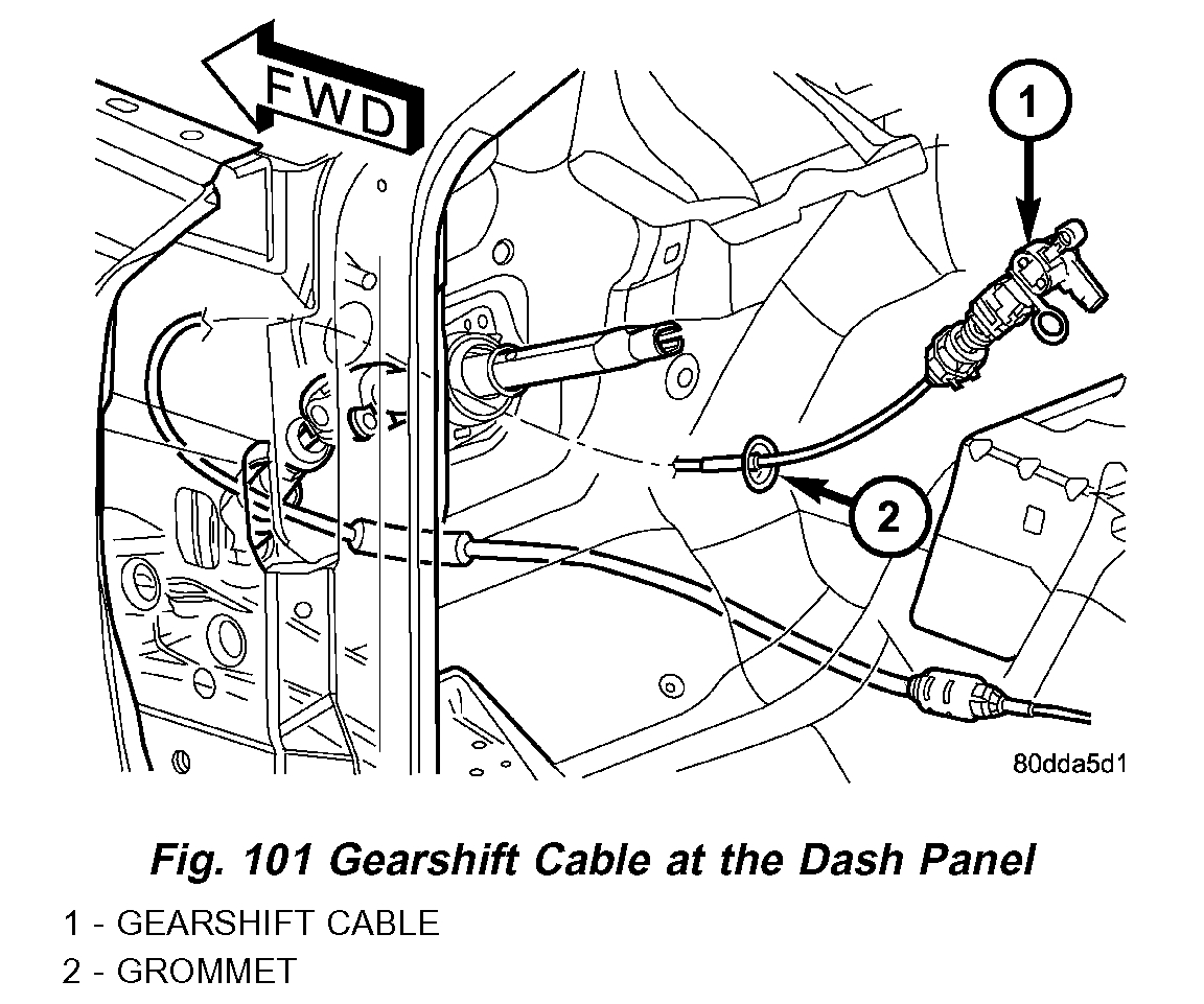

5. Remove the dash panel insulation pad as necessary to access the gearshift cable grommet (Fig. 101).
6. Remove grommet from the dash panel.

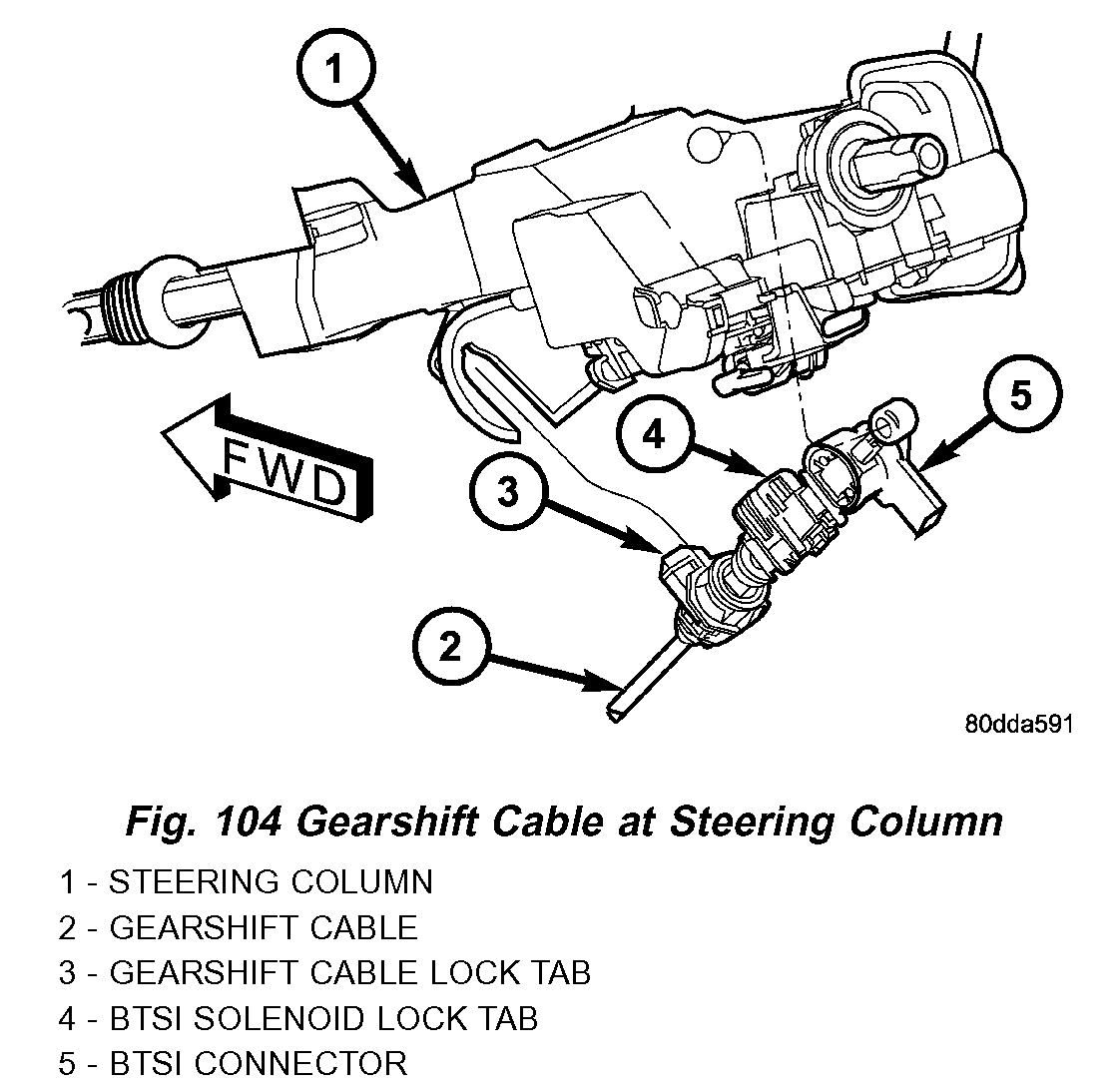

7. Remove any steering column trim necessary to access the gearshift cable and BTSI mechanism.
8. Disconnect the BTSI wiring connector.
Picture 4
9. Disconnect cable at lower column bracket and shift lever pin and pull the cable through the dash panel opening into the vehicle (Fig. 102).

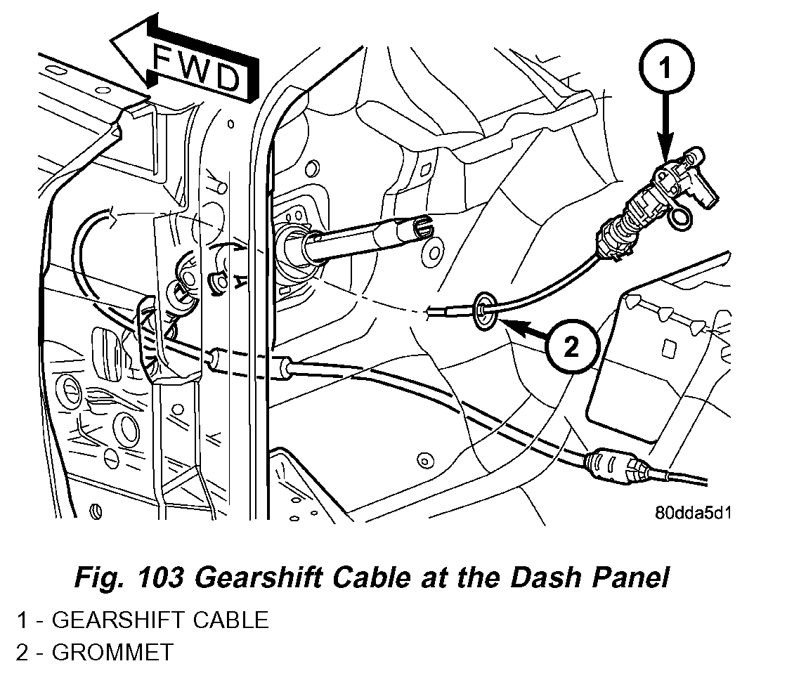

1. Route the transmission end of the gearshift cable through the opening in the dash panel (Fig. 103).
2. Seat the cable grommet into the dash panel opening.

Feb 16, 2019 at 1:48 PM
ROBERT SCRUGGS
The truck reads reverse on the dash, but yet the gear shift is all the way up.
Feb 18, 2019 at 2:43 AM
  • 110,244 POSTS
Welcome back:
I have a feeling you bent the mount that holds the cable by the transmission. If you look at picture 1, it's the metal mount between the cable and the shift lever. If it is bent, the cable itself is not positioned right and causing the problem.
Let me know what you find.

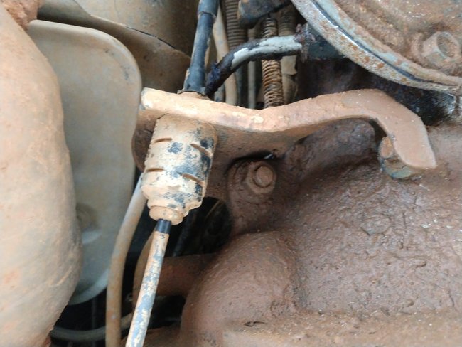

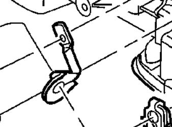

ROBERT SCRUGGS
Is it supposed to look like this or is it bent?
Feb 26, 2019 at 3:52 AM
  • 110,244 POSTS
Welcome back:
Honestly, it looks broken and bent. There should be two bolts holding it. I attached a picture of what it should look like.
Take a look and let me know.
