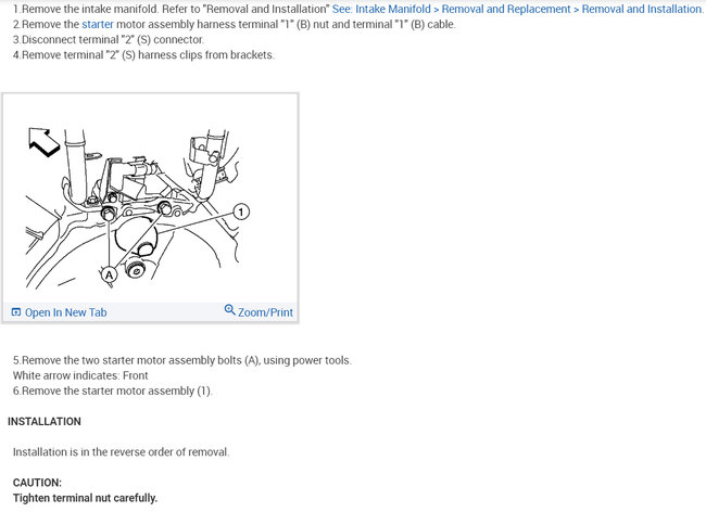

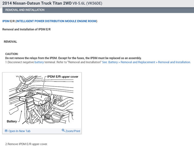

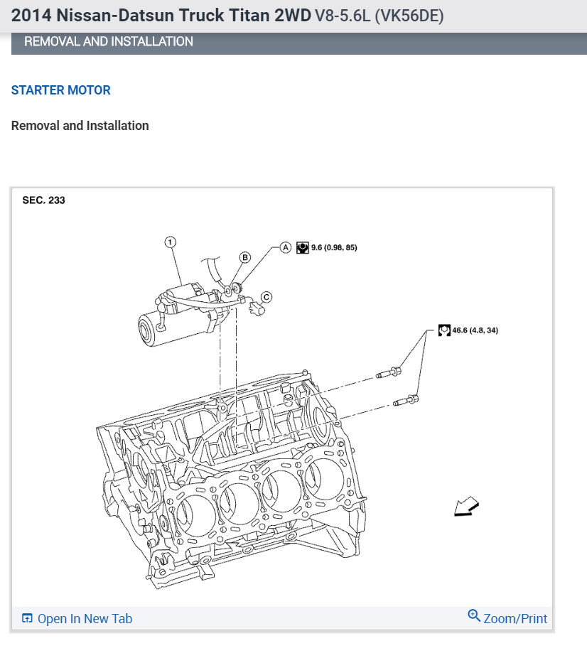

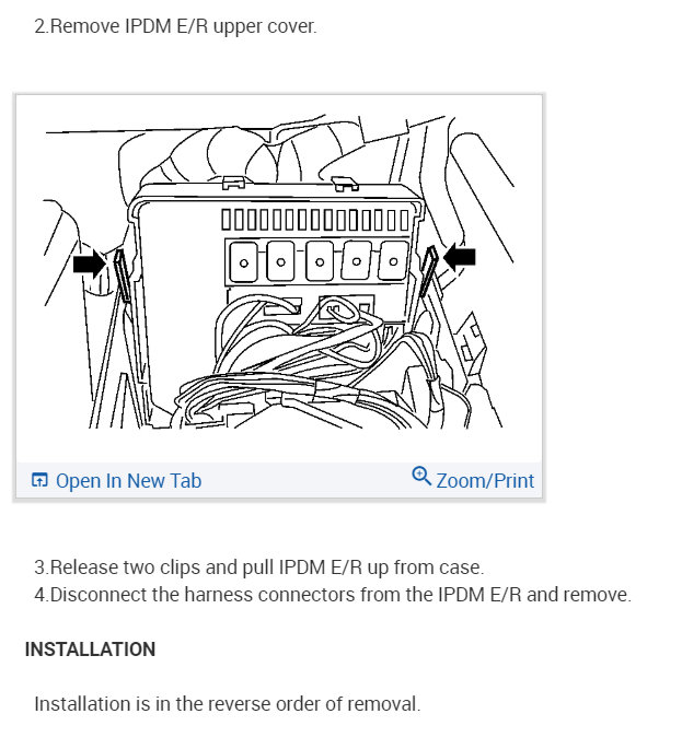

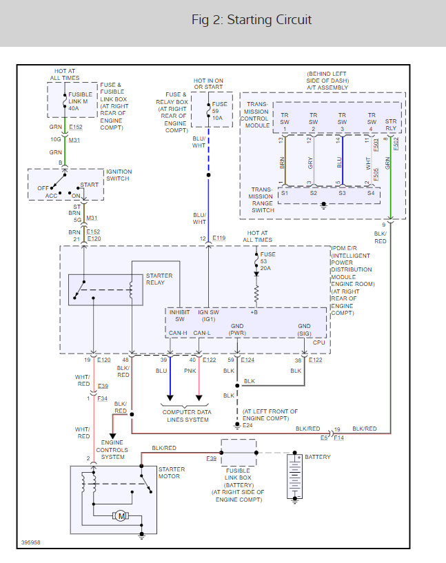

This sounds like the remote start stopped working or the IPDM or starter is out. we need to test for power at the starter solenoid first. here is a guide to help and the starter wiring diagrams so you can see how it works and the IPDM replacement instructions as well:
The starter is in an ouchy :/ place (under the intake) you may be able to jump the relay in the IPDM to get power to the starter.
