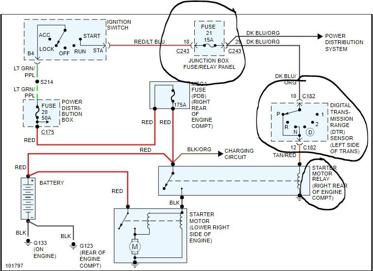

I never had any issues with it cranking/turning over, one day I was about to go somewhere and all of a sudden it would not crank. All I heard was a click when I turned the key. The click sounded like it was coming from the starter solenoid, so I had the starter solenoid replaced. I had the starter replaced, and I had the crankshaft position sensor replaced, and it still will not crank. Light and everything comes on. Just will not crank. Could it be something electrical? What could it be?

Is the starter now engaging or is that still the issue? Have the battery terminals been cleaned and tightened as well as the main ground to the engine block?
If the starter won't engage, then we need to confirm there is power to the S terminal on the starter solenoid. Follow the directions in this link and let me know what you find.
If the starter is working but the engine won't start, take a look through this link:

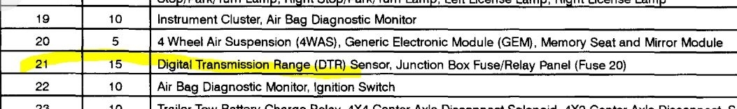

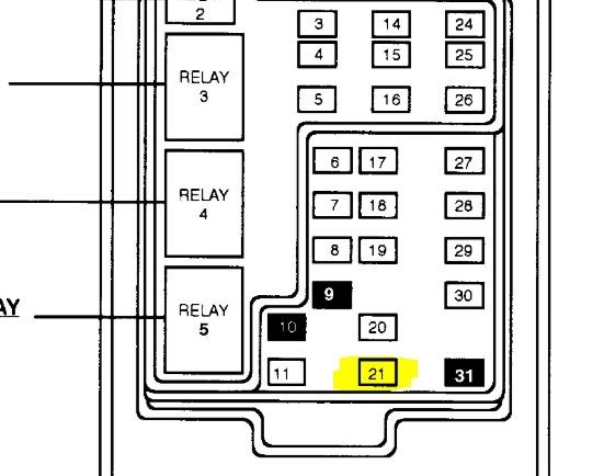

If you haven't already, check fuse 21 in the fuse / relay panel. Also, pay attention if the gear indicator on the dash is working. If it is, see if it will start in neutral.

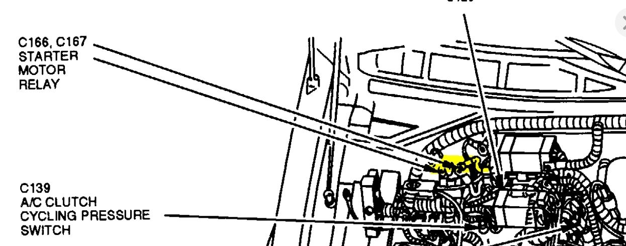

I attached a few pics. The first one is the starting system schematic. The second shows where the starter relay is located. Pics three and four are the fuse I am referring to.
